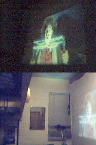

Okay! Well until I buy an LCD panel to do some real DIY stuff, here's my overhead projector/panel setup. I wouldn't post this unless I felt I did some ingenuity. I couldn't get my webcam to go up as high as my loft, so I can't show you what the overhead projector setup is like, but I put a fresnel lens about 4 inches above my LCD panel, and then fed the fresnel'ed image through the normal OHP optics. That was because I only had a 6 foot projection distance in my small closet-like dorm-room. The projector setup is literally right above your heads on the loft as you sit underneath on the couch. It's projecting onto a large bedsheet I've got stretched here, so the image isn't the best. Also, because of the short projection length, it kills my corner focus, and I can only focus on a specific part of the image. Really kinda' sucks, but there's nothing else I can do except make a curved screen to match the radius from my OHP (which I *might* just do)
Anyway, here's one picture (the DVD that's paused is UHF, and it's a picture of Wierd Al getting shocked by "60,000 volts" from Filo's "interocitor". It's a night scene with brights in it too)
Also, I apologize for the picture quality, but it was a free web-cam my dad got for a promo item at some computer convention. Mighta' been a door prize, I dunno'.

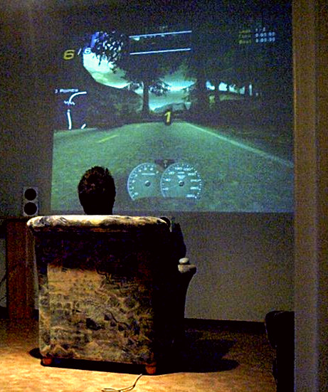

Here is an image of me playing Need for Speed Hot Pursuit II. This is a bit "off-topic" as it has been taken so that the projector was still in it's original shape (with the 120w UHP lamp). It's a fun picture so I thought you might wanna see it anyway, and well, it is a image that can be used for a bit of comparision as it is an image projected with 500 ANSI lumen old commercial Sony LCD-projector in a room where some lights are on. Sorry about the crappy camera...
