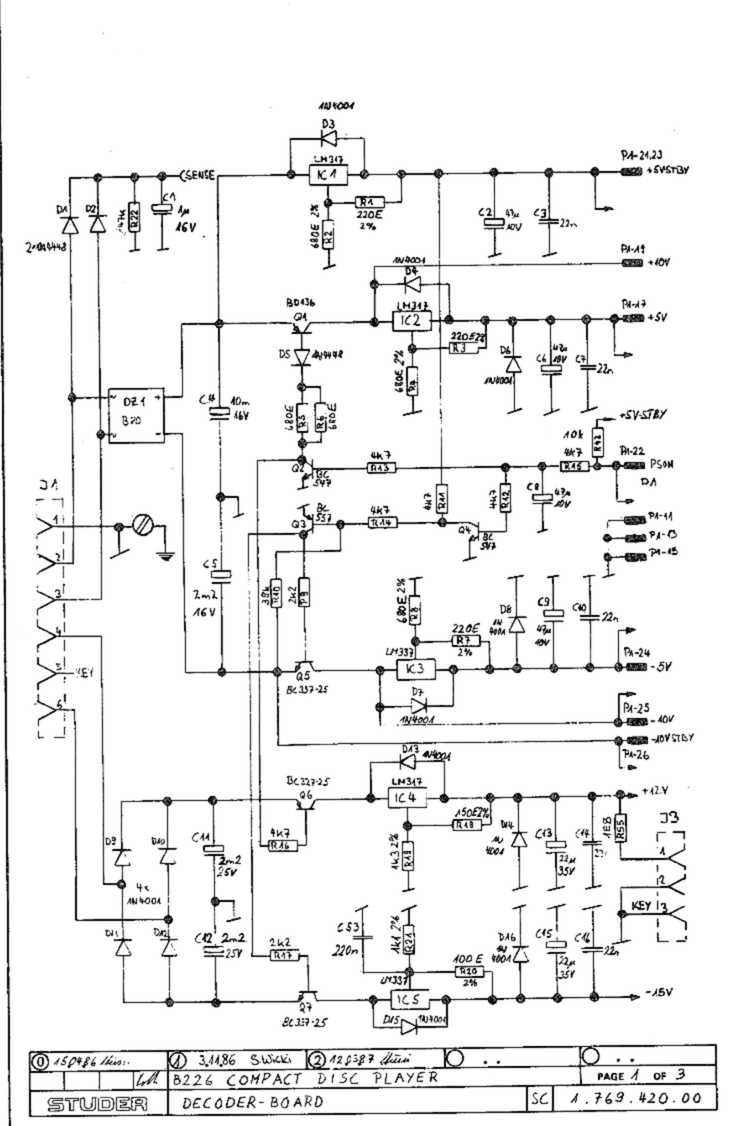

Still recapping my ReVox B226
next caps that are going to be replaced include the post regulator decoupling caps;
Concerning those I've had contradictory advice... replace or leave the old ones? Brand new low ESR caps would perform bad in that position? I'm confused.
The old caps are Frako, they are 30 years old, it seems to me logical to replace them. But the circuit itself has been conceived 30 years ago, and the regulator chips are from stone age. so there might be some truth in the assumption that high ESR caps would perform better, for what reason I don't know.
So, leave the old, dried out caps? Change for good caps? Change for brand new, low quality caps?
(caps are C2, C6, C8, C9, C13, C15)
here's schematics of the B226 PSU.

A capacitor at the output or a regulator interacts directly with the regulator output impedance, which is likely to be inductive and possibly resistively negative too in some frequency regions. A cap with sufficiently high ESR will damp any problems.
If you must change the caps (and this is probably unnecessary) then change like for like. If the cap was an ordinary cheap electrolytic then replace with an ordinary cheap electrolytic.
As I always say, in order to improve a circuit you need to understand it even better than the original designer.

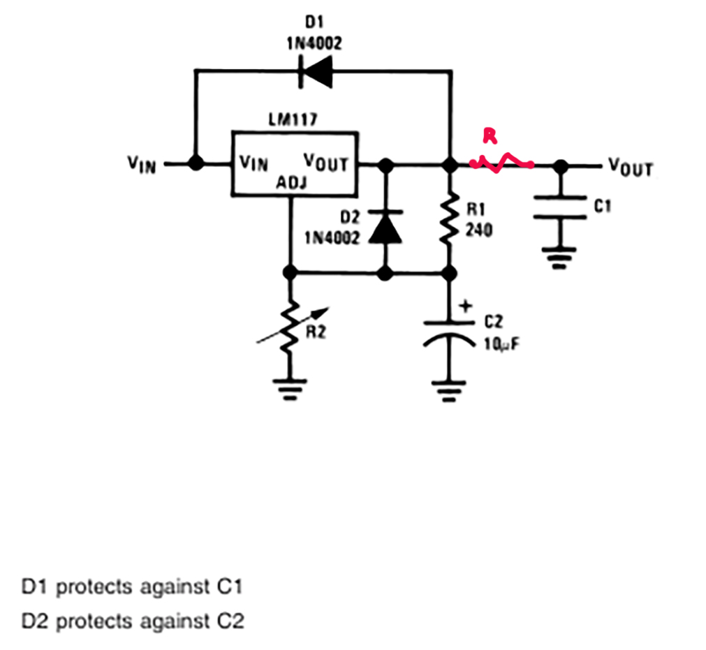

Output capacitor in the LM317
Beware of capacitor with low ESR.
But my experience is easy to solve the problem
At the out leg of the LM317 add low-value resistors 0.47 to 1 ohm
Then the output capacitor can be valued at up to 1000UF .
That way you solve the problem of modern capacitors with low ESR.
Just dont forget to add a protection diode -if the output capacitor are big value
220-1000uf

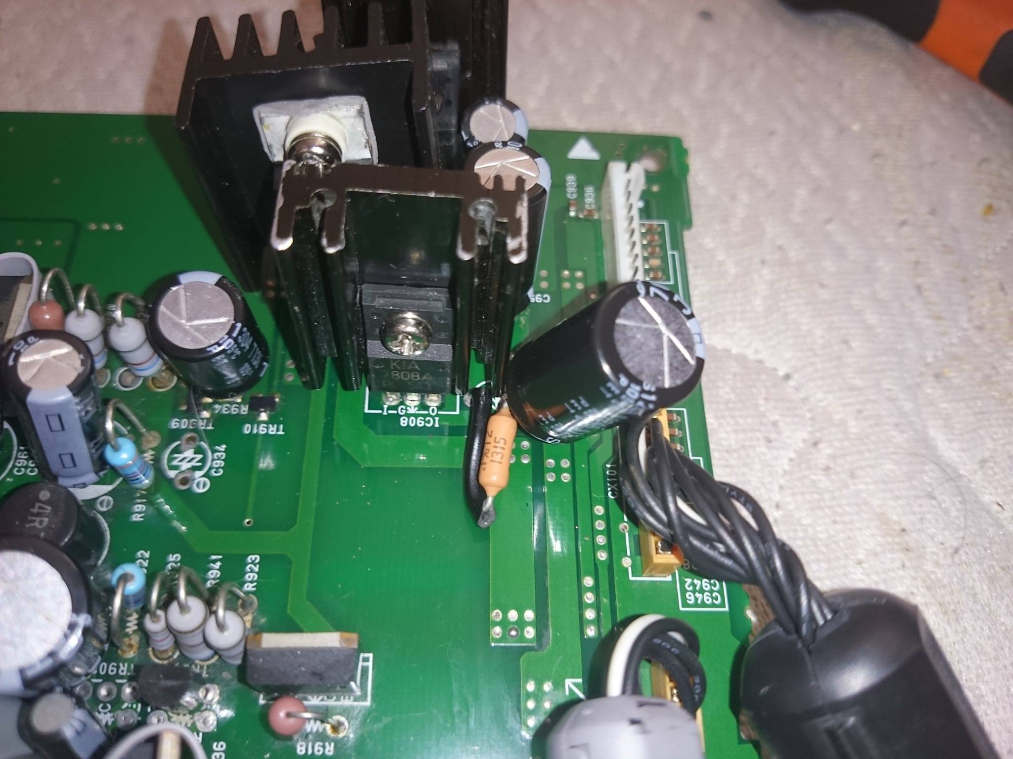

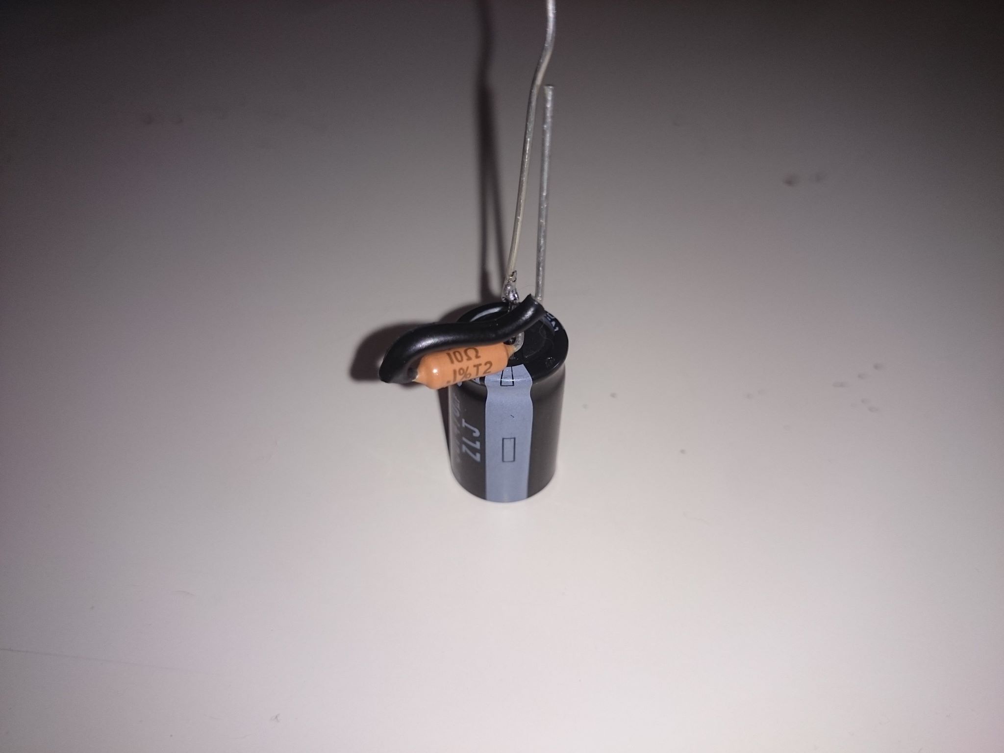

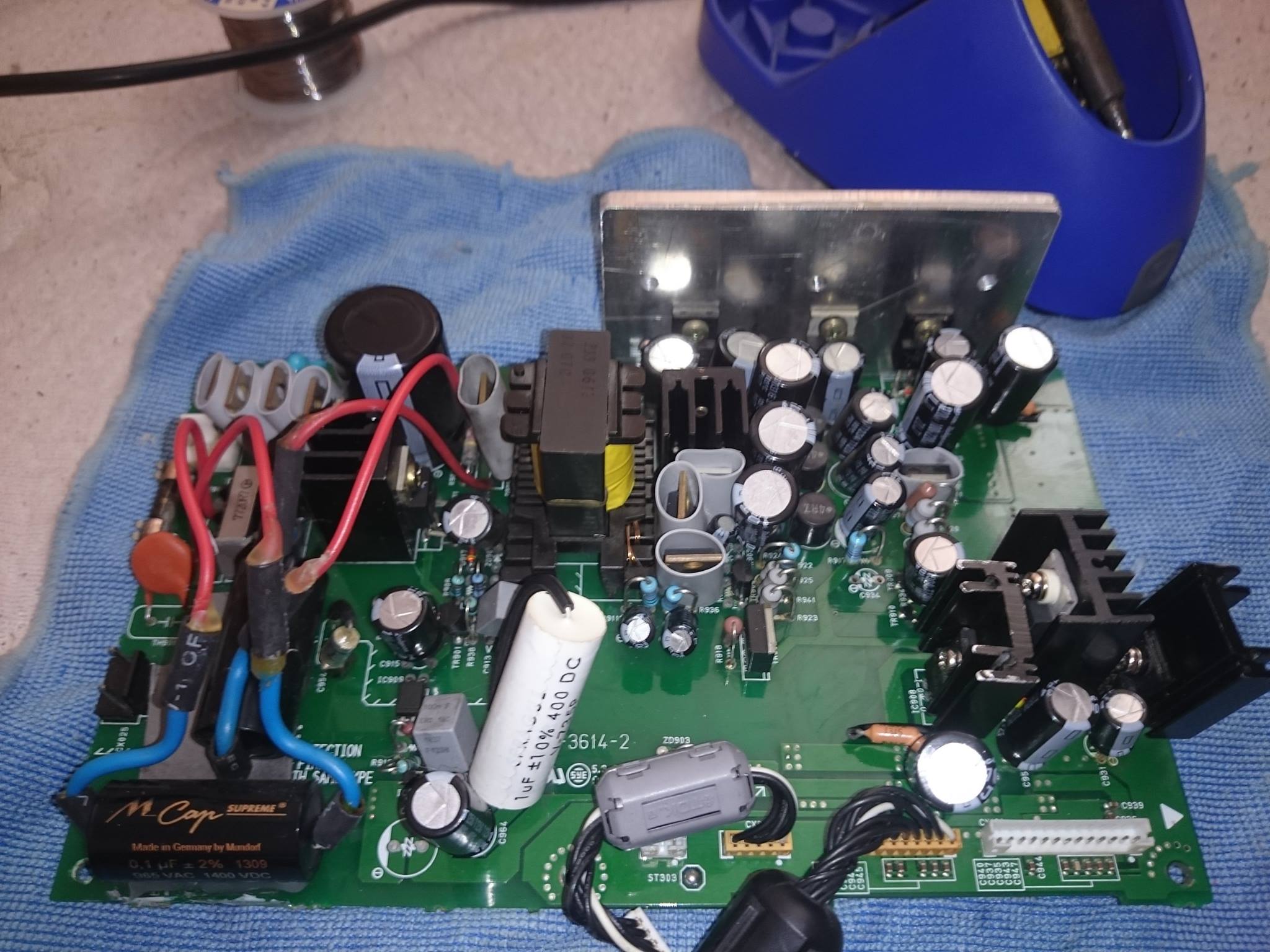

i use low pass filter
resistor 10 ohm 470uf cap low ESR RUBICON ZLK/ZLJ
78xx
79xx
output

Oscillation in really bad cases. A rise in regulator output impedance in milder cases, possibly accompanied by a noise peak. In some cases no problem at all.KanedaK said:What kind of problems can it create?
In some cases it is easier to avoid creating the problem by simply leaving the old cap in place. Rise in ESR is one of the failure mechanisms of an electrolytic, so why replace an old one with a slightly high ESR with a new one plus a resistor? Note that the added resistor should be in series with the cap, not the regulator output; otherwise you degrade the regulation.dazzz said:But my experience is easy to solve the problem

Now I will just re-post the PSU schematics again: if you guys could have a peek for me in there and tell me if ReVox used a circuit that's prone to instability of it's been taken care of (after all, they're ReVox).
Note that I only replaced C2 C6 C8 C9 with silmic II.
I didn't touh C13 and C15 yet. Those are 22uF 10v frako.
