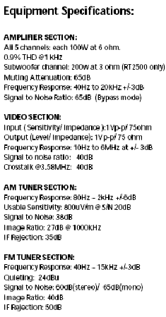

Here are the specs for the RT 2500 system, which I think must be similar to the specs for the RT 2580 system. I really think this is just a normal output, and the only thing inside that stock sub is a little 5" speaker of 3 or 4 ohms impedance. Oh, and there is a little light that goes on at overload-my guess a diode set to light a certain voltage.
I sure hope that 40 Hz as a low cutoff is a misprint.
