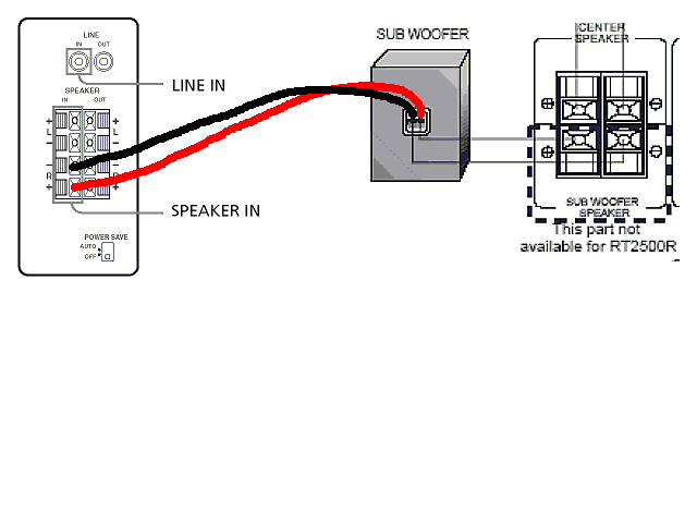

You may have a problem using the Sony sub. Your RCA unit may not be happy driving the input of the Sony sub without the original RCA sub being in place. Also be very careful you get the polarity of the RCA sub out to the Sony sub in correct, if the Sony's input is grounded and you connect the positive RCA sub out to the negative Sony sub in, it would short out the RCA.
Sony sub installation instructions
You could probably leave the RCA sub in place, run another speaker wire from the RCA sub to the Sony sub, turn down the sub level on the RCA and turn up the level on the Sony. Hopefully the RCA would be happy with the load, the RCA sub would not distort, and the Sony would do what you are looking for.

net-david said:RobAche,
--David
Thanks to all for the input.
This post spooked and intrigued me.
You say - To avoid damaging the receiver, I can/should send the signal thru the existing SUB?
So, in effect, I could use BOTH of them?
In other words, use the passive sub first and send the signal thru it to the powered sub, which generates it's own volume, right?
Will this work? - and thusly nearly double my sub output?
NOTE: My current sub has NO level adjustment other than +/- decibel settings.
And, if not, how the heck do I know it's correctly connected in contrast to the RCA?
Please forgive me for being dumb about this: that's why I'm here!
Also - should I sit the new sub on a board as opposed to carpet? Or does it even matter?

Dual (dueling?) subs
Rob,
I think you could use both subs, although you may not get (or want to get) much out of the original RCA sub. I am supposing the RCA sub has a pair of spring loaded wire clip terminals. You would hook up the RCA as originally intended, then take a length of speaker wire and hook it in parallel at the RCA sub, positive to positive and negative to negative, then run that wire over to one of the inputs on the Sony sub, pick the right or the left. My reasoning for that is some amplifiers are not stable unless they see a load, in this case the RCA sub. The Sony sub's input would not provide the low impedance load that a passive speaker would. Turning the level down on the RCA would help prevent the RCA sub from distorting, and then compensate by turning up the level on the Sony.
--David
Rob,
--David

Re: Dual (dueling?) subs
David,
I cain't turn the level down on individual speakers.
I CAN adjust the decibel level on speakers though but I don't know what good that it does.
I am seeking an answer to this riddle as you read this...
But IF I ran the Sony sub thru the RCA sub - it would be at FULL THROTTLE.
net-david said:Turning the level down on the RCA would help prevent the RCA sub from distorting, and then compensate by turning up the level on the Sony.
--David

Levels
Rob,
Doesn't the RCA receiver have some way of adjusting the level of the individual speakers?
My advice would be to turn the sub level all the way down on the RCA, crank up the Sony wide open and then adjust the RCA up until you get a nice balance and/or the desired amount of inanimate object animation 😎
If you can get down to 30Hz or so that should add the impact you are looking for in most movies.
--David

If that is a "volume" adjustment, then yes, they are adjustable.
But man oh man, I don't know what I'm doing.
So, you could run the RCA sub at it's regular level - same as before and send the signal to the Sony sub - and crank the Sony sub?
Is this so?

Actually, turn down the RCA sub so that it doesn't overload, then turn up the Sony until you are satisfied.
You may not need the RCA sub in place. I just wanted to point out that you might. Some amplifiers just aren't happy without their expected load in place.

With all due respect, folks, I am getting lost here.
First, I have never heard of any amp that runs into trouble when you run it into high impedance. The trouble with amps is when you run it into low impedance. Remember those receivers made in the seventies that blew when you hooked up a second pair of speakers to them, or when you tried to run 4 ohm speakers instead of 8 ohm speakers? Well, they blew because the second pair of speakers lowered the impedance down to 4 ohm, and the seventies receivers could not handle it. On the other hand, if you hooked the speakers up in series, the impedance got raised and everything was hunky-dory.
Low impedance=tough load
High impedance=easy load
Sony amp has nice, high impedance waiting for Rob's sub outputs.

I do not wish to appear brusque, but that Sony sub was designed to hook up to just about any commercial AV system, and the RCA is not exactly an exotic setup. All these manufacturers use the same chips inside anyway.
Second, I do believe that just about all mass-fi AV receivers, (sorry Rob) are made from chips, and chips do not use the ground from the wall as the ground in the amp. Electronics folks please correct me if I am wrong, but every time I touch the ground of a receiver's speaker output I see no connection to the ground of the wall AC.
I do believe the large receivers of Fisher that appeared in the early sixties used the ground from the wall as the speaker ground, but we are talking decades in the past.
Inside the bandpass subwoofer of Rob's stock setup is a 5 inch toy woofer, because that is the only way Sony could give an AV surround sound setup at such a good price. Once he gets a good, decent subwoofer, I suggest he put the little popgun away somewhere.
Rob:
Does your receiver have a SUB OUT Jack as well as the SUB OUT speaker wires? I mean the one like to the SUB OUT jack in the lower left hand corner of the illustration, similar to the kind of output one would see on a single channel output of a CD player or cassette deck?
