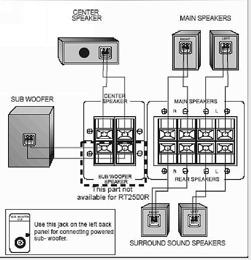

Thanks for the reply!
The little sub that couldn't has no power supply or amp that I can tell.
There are no adjustment knobs of any kind on it.
However, it DOES have a red light that flickers when it is maxing out.
It is sealed tighter than a drum - no screws.
I inspected the "hole" with my finger and felt no cone ~ it was a soft, spongy material.
I was really hoping my projection idea would work.
I tried it with a cardboard box and it seemed to help get the sound up into the room.
I could save my pennies and buy a sub y'all would recommend that would work with my present system.
But they is danged expensive and I'm not to technically proficient, if you know what I mean.
I'm all ears!

Thanks for the specs, they helped, but do you have the model number?
1) Let me get this 100 percent clear-there is no speaker mounted on the outside of the box. There is just a hole in the solid box. Is this correct?
2) No amp of any kind-so there is no wire going from the sub to the wall outlet?
3) Quick measurement-what are the outside dimensions of your sub?
4) A box with an outer box around it to project sound into the room MIGHT work. It will probably emphasize some notes at the expense of others-which we are trying to avoid-but it might get around the "sofa absorption" situation. You said you only wanted more punch for The Governor-I mean The Terminator-right?
5) I do believe that excellent improvement in your bass can be achieved with a seprate speaker/box combo that need not be over $100 to build. First, I need to know more about how your present speaker is powered. For this, I would need to know the model number. Also, how long ago did you buy this?
6) I believe whatever powering system RCA has for this subwoofer will be transferable to any normal subwoofer speakers on the market. The people on this forum, including myself, can provide you with box dimensions to make a superior speaker/box combo that will yield far deeper, louder bass.
7) Beware thay you might have to take apart your present day subwoofer if there is an amp insided that you want to power your new speaker/box combo. Perhaps your sub is powered by the AV receiver, in which case you would not have to take the old sub apart. We will determine which is which before we tell you to buy anything start the project.
8) If you want to buy a new sub amp to hook up to the AV receiver, they go for $100-$200. However, since your present sub is already getting 100 watts of power already, I would just use the amp in your old speaker to save money. 🙂
PS: If your subwoofer has a model number separate from the model number of the whole unit, please give me that number too.
the model number of the system and the model number of the subwoofer itself will be very helpful.

Rob:
I checked out the instruction book of the slightly different model, the RT 2500, which i think might be similar.
You said the cable to the subwoofer was somewhat different.
From the picture below, assuming that is similar to your receiver, is your hookup to the subwoofer from the receiver involve two wires or one?
In other words, does the back of your subwoofer have cable clips similar to the other speakers?
Or is there just one big cable, entirely different from the other speaker hookups, as illustrated in the lower left corner of the graphic?
I hope you don't mind my asking so many questions, but I want to be certain what we are dealing with here.

Rob:

Hello you wonderfully helpful people!
I was off yesterday but over the weekend I did some experimentation and also went on a sub safari.
First - to answer the previous questions:
My little sub only has cable clips on the back and I "think" the amp is the same way. The wiring for the sub is two wires and I think what made them "special" is that they were shielded or something.
Second - Out of sheer desperation, I built my "SUB SHOOTER" box Saturday. It was 14" high, 22'' wide, 22'' deep, and had a 2'' enclosed bottom. I used wood glue, screws, caulking and then painted it mat black.
Did it work?
Yes - it actually made an eyebrow-lifting difference - but it was boomy (as you said it would be), and the dang speaker still distorts anyway. - But all in all, it DID make the bass fuller in the room.
Am I happy?
Hardly.
Am I a goober?
Quite possibly.
SO, Saturday, on the ruse of "Christmas shopping", I took my wife to Best Buy. And there I found the following affordable ($200) powered sub that my wife will agree on buying because she knows I am obsessive and will bother her to no end until I scratch this itch:

QUESTIONS:
My current passive sub (although the specs call it a "powered" sub?) is 130 watts and much smaller in stature with probably a 6 or 7'''' speaker. (I measure the box - it was 9'' x 9'' x 14'').
The Sony sub mentioned above is only 20 watts more but it has a 12'' speaker (driver?) , a much larger box (speaker?), a powered amp and adjustment knobs on back.
I listened to it at the store and it seemed to be substantially better...
SO -
1. IS it better - explosion / furniture shaking wise???
2. Would it be a big satisfying leap or just a hop from what I have?
3. Will this be compatible with my RCA system?
4. Is it worth the $200 for a non-speaker builder to make due?
Thanks for the input - I REALLY appreciate the help!
