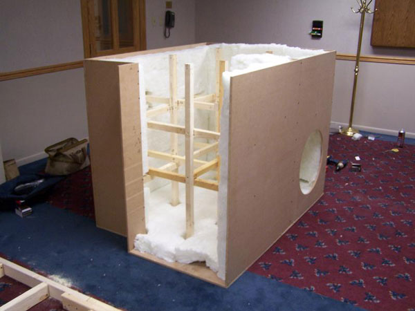

Go with a tapped horn design and this will be the result, except that the driver will be in the mouth of the "horn" so it will be completely protected if a grille is added to the mouth.Wouldn't mounting the drivers with the magnets on the outside of the cabinet (with a cage to protect them) solve the heat problem?

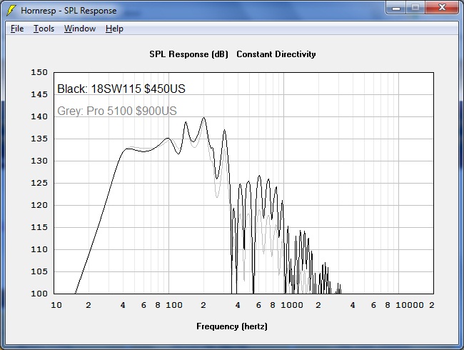

That is what i also would do, and this is a design that could work for you that is tested and designed here: https://www.diyaudio.com/community/threads/th-18-flat-to-35hz-xoc1s-design.190635/
A single XOC1 TH18 using the B&C 18SW115-4 could achieve more SPL than the pair of the OP's Mackie subs, but would hardly go any deeper, it's response rolls off ~24dB per octave below 40Hz:this is a design that could work for you that is tested and designed here

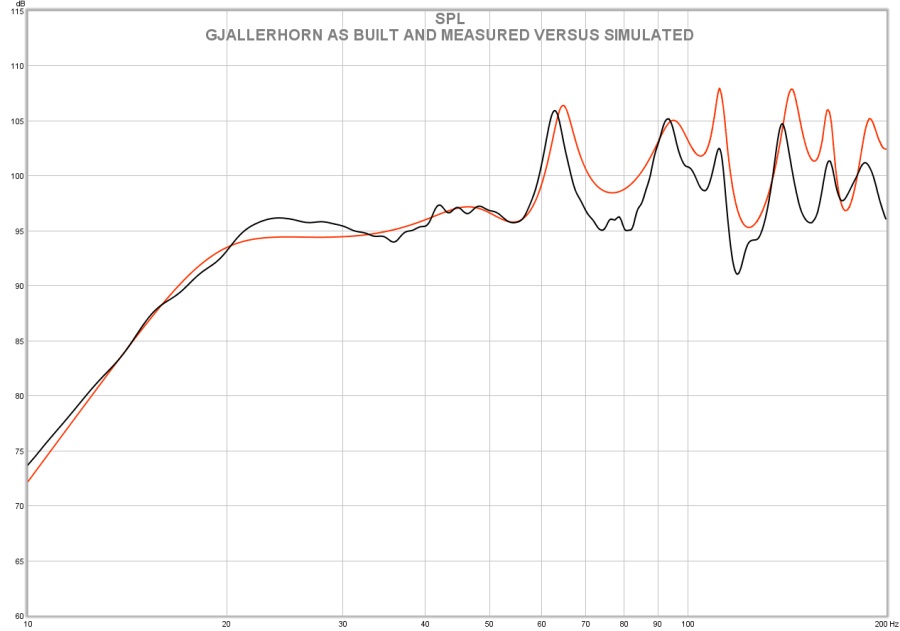

If the octave below 40Hz is desired, a TH like Josh Ricci's Gjallerhorn would be a more useful choice.
That said, for output density (cabinets per truck space) ported cabinets still have an output advantage in the 20Hz range, as can be seen in Josh's comparative measurements in post #7.

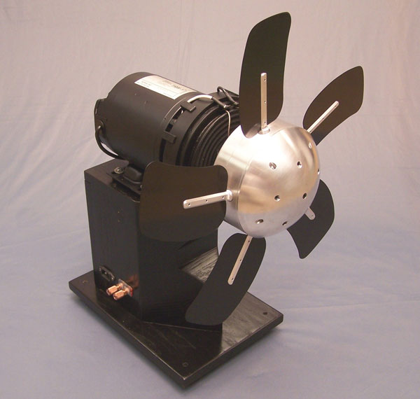

Just pondering, what about those fan style subs could they be souped up to cater for such low bass at high spl?

If you're talking about something like the Eminent rotary subwoofer, those typically require a very large enclosure, which is at odds with the original poster's wishes.fan style subs
www.soundandvision.com/content/eminent-technology-trw-17-rotary-subwoofer
"it requires a manifold chamber in front of the unit to absorb the random noise of the blades rotating. In the photo above, a manifold is being built for a trade-show demo; the blades will be positioned in the circular cutout.
Because the effective radiating area is so large, the TRW-17 also requires a huge backwave chamber, which is typically an entire room, attic, or basement."
