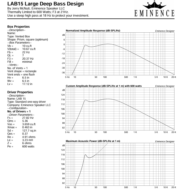

If you just want more extension in about the same volume as you have currently, that can be had with something like the Eminence LAB15, but according to the sheet below it may have less output (assuming Mackie's claim of "Maximum SPL Peak 133 dB" is equivalently measured, which I'm unsure of).
www.parts-express.com/Eminence-LAB-15-15-Pro-Subwoofer-290-575?quantity=1
www.parts-express.com/pedocs/more-info/290-575--eminence-lab-15-cabinet-design.pdf

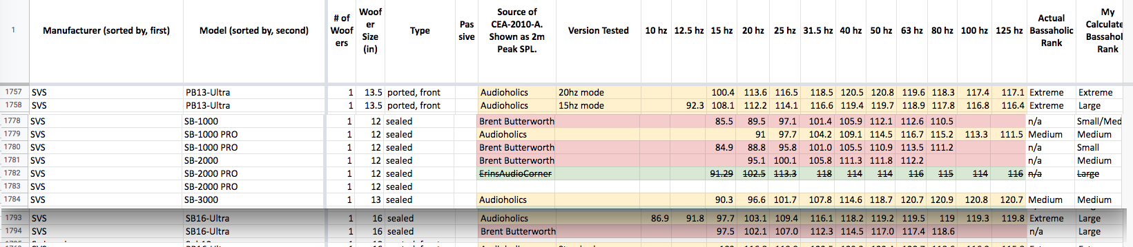

You might find it interesting that a single SVS SB-1000 Pro hits 97dB SPL@20Hz 1m:The music we play doesn't have a ton of content below 40 Hz, but a lot of tracks do sound better on a system that can play lower. One of our DJs recently bought an SVS SB-1000 Pro for his home setup; I set its crossover in the 40s (matching the natural roll-off in his main speakers), added a few dB in the low-20s, and kept the sub's volume moderate, and we all loved what that did for the sound. It'd be nice if we could bring a similar touch to our events.
The Mackie SR18S has ~-35dB less output at 20Hz than at 40Hz, so if we assumed it could peak at 133 dB at 40Hz (probably 3 to 6dB optimistic..), it's 20Hz output would be at best +1dB more than the SVS SB-1000 Pro.
I'd bet the single SB-1000Pro would be closer to the output of two SR18S at 20Hz.
Note that the 7.8 cubic foot SVS PB13-Ultra, similar size to the Mackie SR18S, has ~+22.6dB more output at 20Hz than the SB-1000Pro .
To put that in perspective, around thirteen (+22.3dB) SR18S would be required to equal the 20Hz response of a single PB13.However, if I'm getting an accurate sense from the sheer insanity of the numbers you guys have calculated, that extra wiggle room would at best move the original idea from preposterous to merely infeasible. Time for a rethink!

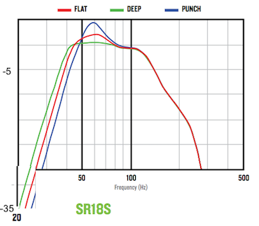

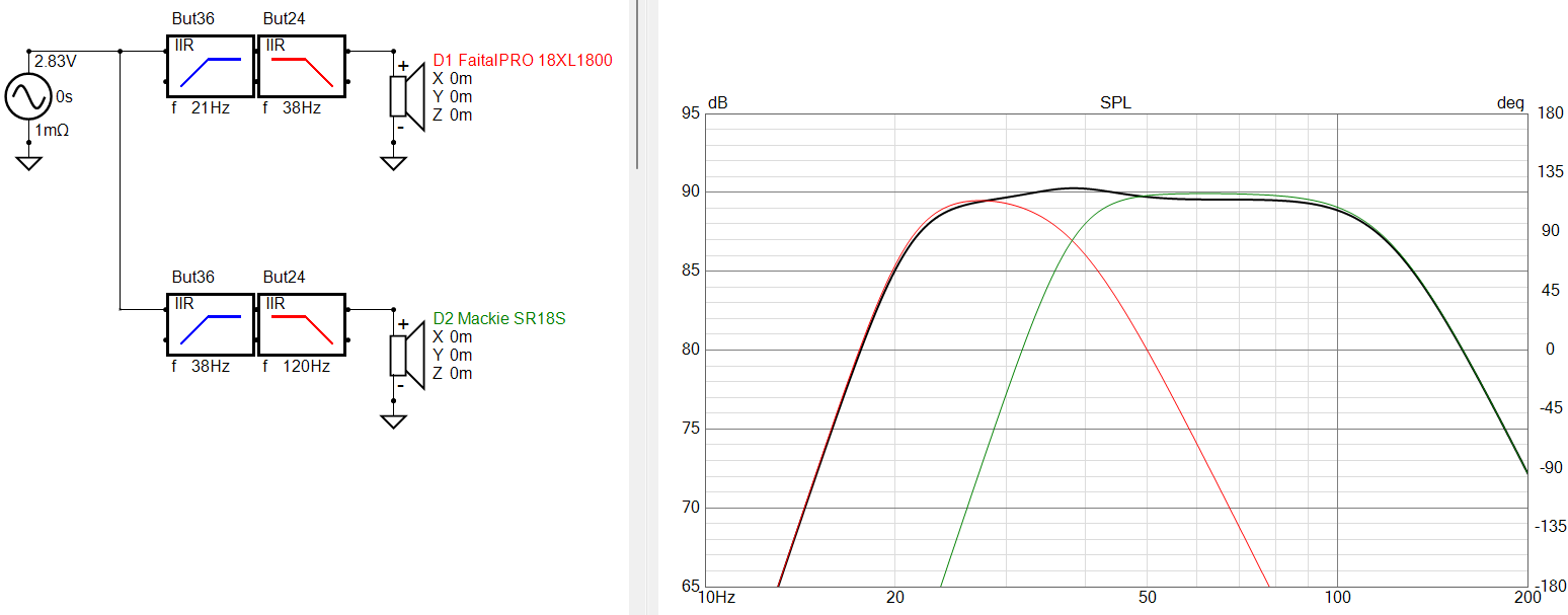

The specifications for the Mackie SR18S includes a frequency response curve. This seems to show that the system in "Flat" mode has a −3dB point of around 38Hz, being around −1.5dB at 40Hz. That's quite a respectable level of performance, and handles the lowest note on a 4-string bass guitar with high fidelity (no significant attenuation).Right now we're using a pair of Mackie SR18Ss. They are roughly 2' x 2' x 2' each and give us enough overall output. However, as with most PA subs, nobody's home below 40 Hz without DSP.
However, below 38Hz we have a very steep roll-off in the low frequencies. This looks like it's a 6th-order rolloff, which implies that this is a 6th-order filter-assisted vented box low-frequency alignment. Hence the compact enclosure size.
That's a very, very big ask, as the implied assumption is PA-type levels. Keep in mind that for 1x 18-inch driver in an infinite baffle or sealed enclosure, it takes an Xmax of about 26mm to produce 130dB SPL @ 1m at a 64Hz, which is 2/3 of an octave higher than 40Hz. That's a great deal of excursion.I'd love it if we could go down below 20 Hz with little or no DSP/EQ,
Keeping that excursion level constant, with 26mm of excursion and 1x 18-inch driver, by 20Hz we would be producing only 110dB SPL @ 1m. That's 20dB less!
The physics of the situation controls the possible design solutions. Getting a −3dB point of around 20Hz is possible, but it generally requires some quite large enclosures....there's nothing off-the-shelf in pro audio that plays anywhere near that low unless it's several times the size, and we can't (yet) tote around something that big.
The gross enclosure volume of the Mackie SR18S enclosure is 237litres, and the net volume might be around 180–200litres. That's moderately large for a vented enclosure and so should potentially provide some scope for a more extended frequency response in a similarly-sized enclosure using a suitable driver.

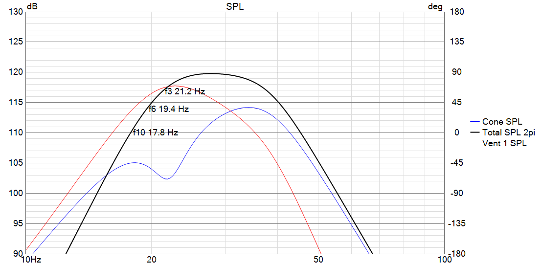

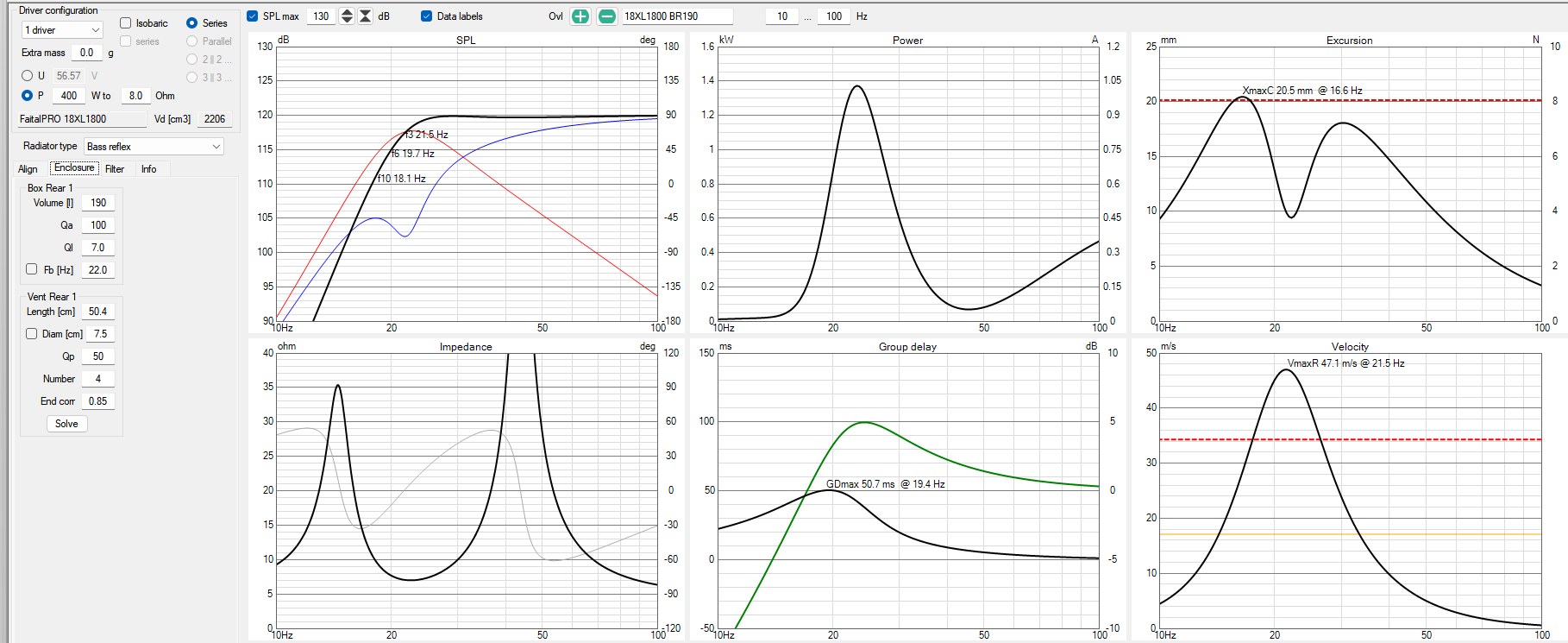

Looking at a FaitalPRO 18XL1800 in a 190-liter enclosure, we can get the following results. Note that this is a filter-assisted alignment, which protects the driver below the enclosure's cutoff frequency (a necessity in my view). The filter is a 2nd-order high-pass peaking filter set to 22Hz and Q=1.70, giving about +5dB of boost. With 400W re 8ohms of input power, we reach 120dB SPL, and the peak power required is about 1,400W at 22Hz (due to the peaking equalization), and is about the maximum that this driver can absorb.Let's pretend I have access to all the amplification I need. Sky's the limit there. Given that, could I conceivably build a sub not much larger than 2' x 2' x 2' with relatively flat frequency response from like 18-100 Hz without DSP and as much SPL capability as one of our Mackies?
If we add a 6th-order Butterworth low-pass filter set to 38Hz to the above response, we get the following result. A pair of such infra-subwoofers could then be added to the existing pair of Mackie SR18S enclosures to boost their bottom end. Although you have 4 enclosures instead of two, you do have almost an octave more low-frequency extension. If the infra-subwoofers have problems, the main subwoofers will still carry on.

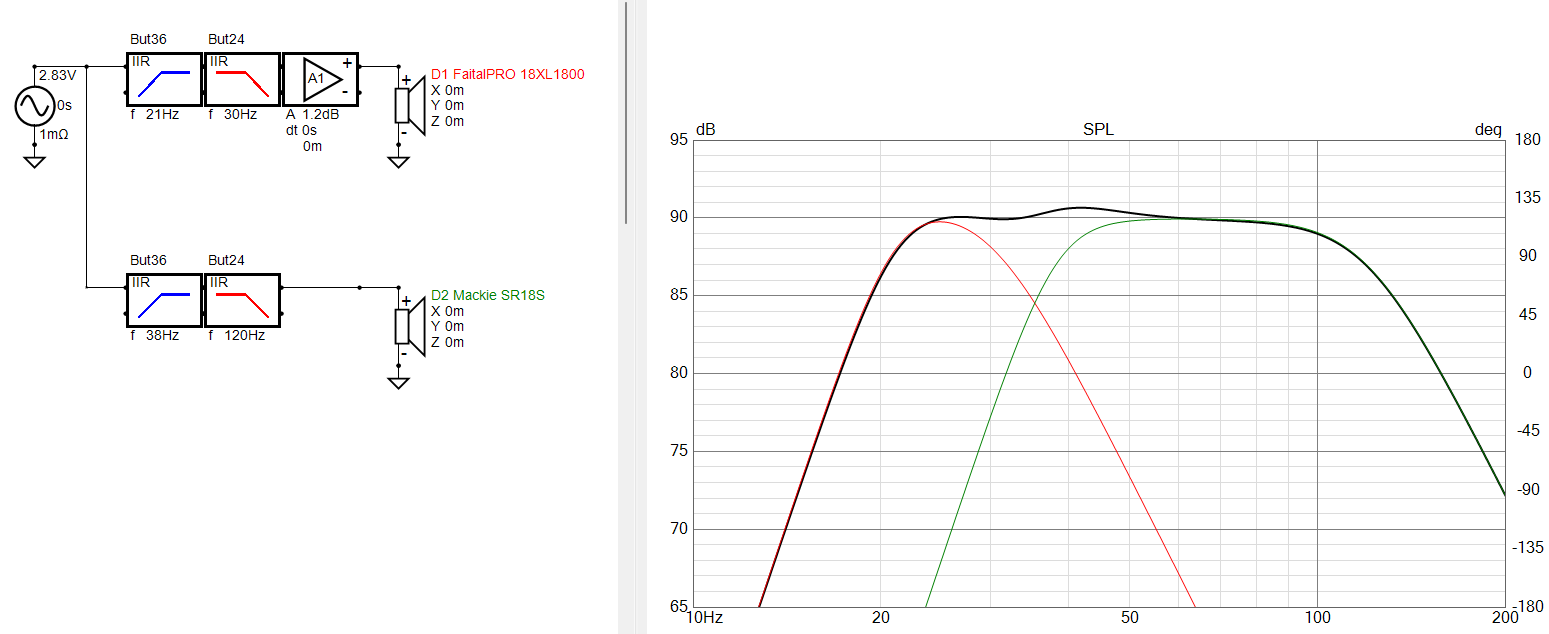

Below is a simulation of what can be achieved by combining the infra-subwoofer with the subwoofer. Both are connected with positive polarity, which produces the broad +3dB peak centered on 38Hz. This may be a help or a hindrance, as it will certainly add a bit of bass emphasis to the system, which may need EQing down (but that's easily achieved at the mixing console).

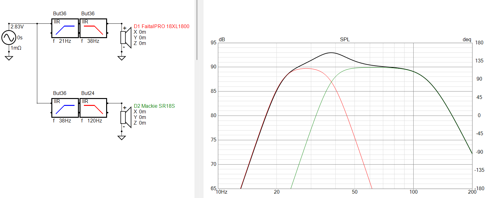

Alternatively, we can switch from a 6th-order to a 4th-order Butterworth low-pass filter on the 18XL1800, and we get a much flatter summed response.
There is a little bit of phase cancellation occurring in the 50–90Hz frequency range, which could be reduced by lowering the cut-off frequency on the 4th-order low-pass filter by a few hertz and adjusting the level on the infra-subwoofer to get a good response. See the example below.
Maxing out driver excursion will of course produce distortion. The high SPLs that are being generated will lead to port chuffing, but that may not be so noticeable amongst the music signal.If so, what should I look for in a driver and enclosure design, and what other downsides should I expect it to have (distortion, transient response etc.), if any?
The 200-litre enclosure size is probably right on the limit for getting reasonably extended bass at reasonable output levels from a single driver. The larger the enclosure the better when playing that particular game.If not, how can I tell how big the enclosure would have to be – again, assuming I can compensate for any lack of efficiency with a boatload of amplification?
For your concept to work in practice, you need a DSP based, dynamic limiter, that prevents the infra (and sub) from getting too much power when their long therm permissable load is reached. These limiters have to be locked, so no DJ or renter in the field can change them. This breed always knows better than the sound man or doesn't care for the gear...
Such a limiter should be set once, through distortion measurements, with the amp that drives them. It is softly cuting the input signal down when some level of distortion is reached. This does not only make them save to handle, but improves sound, too. From some point only the low-mid-high get's louder, the infra stays at a constant level.
Many amps have such a dynamic limiter, even the cheap Behringer D-DSP amps for example. Build in, set once, locked. Very handy. Many active consumer and monitor speaker have such limiter today, which prevents the small woofer from too much excursion, but gives the impression of very deep bass at just a little reduced level.
The down side is that you do not realize when the infra driver is at its limit and may stay there the whole evening. Do not expect even an expensive pro driver to last forever, if permanently driven at x-max. They wear out like any PA driver does, this may just come much sooner. The human ear is quite tollerant to distortion in this low range, so there may no be any audible warning when the drivers are suffering.
So in the end you do not get 130dB at 20 Hz, but an subjectively extended response deep down.
Such a concept will only work if done right, which needs time, experience, some measuring gear and, most important, insight of the owner. Last point often is a problem, when he wants an override option. All this settings have to be done before they are used for the first time...

If you have time & inclination, here's an article I wrote back in 2017 on the subject: https://www.prosoundweb.com/spec-wars-looking-inside-loudspeaker-spl-specifications/
Having spend some time abusing that particular driver, I can say it'll take a Powersoft T602, bridged, all the way up to clipping, without making extraneous mechanical noises. The cone excursion was impressive. Heat build-up will be a concern in the longer-term, though.Looking at a FaitalPRO 18XL1800 in a 190-liter enclosure, we can get the following results. Note that this is a filter-assisted alignment, which protects the driver below the enclosure's cutoff frequency (a necessity in my view). The filter is a 2nd-order high-pass peaking filter set to 22Hz and Q=1.70, giving about +5dB of boost. With 400W re 8ohms of input power, we reach 120dB SPL, and the peak power required is about 1,400W at 22Hz (due to the peaking equalization), and is about the maximum that this driver can absorb.
Yep, I'm still looking for that compact little powerhouse.
I made some loud noises in the back garden the other day. I put the measurement mic at 1m from the nearest part of each cabinet, and then used my old SPL meter to calibrate REW's levels. NB - while online reviews suggest the SPL meter is okay (ie, within a couple of dB of reality), I'd still recommend that the absolute SPL is taken with some degree of uncertainty.
The SPL graphs were measured at 2.83V (according to the Powersoft T602) and then at increasing power levels until the amplifier ran out of headroom. The amp was...

That math is crazy!The Mackie SR18S has ~-35dB less output at 20Hz than at 40Hz, so if we assumed it could peak at 133 dB at 40Hz (probably 3 to 6dB optimistic..), it's 20Hz output would be at best +1dB more than the SVS SB-1000 Pro.
Think about that!
Art
