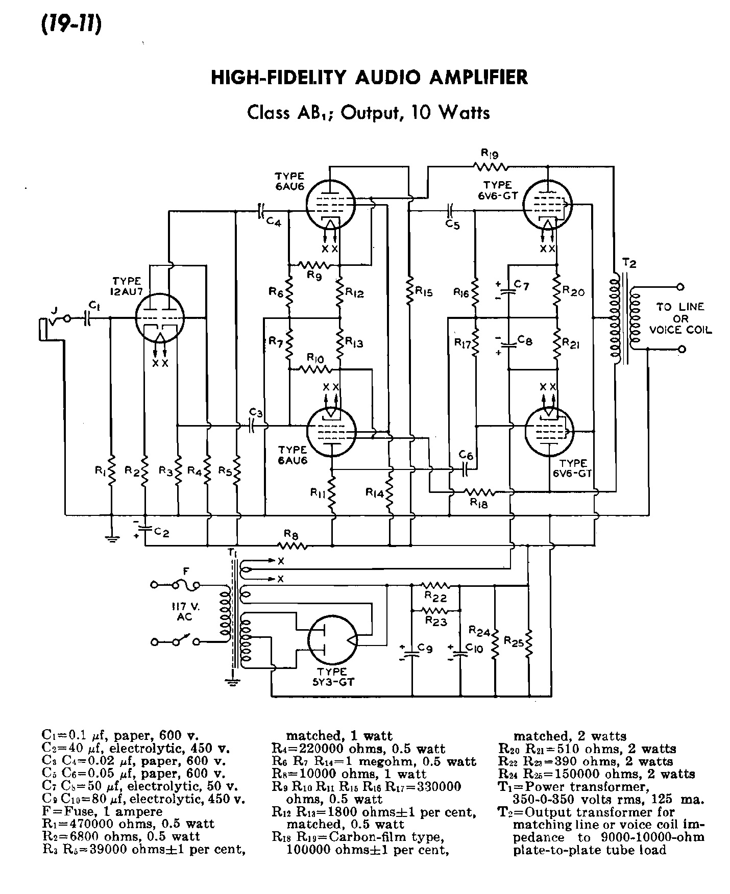

Maybe you were thinking of this one (from the RCA Receiving Tube Manual RC-19 1959).

Hello TonyTecson and all. Thank you all for this enlightening/teaching thread. The author did a great job explaining the schematic of your post and its nuances. My following question may be a stupid one; never asked or yes and humbly expected from a novice like me.
What if feedback is routed from the top output pentode to the bottom phase splitter tube [6AU6]? Ditto for the bottom power pentode to the preceeding upper splitter [6AU6]. Totally instead of that shown; or partially in conjunction with it. Will there be any subjective or objective performance value or worse; a detriment?

I would think that the negative feedback than turns into positive feedback, probably turning the amplifier into an oscillator.
A performance value may emerge from using a balanced extent for each of positive and negative feedback.

I certainly don't know everything about feedback yet so please read the following with that in mind.
There are ofcourse examples of amplifiers in which there is both positive and (more!) negative feedback going on at the same time. Here are two of them:
- 7199:RCA Application Notes
- see pages 23 to 28, 67 to 71 and 85 to 93: http://www.introni.it/pdf/Rodenhuis%20-%20HiFi%20Circuits.pdf
In these cases the combination of positive and negative feedback has a specific purpose, like extending the low end of the frequency response (first example) or to achieve more gain in the preamplifier/inverter (second example).
But in the RCA amplifier in post #43 the mix you suggest would not serve a specific purpose unless you would introduce some form of frequency dependent feedback. But that would come at a price, like a lower damping factor at the low frequencies, etc..
I would think that if you want the amplifier to keep the same gain, than a certain amount of positive feedback has to be compensated by a same amount of negative feedback. The endresult would therefore be zero.

Thank you PFL200 for your clear insights. Your links and those of the members contributing to this thread are a valuable [and living] teaching assignment for me [and others] to learn this new [to me] language of vacuum tube circuits.

Thanks TonyTecson. You and other contributors to this thread [less I] speak from experience and knowledge. I accept your answer and the earlier one like it by PFL200 to be accurate.
Scope pictures of signals I had suggested from/in such amplifiers can augment teaching/understanding it. They are not found in the links describing the amps' works. Detail detail..

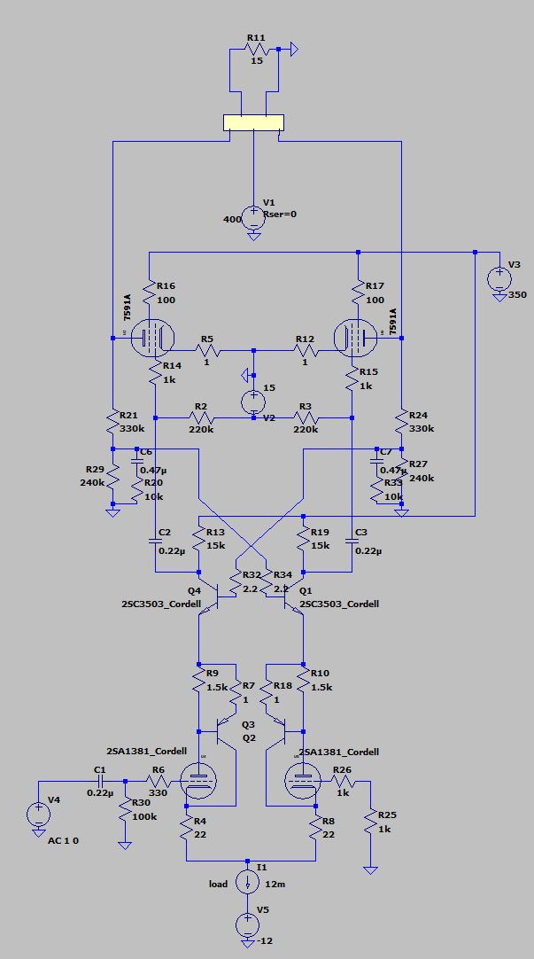

You are using a differential cascode front end with feedback superimposed on the cascode voltage? I'm trying something similar, but with solid state assistance. It's been on the back burner for a while as I've been working on other things, so not actually tested yet. I used an RC network to let me set feedback ratio independently of DC voltage without using separate supplies. Probably will cause stability issues. We shall see....

Hello tikiroo. Thanks for the schematic. You have the power of LTSpice to generate simulated scope signals at the recipient components possibly before and after feedback.

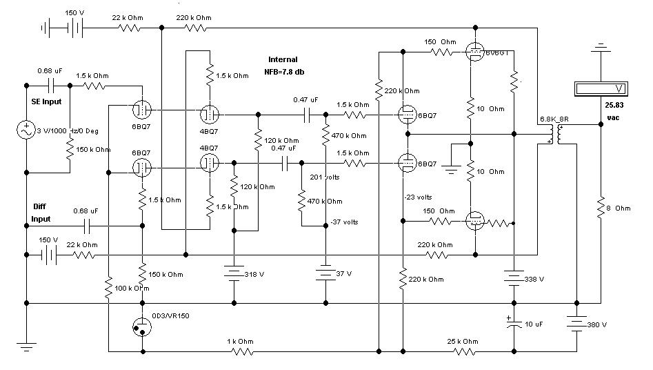

Here is my experimental Class AB2 PP 6V6 amp with internal NFB from circa 2000. I has been on DIY in the past a few times.🙂
Hello jhstewart9. Thanks for the schematic. It projects both of your experience and knowledge. Was there a thread on it for me to follow?
