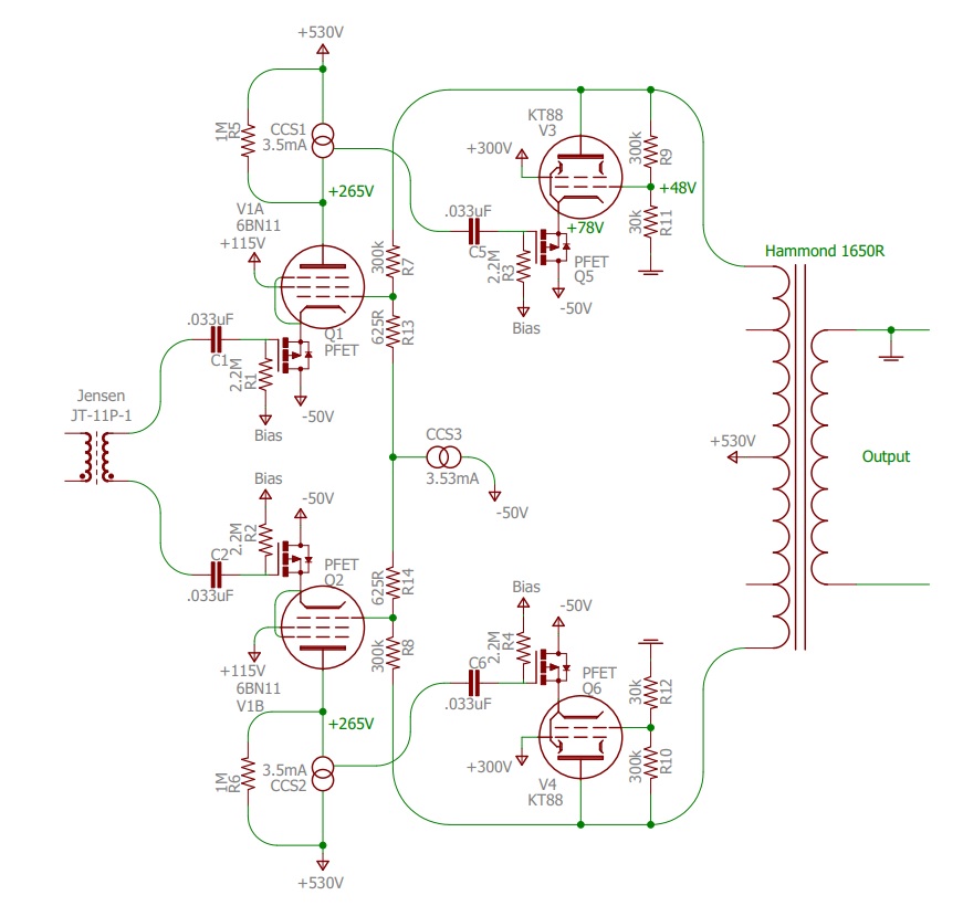

The circuits I have in mind are push pull sweep tubes such as say ECL85, 6LR8 etc. in UL or triode mode with possibly an additional 10 or 20 dB of local feedback.

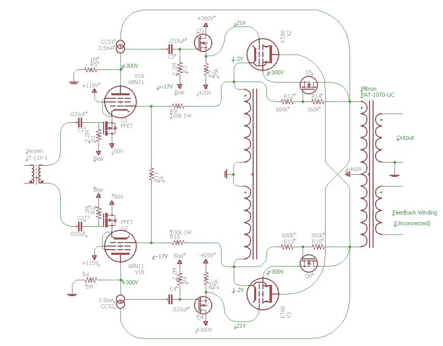

Later versions of this SE amp with an 826 output tube ended up with .027% distortion at 1W on the transformer secondary. I raised the amount of feedback and I estimate the driving impedance on the primary to be under 20 Ohms, just based on the measured Zout on the secondary and the winding resistances. See my Corona amplifier thread for more details.
I don't know what the irreducible distortion in a typical output transformer is, but it appears that it is quite low at midband and normal listening levels. Things are going to fall apart if you try to drive a transformer at LF with levels more than it can handle, but we know this.
To answer your basic question, I think you can make a very nice PP amplifier without any feedback around the output transformer. That's basically what my Plitron Unity-Coupled amplifier is. 50% CFB Push-pull amp, no feedback from the secondary.
I've toyed with applying my Corona SE amp feedback scheme to push-pull amps, but making the feedback kind of like the input stage of an instrumentation amplifier (see attached).

It is 20 Ohms driving impedance on the primary of the output transformer. That means that the amplifier Zout is almost completely dominated by transformer copper resistances. I measured 0.7 Ohms Zout on the 8ohm secondary, so a damping factor of over 10 which is unusually high for an SE amp.
