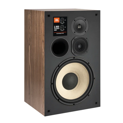

JBL L100 (the orginal) and JBL 4313 certainly also fit the description of the classic ones.
Thanks. I originally included a few 70s classics but removed them because the old types of drivers and loadings like acoustic suspension and aperiodic vents meant they weren't particularly relevant technically to a DIY build today. The classics listed are current speakers. The K&H was discontinued a while back but is technically relevant. However, the aesthetics of 70s speakers may be relevant for some of us and so perhaps I was wrong and a few classics would be useful.

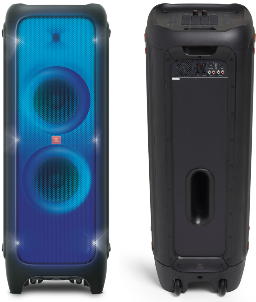

Exhibit A:
JBL Partybox 1000
Dimensions (cm) 39.7 x 39 x 105 =162 L (external); 15.6 x 15.3 x 43.3 in = 6 cu ft (external)
Weight 34.7kg =76.5 lbs
Driver complement: 12" woofer (down firing, ported), 2 x 7" midrange, 1 compression driver
F6- 28Hz
Max SPL before compression limiting:
~99dB <160Hz, 109dB >160Hz
Price = $2,000 a pair

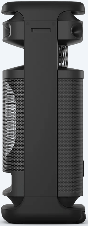

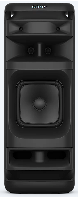

Exhibit B: Sony ULT Tower 10
Dimensions: 41.8 x 42.8 x 110.6 cm= 197 L (external); 16.8 x 16.5 x 43.5 in =7 cu ft (external)
Driver complement: 12.5" woofer (square), 3.5" midrange x 2 (L/R), 1.5" tweeter x2 (L/R), 1.5" rear tweeter x2
I have heard these speakers, and I must say, I was impressed. Sure, US $2000/pair today for the average young person is a high price.
But that is about US$250 in 1970 money... and about how much the JBL 100 was in 1970 ($273)

The concept of big 3 way speakers never went away.
I believe the science has continues to better understood, the manufacturing has been streamlined (mass production) and using newer technologies (formed & reinforced plastics for increased internal volume to external volume ratio, easy cabinet / waveguide shape optimisation, built in equalisation, amplification, wireless audio)
They live on in modern equivalent as the the "Partybox"
Exhibit A:
JBL Partybox 1000
F6- 28Hz
Sound:

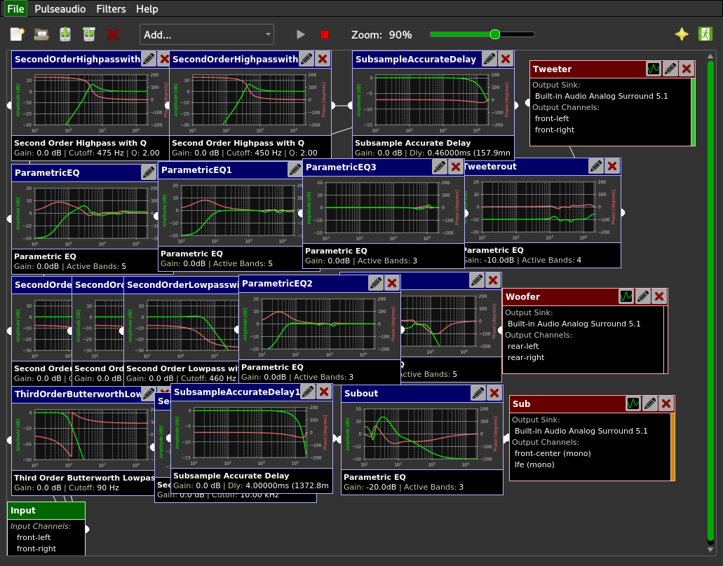

The task was to quantify the advantage of a DSP crossovers like this to control radiation patterns in comparison with what can be achieved with practical passive crossovers. Supporting both analogue and digital crossovers within the same project will hopefully enable other differences to be quantified in a way that is useful for DIYers.
edit: changed my mind. I'd probably want to see the modular element.
Very wise. Getting it right in the sense of adding flexibility and improving the technical performance of the cabinet may be a challenge. Implementation so that it is reliable will also have it's challenges. Nonetheless there is experience around with what has and has not worked well with removable baffles to draw on.
