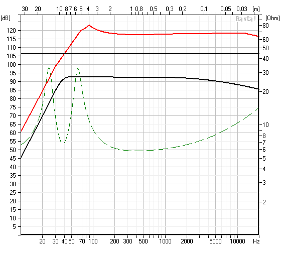

This is what 120 Euro in 70l box can do. Pretty monkey coffin behavior. Red line is SPLmax.
