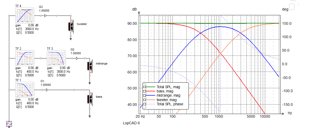

Regarding old school 3-ways, the mid was called a filler. Optimal acoustic LR2 xo around 500 and 3000Hz has all drivers in same phase angle in midrange (mid driver in inverted polarity). This also makes horizontal and vertical directivity smoother without sharp suckouts. This with low distortion sums up to very pleasant and "natural" sound IMO. Smart combination of drivers and baffle dimensions are needed for success. Sadly, poor crossovers and no baffle step compensation was the problem with most old 3-ways.
Most 3" domes and some 4" cones in best scenario can use very simple electric crossovers with resonance/impedance correction. Also the woofer should not have cone resonance problems.
So, I suggest that acoustic LR2 is added in design principles!
