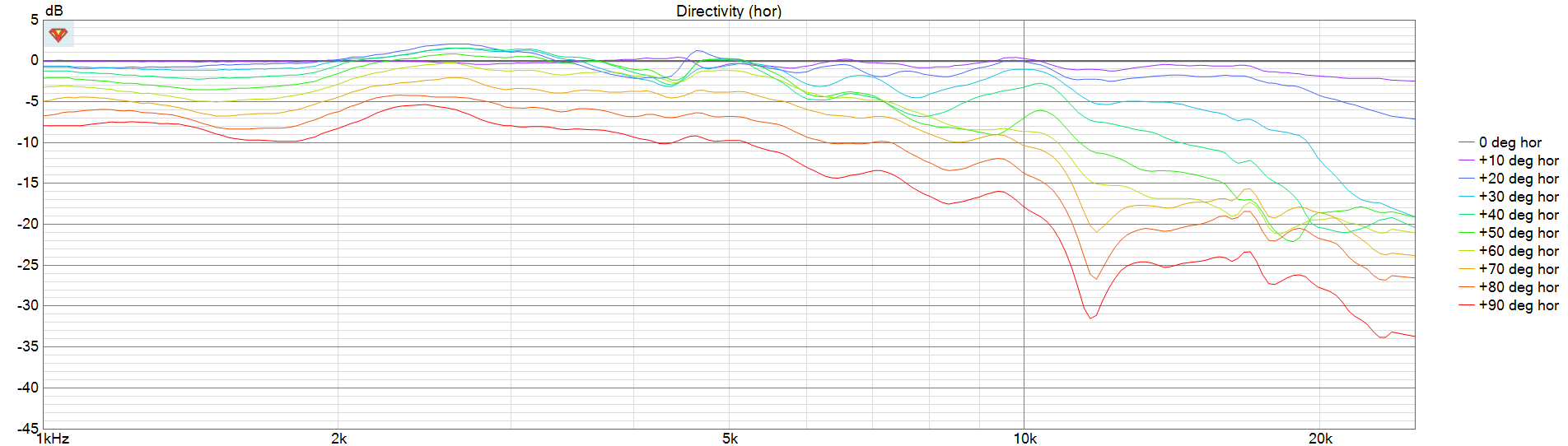

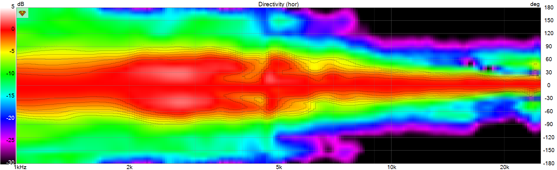

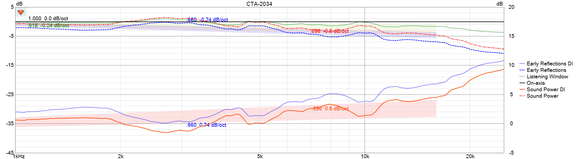

In my speaker that had square edges and no round-overs, and 6" midrange driver, the cabinet didn't have traditional diffraction control ie. roundovers.

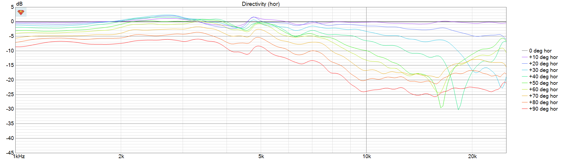

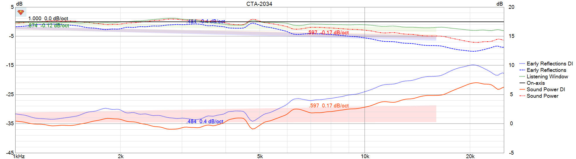

Initially the speaker started with a 26mm dome tweeter. But I ended up using a Ring Radiator. It had the unexpected (to me, at least) characteristic of some improved directivity control around 10KHz and above.
Scan-Speak D2604/8330 on 20x30cm cabinet, slightly off-set:
Scan-Speak R2604/8330 on same cabinet
In listening I found the Ring Radiator sounded much clearer, "less confused", or more relaxed.
Is this better than a shaped optimized cabinet and a "real waveguide". Certainly not. But if cabinet shape/waveguide optimization is something that the cabinet maker can't/doesn't want to do, it is an option.
I wonder whether the OSMC also has such smooth directivity through the use of the ring radiator Scan-Speak R2904/700000. Also another cabinet that was easy to build without large round-overs or facets. Oh, and nice driver- looks and feels like a jewel.
