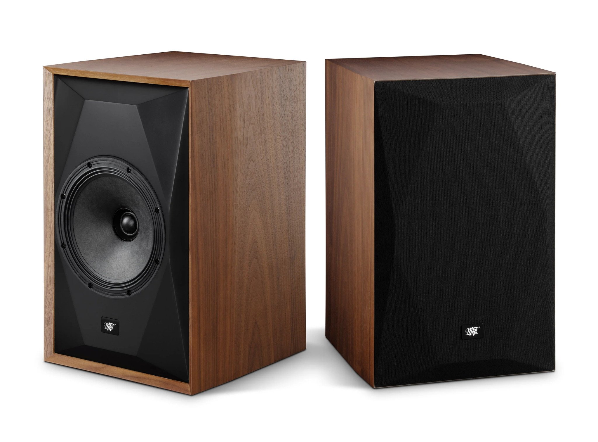

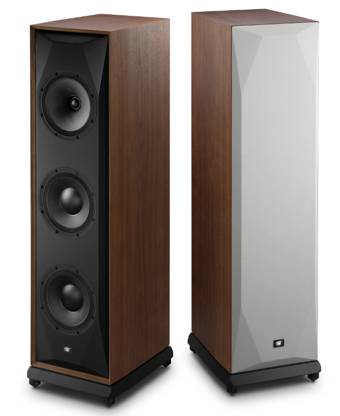

Is there something like a foam baffle with holes for the drivers under the stretchy cloth?
Yeah, I think the baffle was a molded plastic piece bonded to plywood or MDF underneath.
As a DIYer, it was a bit fussy but not difficult. Best to build a 2 layer baffle, with the inside layer fitting into the enclosure & stopped to leave a wide enough gap. Needed my wife's help with the cloth & elastic.

grill like that is nice as it doesn't add any frame which would reflect and diffract more than without the grill. But, I'm afraid the baffle edge is still there and the grill would not prevent sound reaching it so it's just for visuals, having same diffraction effects than any such box with hard edges.
The woofers don't likely show any bad diffraction effects as the baffle is relatively small compared to woofer size, and asymmetric, but the tweeter would diffract as sound gets to the baffle edge just like without the grill, and the edge is there relatively far away and the diffraction is there. There is even additional cutout/edge midway of the front, which also diffracts some.
I'm afraid if one wants monkey coffin outer dimensions, and use tricks to reduce diffraction, the front would need to be quite thick damping material, I mean like the whole top portion of the box, and shaped not like a box, so the monkey coffin idea get's easily ruined. Perhaps some more lightweight diffraction mitigation solutions works fine enough, reduce most audible effect, like some waveguide for tweeter. I don't know what is enough so perhaps make it the traditional way and live with it. For optimized diffraction do something else completely than rectangular box with multiple drivers and slap on fixes.

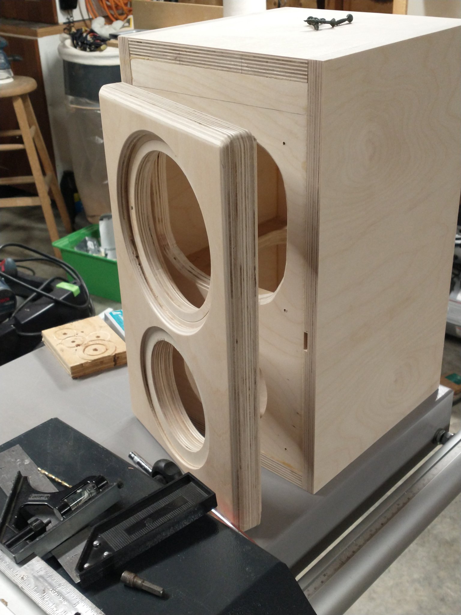

I used a quarter round (1~1.5" radius) on my versions. Can't find good finished pics, but here's one of the baffle being installed. Roundover on this edge was smaller.

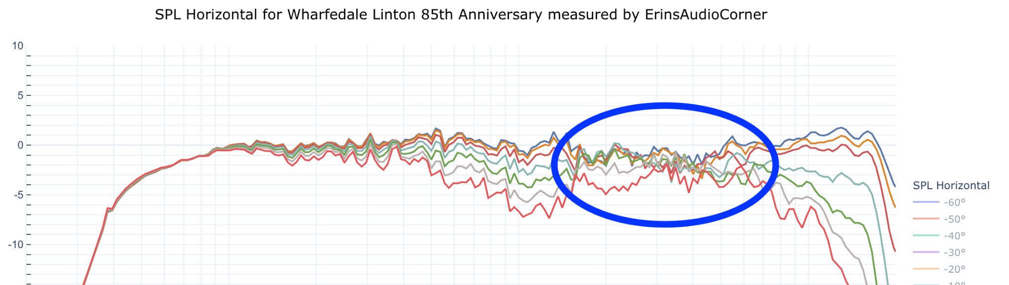

I have circled an area in the horizontal response in these measurements from Erin of the Wharefdale Linton on the Spinorma.org site.
This is where the other diffractions effects are seen and there is not a monotonic falling with frequency off axis, but a large portion of the response where the off axis starts to dominate and in some case peak above the on axis. This is not an insurmountable problem, as this speaker rates highly among a lot of listeners but it does end up needing a lot more subjective voicing to tailor the response so that off axis energy build up does not dominate or skew the frequency balance. For a passive crossover this requires a substantial parts bin or an expensive buy and try routine. An active design version could probably help to get an idea of what sounds good first before trying to match it with passive parts if a simpler speaker without much diffraction mitigation is decided for.

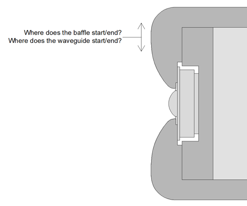

What about putting all HF and MF drivers behind the baffle? ie. mounted on the rear side of the baffle, and then with a 45” chamfer bit or 3/4” roundover from the front hole.
In conjunction with surface mounting the woofer, this would bring acoustic centres in the Z-axis closer together and may facilitate easier (less parts) XO design,
This would effectively create a waveguide for all drivers eg. HF, MF and negate the need for large roundovers from the baffle, making construction easier for all builders.
Yes, this is an unavoidable issue when crossing over a 5” cone driver to a 1” dome tweeter on a flat baffle.

I’m not thinking about the waveguide effect (ie. directivity shaping) but more as “protecting them” from baffle edge diffraction…
That available depth and width would be going towards one or the other, the best compromise as can be determined. I'd do the same. Several available dome/waveguide combinations end at an angle and are just asking for a baffle roundover as it turns out.. but it remains to be worked out.
That whole thing, including the cabinet depth, affects the directivity.
I am thinking of a simple roundover, into the baffle, where the midrange, or tweeter could mount, to effectively put it behind the baffle, and protect it from diffraction effects of a sharp baffle

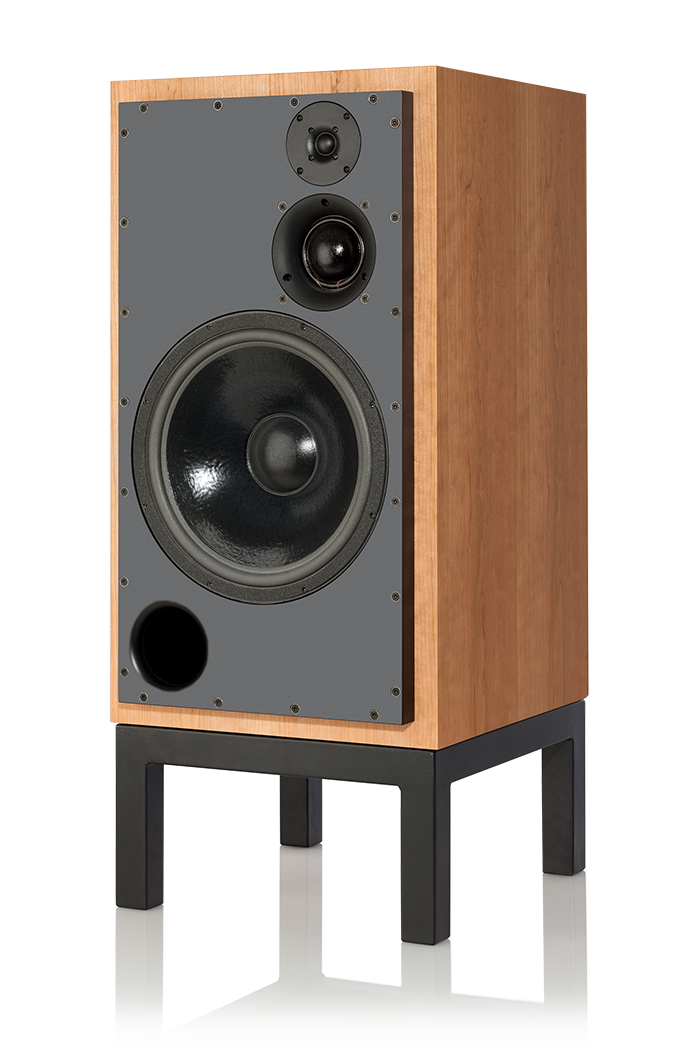

Eg. Midrange mounting ATC employs:

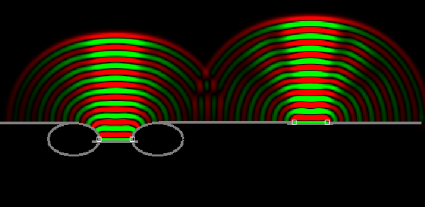

That is needed because a dome moves in one dimension and it's radiation is not dome shaped, but more like a plane wave array. It works similarly to the throat of an OS waveguide in reducing higher order modes. For example...
I suspect it’s more work to do that than to mount a waveguide from the front. Also bear in mind that standard sheet material thicknesses are not the same on both sides of the Atlantic. When you mount something from behind the baffle you will probably have screws going from front to back into the tweeter. The holes for them need yo be perfectly aligned and perpendicular. This was always an issue for OSMC builders.
I suggest going with drivers with inbuilt waveguide instead, many of which can be front-mounted.

An important consideration. Rear mounting drivers creates several complications in cabinet construction, and in the design of the cabinet. A high performance cabinet can be designed with very high stiffness, or with a carefully controlled stiffness and damping, but either way, dimensional tolerances of the internal cabinet structure must be tightly controlled. Removable panels complicate this.
