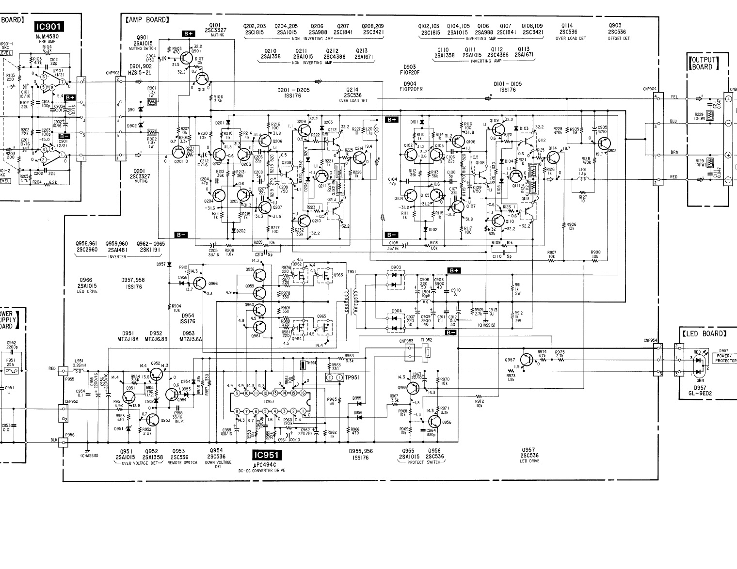

I suppose the transistor might have been leaky as I recall we suspected it earlier on but the transistor tester and DMM tests indicated it was working.
I have ordered five of them just in case and will install the new ones to see if that cures the problem.
I tried shorting the primary and secondary grounds directly to see if that had any effect on the rail voltage issue and it seems to remove the ~5 volt potential difference from them with no deleterious effect on the amplifier.
I'm not sure whether it is an issue to be honest, as Perry said somewhere above the RCA shields would ground out the potential difference in a car installation anyway. My only concern is that some head units have an internal fuse on their ground connection and blowing it means terrible ground noise and a a trip back to the manufacturer for repair.
I should measure the current flowing through the shorted ground and see if it significant but I want to get to the bottom of this weird bias issue first.
I attach a hopefully better resolution version of the schematic, I will try and post the PDF of the service manual too.
Edit: Service manual PDF is too big to attach, it can be downloaded for free from here: SONY XM-6020 SM Service Manual download, schematics, eeprom, repair info for electronics experts

OK, perhaps the transistor is leaky. It has succeeded to me, not only with transistors, also with MOSFET's and diodes.
Keeps us posted when new devices are inserted into the PCB.

I will certainly keep the thread updated, it will be interesting to compare the new transistor to the old in terms of measurements if it fixes the problem.

It turns out to have been the -15v rail Zener diode, D902, just to bring some closure on this.
I did manage to slip with a probe, in my jubilation, and have shorted a 2SA1671, can anyone suggest a modern substitute that is available from reliable sources?
I tried one from ebay but it was an obvious fake and I haven't risked installing it.
2SC5949/ 2SA2121?

Thanks Perry, as it seems I can only get a minimum of five units would it be worth changing the transistors on the other channel as well?
For sonic balance or something?
They shouldn't sound different. The feedback circuit corrects for tiny differences in components.
They are good to have on hand as subs for various outputs.
The ones you listed may work. I recommend the FJAs because I've used a lot of them in amplifiers and never had a problem with them.
