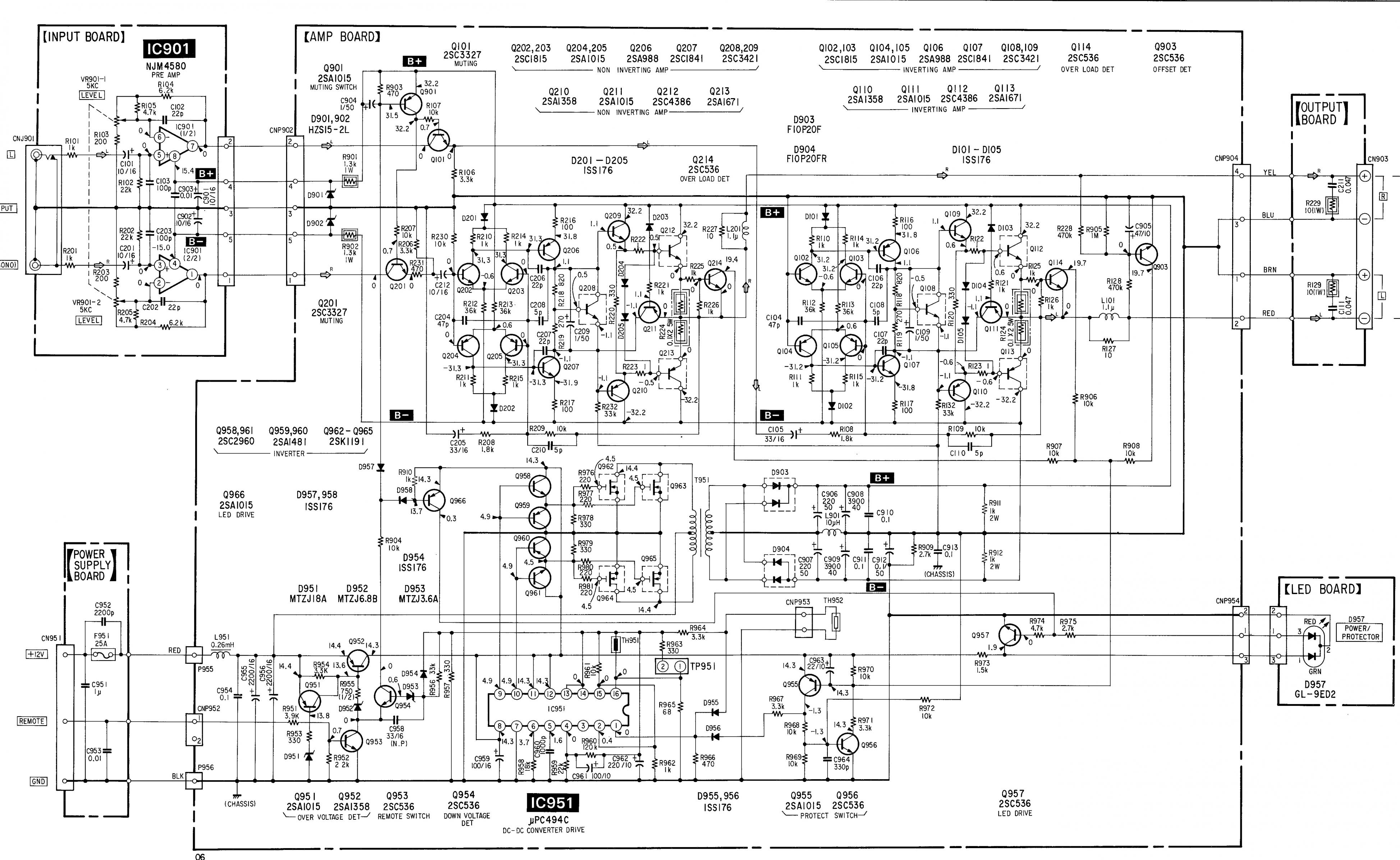

A quick update,
I removed Q901 and tested it as the voltages on Q101 and Q202 were all wrong ( should have been 0.7 volts on the Bases and 0 on the Emitters and Collectors, whereas they were in fact: Q101 - E:7.45v ; C:7.45v ; B:8.16v and Q202 - E:8.65v ; C:8.65v ; B:8.65v).
I obtained one of those transistor boards with the ZIF socket and obtained the attached results.
This transistor is a 2SA733-k and the values given below seem a little off.
the measured Hfe seems a little low for a k variant but is above the minimum given for a general 2SA733.
The Ic seems well out, the data sheet gives it as not more than 100nA whereas the device seems to measure 1.7 mA.
Is this transistor bad?
Datasheet: https://www.mouser.com/datasheet/2/149/2SA733-310191.pdf
Schematic given below, transistors in question towards the top left of the diagram
No. the transistor gives you the current you program in the circuit, givenm certain base and emitter resistors and other parameters. The data sheet usually gives you a certain point of quisient operation to give you an idea of its capabilities.
