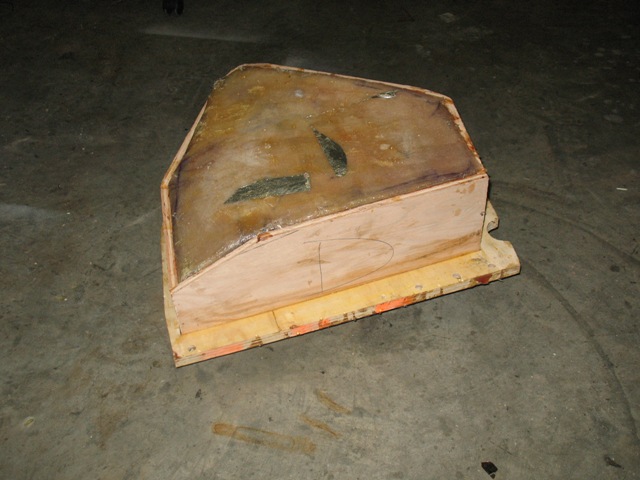

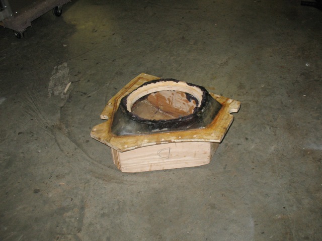

Almost all the sheet metal under the rear window will be cut out or covered with ¾” MDF. For the sides I will use 1/2" MDF. Fiberglass may be the best way to do the rear of the box.
My biggest concern at this time is how to attach the box/baffle to the sheet metal. Since the box is sealed I can't get ‘behind’ the sheet metal to insert a bolt or hold a nut.
I could 'great stuff' some ½” mdf behind the sheet metal with 1/4"-20 Hurricane Nuts. I like these better than t-nuts because t-nuts can sometimes spin and that could be a disaster if I ever needed to take the box out.

Another way is to put threaded inserts in, they work something like rivets. I have used these before and they haven't failed yet!

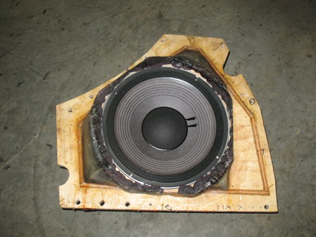

Yeah, still working on the boxes. The baffles of complete and the sides of the cabinet are on. I ended up using the thread inserts in the sheet metal and they worked perfectly. I will have over a .6 cu/ft.
Need to fiberglass the back on, I think that will be easiest. I thin another we or so because I am helping my son study for finals.

mitchyz250f said:While working on the cabinet I realized that a 12" would fit, so I changed my plans from a 2123 to a JBL 2206, 12" Pro Audio midbass.
Your boxes look like they could take the beating. (I just love old school fiberglass work.) Are 2206's still the plan?
Yeah, I am going with the 2206's. I was geting scared at being so close to full excursion with the 2123's. With the 2206 @ 160 watts into 8 ohms, I should be at 100 db at 80 Hz and not be anywhere near full excursion, according to Unibox.

Made a little mistake in that last post. It should have said that with the 2206 @ 160 watts into 8 ohms, I should be at 111 db at 80 Hz and 113 db at 100 Hz. and not be anywhere near full excursion at lest according to Unibox.
I wish I could port because then I could be at 116 db at 80 Hz, but there doesn't seem to be enough room on the front baffle.
