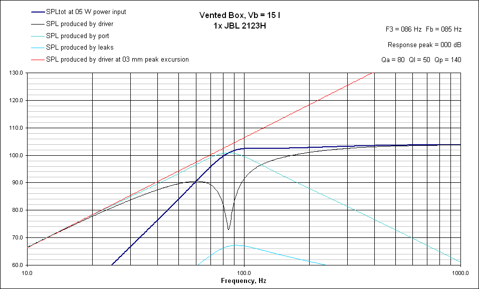

Thanks for your input TS regarding current load. I think it is important to keep the math at the forefront here. I know the GX's are pretty bullet proof as long as you don’t short them out or can not provide the current the needed. Heavy duty power wires aren’t going to help if the alternator can’t supply the power.
Please tell me if these actions mitigate the current requirements somewhat;
-I will be going with a D60 for the tweets instead of the D100.
-I think I am going to be crossing the midbass to midranges at 400 Hz. This (I think?) should reduce the amount of power I need for them since they will not need to produce sounds below 400 Hz. Do you think I will still need the D200 or could I use the D100 for the mids?
- The midbasses playing at 5 watts should get me to 102 db for each speaker, plus 3 db for the 2nd speaker, plus s5 db cabin gain, should get me to 110 db.
I used some serious extrapolation here so if this does not make any sense let me know.

mitchyz250f said:Please tell me if these actions mitigate the current requirements somewhat;
What sparked the comment was simply the move from 8 ohm single 280 operation to effectively 4 ohm on two, plus the third bridged into 4 ohms. It was a gut reaction, maybe unfounded. I don't remember current draw for them, but would estimate about 35A+2*20A at full power.
I don't *think* the Soundstreams will be significant contributers no matter which 2 you choose, because of both the 8 ohm load and the frequency range. The 8 ohm drivers would sway me to use the bigger amplifiers.
UNLESS they are very inefficient and/or draw heavy idle current.
Personally, I've only had a D200 and not in a situation that caused me to pay attention to such things. Anyone else have experience to share with these?
Of course if they're delivering significant amounts of current, the small speakers will act as fuses.
(Unrelated - be sure to use caps in series with the tweeters for DC and amp turn-on protection, since they will have no passive x/o)
5W could be a reasonable average power for an amp that's cranked and delivering 160W transients, depending on the music. 20log(160W/5W) = 30dB of dynamic range.
If it were me, I would proceed as planned and add a voltmeter (cheap and easy) to watch while getting to know the system.
