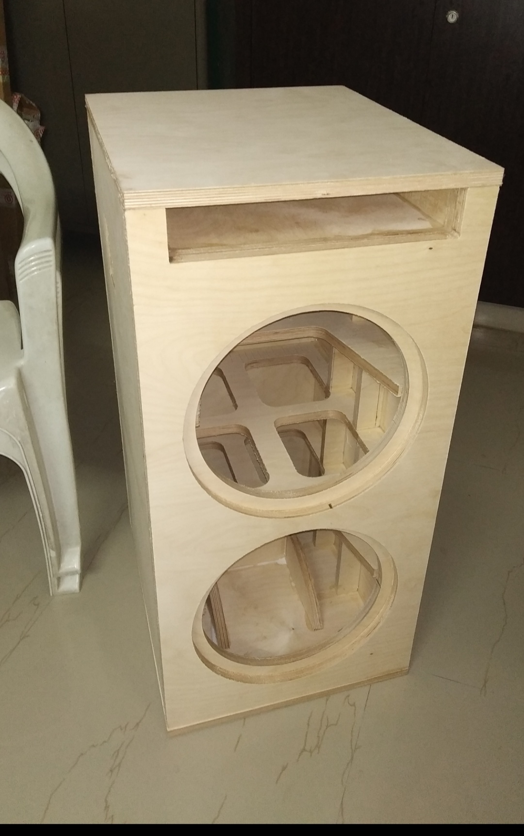

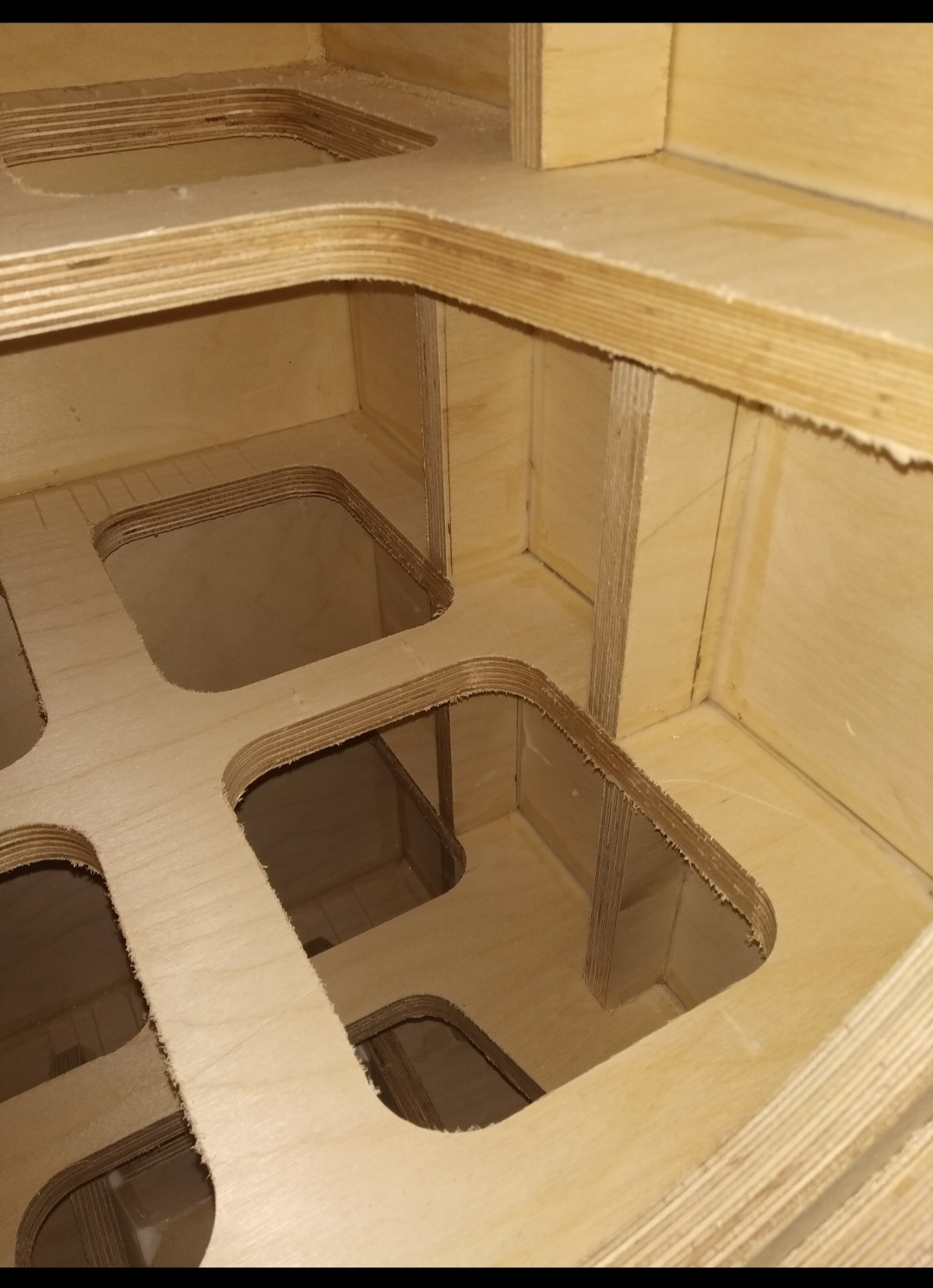

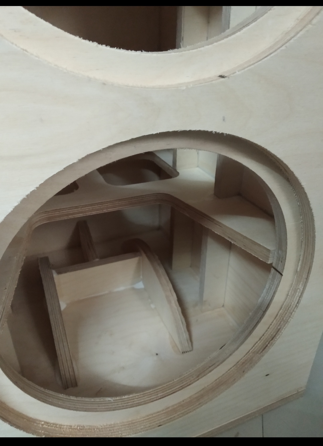

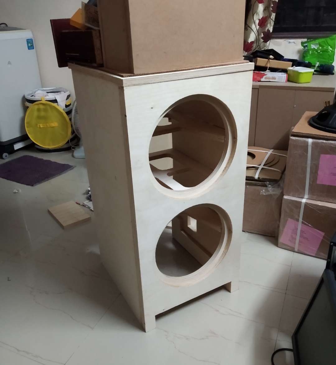

Hey guys,
I started building a ported sub with two 12" drivers for my HT.
It is just half way through, see the attached pics. Will post some more pics as i progress.
Naveen
