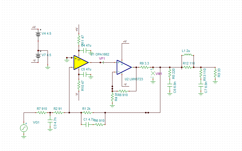

I made something like you are looking for a while ago. Although I made an emphasize on lover idle current, as it was going to be powered from a 9V battery. Should be no problem running it on 12V. Here how it looks like:
If you are interested, I can try to dig up the schematic.

The amplifier itself look pretty much like this. I've simplified it a little bit. There where a few extra things which I think will not make too much difference.
There is also a supply rail splitter on that board, based on LM7322. It generates mid supply of 9V. This mid supply also was used as a signal ground. Depending on supply arrangement in your case, it may not be possible to reuse such solution.
Also, if supply source allows, some different opamp may be chosen for the design. These low power high speed guys are quite touchy in terms of stray capacitance.

Hi Sergey,
Your design is based on Walt Jung's composite opamp design, which might have some restrictions for me, as my supply is 12v analog, as I said.
I do have to create a V+/2 reference ground, so I don't see how I could apply it to that circuit, if at all possible.
This design is perfectly usable with unipolar +12V supply with a half supply "virtual ground". You just need to change net names as per what you have on your board. +V goes to +12V, -V goes to 0 and ground goes to you virtual ground - 12V/2.
Depending on how you are going to organize virtual ground, you may need if add DC decoupling capacitors. Although it is better if you can avoid to have one. At least at the output path.
Yes, DC decoupling capacitors are needed in V+/2 arrangements. But that is not such a serious problem to me.

I like multiloop composite amps with CFA output - but sergey's circuit, gain/feedback values may push stability limits
I really wouldn't try that without a local feedback C on the input op amp to slow the global loop - with the LMH6723 at Av 11 you are dropping to a few 10s to MHz corner (CFA do run out of GBW at high gains), may add too much phase shift for the 22 MHz input op amp

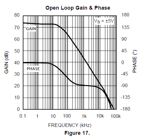

Sergey - see figure 17 in the LMH6723 datasheet - you really don't want to stack poles that close in frequency inside the global loop
I like to see >~3:1 separation of pole frequencies for a fast buffer/current gain stage inside the global loop and the gain intercept - for your values you need to slow the loop, or rearrange the gains
for instance dropping the gain of the LMH6723 to less than the global loop gain (or the high frequency "noise gain") setting is valuable - say to +5
I would like to see your gain and phase margin plots from sim, and if the chip models response agree with the datasheet specs for the chips

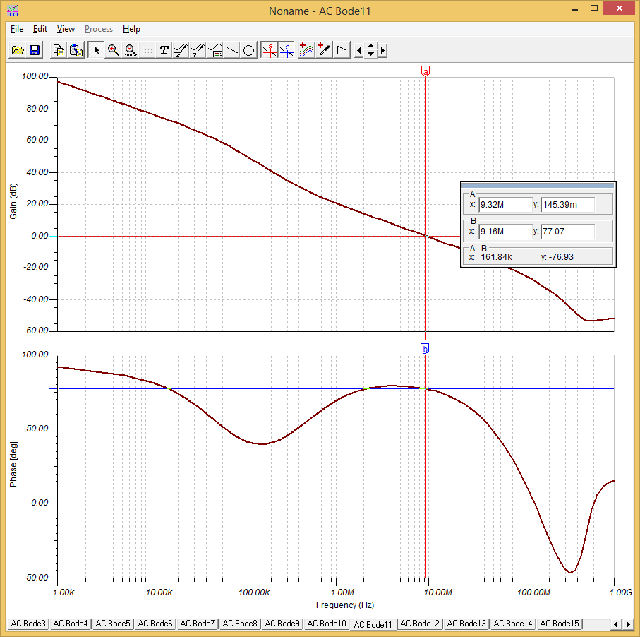

Seems like you are missing presence of R2 C3 chain.
Also, did you notice that LMH6723 is actually a CFA?
LMH6723 model is not perfect, but not too bad as well.

Sergey, you are relying on a really bad model - in LTspice the LMH6723 model gives 557 MHz GBW, and over 60 MHz 3 dB for your 910/91 Ohm feedback at +/- 5 Vs
that's ridiculously inaccurate matching to datasheet numbers and plots
the LM6723 datasheet graph fig. 17 I was estimating from barley clears 10 MHz at 20 dB gain
even if the LMH phase shift gives a peaking boost to 20 MHz the margins are going to be really poor for your circuit
I am quite familiar with CFA, noise gain compensation, multiloop compensation - I am using quick estimates - but have now shown a big discrepancy in the TI PSPICE model and the datasheet performance plots
For the LMH6723/LMH6724/LMH6725 the input resistance of the inverting input
is approximately 500Ω and 100Ω is a practical lower limit for RG. The LMH6723/LMH6724/LMH6725 begins to
operate in a gain bandwidth limited fashion in the region where RF must be increased for higher gains. Note that
the amplifier will operate with RG values well below 100Ω; however, results will be substantially different than
predicted from ideal models.
