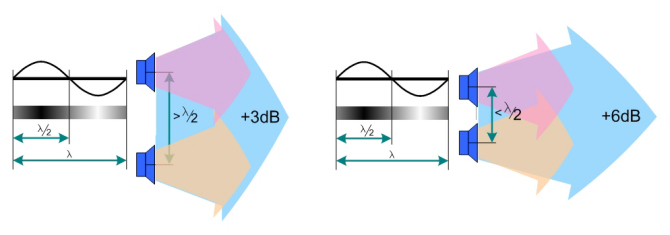

right now, the entire width of the boombox is 25" in length - I don't want to go any larger, as I've squeezed just about as little room as I can and still keeping it tuned to the fs (all math is done on paper, I'm sure I can get some more fudge room with mathcad).
the internal dimensions (without the t-line walls) per side are w:11" x L:10" x h:8" (total height is actually a little over 12" after I put the battery and components atop).
without the t-line walls the internal volume is WAY larger than what the driver would need, if it was in even a ported enclosure, so a different design of just about any other will bring the size down, I suppose.

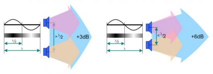

with the woofers summed in mono, and near each other, will I benefit from a +db boost?

You are going to be constrained by the volume available to implement the sub channel with - unless this is to be an ENORMOUS boombox.
Sum the bass signals into a mono channel.
Build one sub (or bass) channel only.
Don't get hung up on theoretical "summing gains" of multiple woofers. Frankly the "+6dB gain" of two bass channels that are too damn small to be any use is not going to help. Build a single channel that perfroms as well as you can in the volume you have available.
