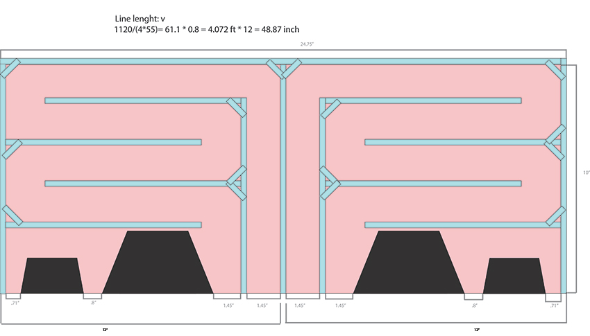

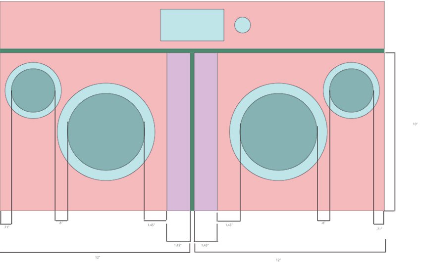

Hello all, I'm wanting to create a portable boombox and want to use this oppertunity to expand my scope of builds into my first Transmission Line. I've been doing some cinsiderable reading on the subject and I *think* I'm getting the hang of most of it.
Before I continue further I thought I'd ask your advice... I don't have access to MathCad /sketch up at school, but I wanted to post a mockup of the t-line and dimensions so that you guys could yay or nay my current design...
I'm building the enclosure around the Tang band 5 1/4" speaker (fs 55hz).
Tang Band W5-704D 5-1/4" Woofer
crossed with a 3" fountek driver:
https://www.parts-express.com/fountek-fe85-3-full-range-speaker-driver--296-717
After reading MJK's work and tables I've concluded that the line needs to be aprox. 49" in length with a cross section of 14.57^2" (94cm^2... the reduction from a 61.1" to 49" line is due to the .8 fudge factor- if I'm understanding that right?)
My concern is how close the woofer(s) will be to the mouth of the line and if this is feasible?
The enclosure is already nearly 25" wide, 14" high and 10" deep... I feel if it get's any larger it will no longer be considered in the realm of a "portable boombox."
Any suggestions?

No need to operate in stereo. Speakers are simply too close together to have much effect. Better to sum mono. Can look at it like this, it's now half the size or has better bass extension when maintaining same internal overal volume as is.
I've been considering mono, and it seems more and more likely if i want to do a portable T-Line that gets into the 50s Hz range, however I'd really like to go stereo (I'm getting back into my Zepplin albums and would miss the cross-fades).
I'm planning on making the xo around 150hz for the Tang Band's and the full ranges handling everything above.
Is this a lost cause (without going bass reflex/ported)?
You won't hear those cross fades unless you are centered and close. So unless it's sitting on a shelf above a work bench, stereo goal is pointless.
I like my Zep too. When designing speakers I always test in mono. Stereo just makes it sound fancier. I wonder how many people listen to that new pair of speakes with only one hooked up and run mono would feel about their purchase 😉

TL is not the way to go for portable full stop, bloated and oversized.
Go sealed, outdoors bass is a joke without room gain, or bass vented.

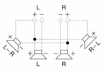

i'd go one bass, L+R mid treble, strereo amplifier with one
channel inverted, one L or R wired out of phase and the
bass unit across L+R positive for bridging mono output.
Simple series L for bass and C for L and R.
rgds, sreten.
I'd be inclined to keep it simple. Two fullrange speakers, and a highpass active filter so you don't waste headroom on bass they can't handle. Try prototyping using junk particleboard if you want to try anything fancy.

It appears the discussion missed the point of "mono". The thrust of the original recommendation was to go mono is for the bass. Mono Bass provides you double the enclosure volume from which you will be trying to squeeze low end.
Stay stereo for your full-ranges above 150Hz. This is a very practical compromise.
Remember that your ears have >>NO<< ability to localise bass below about 80Hz, and stuff all ability until well into the 100s of Hz, so this will have no meaningful impact on the stereo imaging of the system.
On the specific question of the TL - I will leave that to the experts.
You can also do something like this - a matrixed triple speaker approach. From this thread: http://www.diyaudio.com/forums/full-range/257110-master-nagaoka-tetsuo-explorations-matrixed-single-stereo-speakers.html
The central channel has the HF's bypassed and handles the mids and bass. All three channels handle the bass so that you get less cone excursion and lower distortion for the bass production in a small portable that doesn't use big woofers.
There is also the Nagaoka matrix:

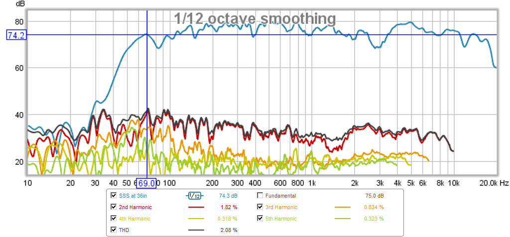

My implementation with three drivers in one box with one reflex vent ended up looking like this:
Measurement looked like this:
425054d1403491095-master-nagaoka-tetsuo-explorations-matrixed-single-stereo-speakers-sss-tc9fd-freq-meas-36in-high-48in-wall.png
