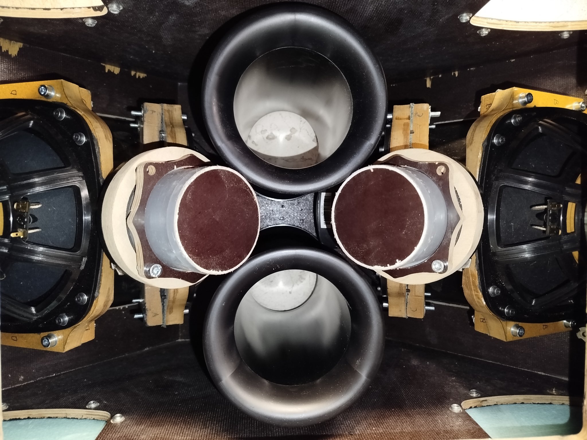

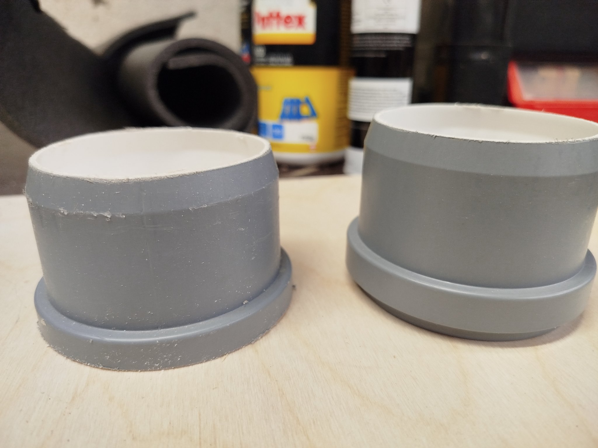

I was thinking a lot how to design fullrange "box" (better said closed volume) , that will allow quick & simple installation, and that will be based on cheap material.

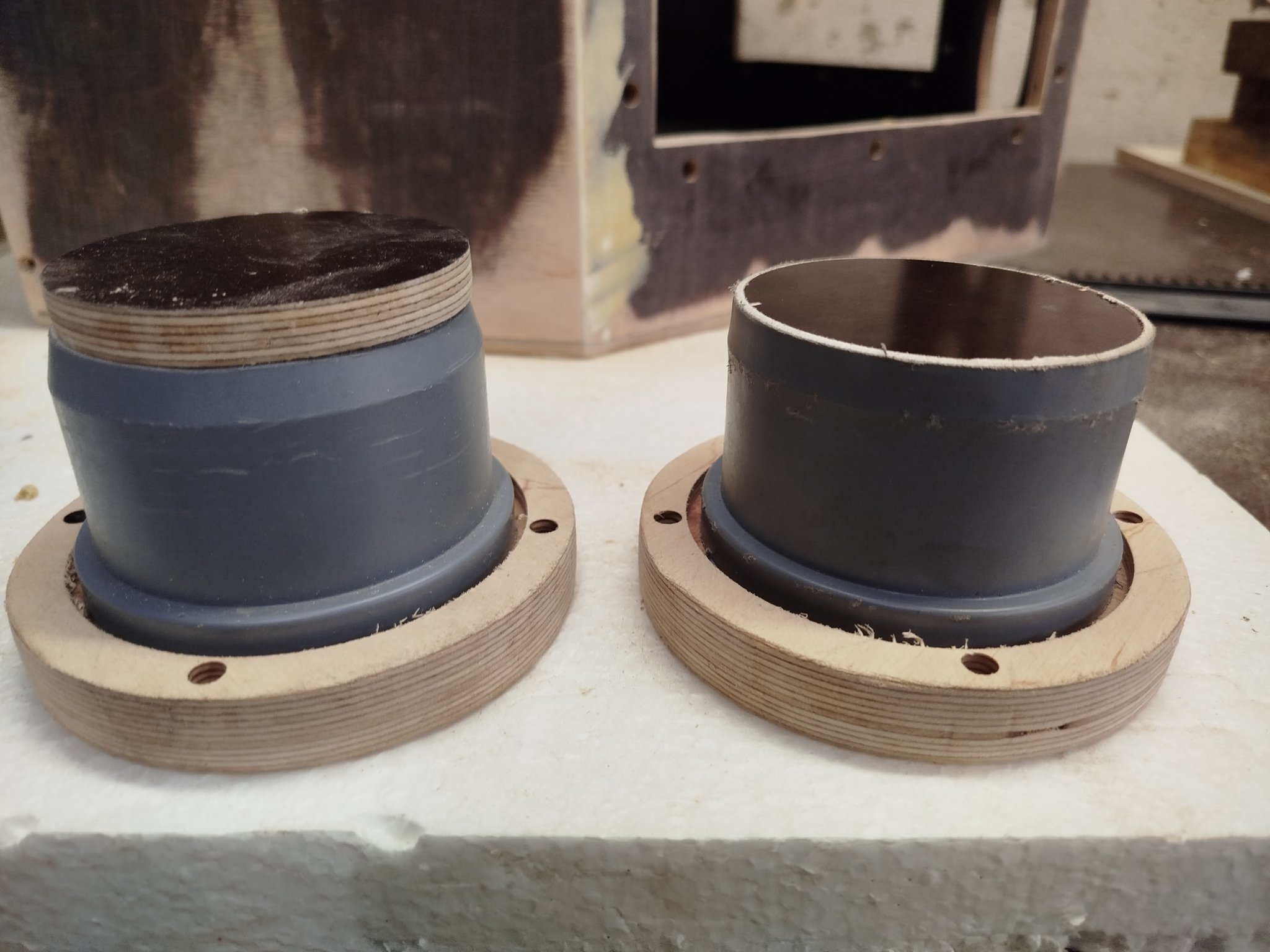

So, I designed this "box" from three major parts:

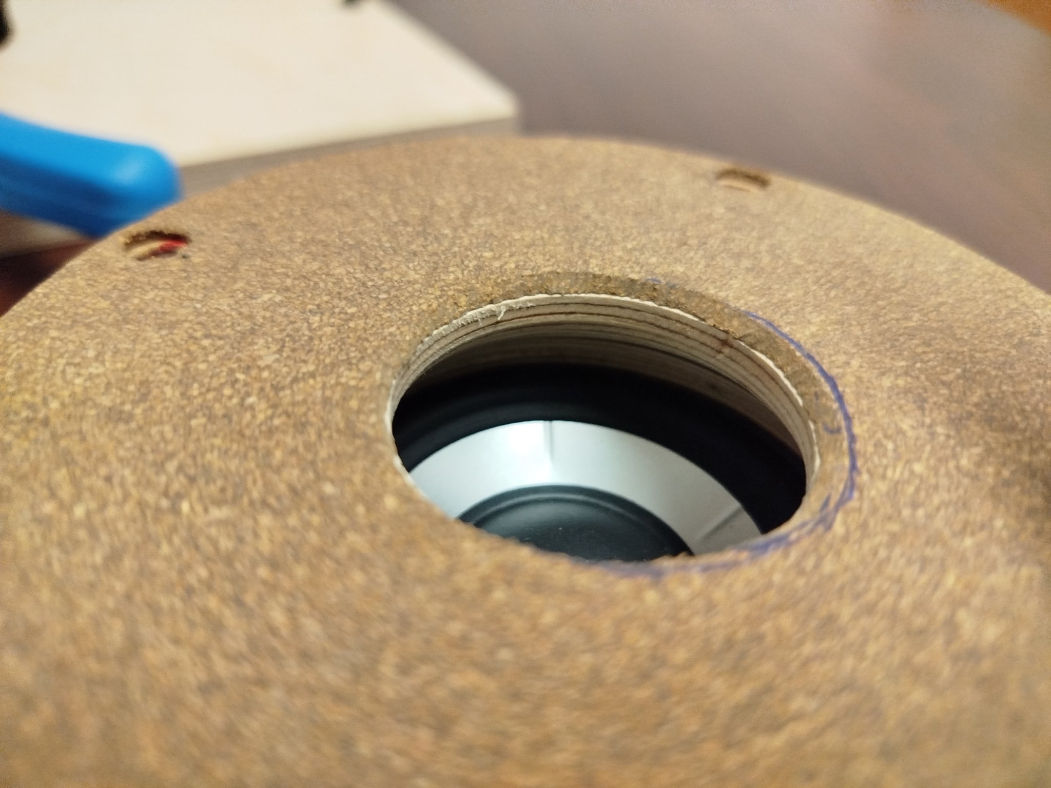

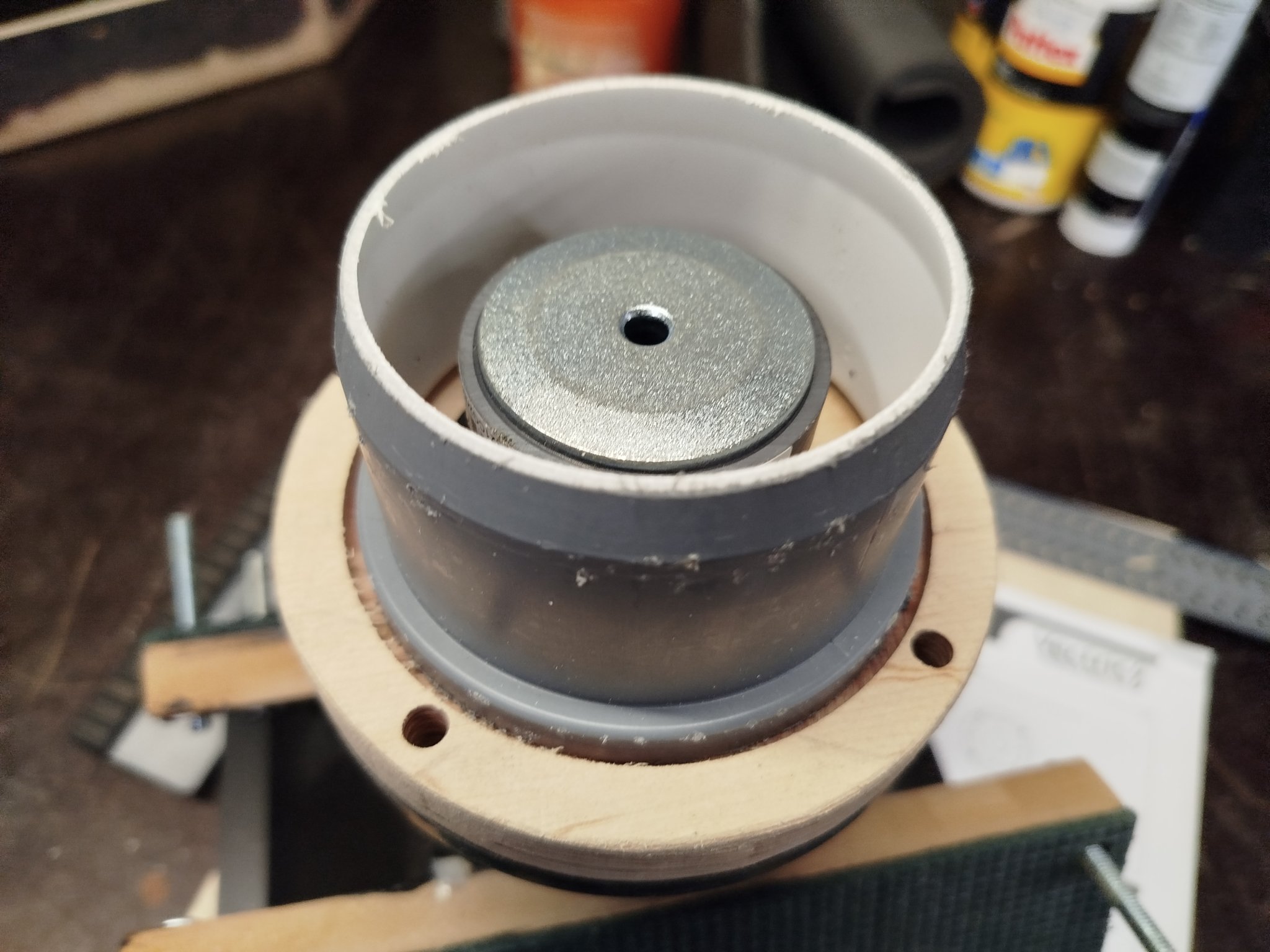

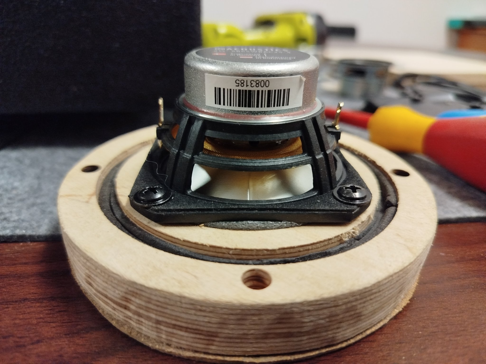

a) First part is flange driver adapter , made from plywood.
It has conically shaped hole in the center , that will enable smooth transition from 2.5" driver to horn mouth, but it also has one 5mm x 5mm groove cut, for seal foam.
b) Second part is 70mm PVC pipe , cut to 50mm length, with end cap pressed to close it from one side.
Important thing is that I used part of PVC pipe that has enlarged one end, that will seal against flange adapter groove.
c) Third part is simple 4-bolt "clamp" , machined from plywood.
This clamp will attach to 70mm pipe, and will compress it against foam seal on flange adapter.
So now - the moment of truth - first assembly.😎
I am aware that I left very small tolerances in my design, but during assembly, it is scary how tight are some of them.

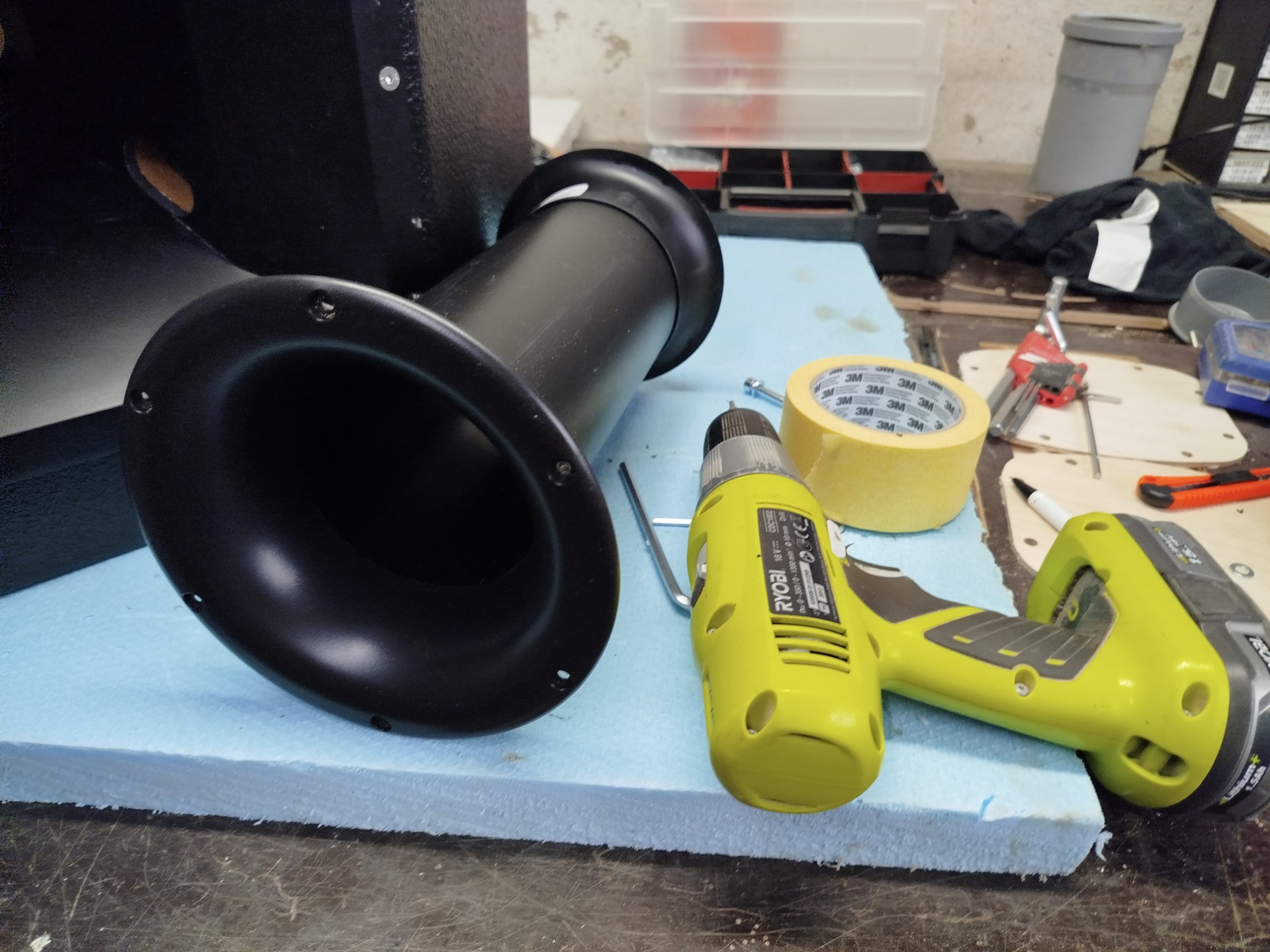

But before assembly, just one size comparison of new 100mm flanged bass reflex port compared to my 18V battery drill :

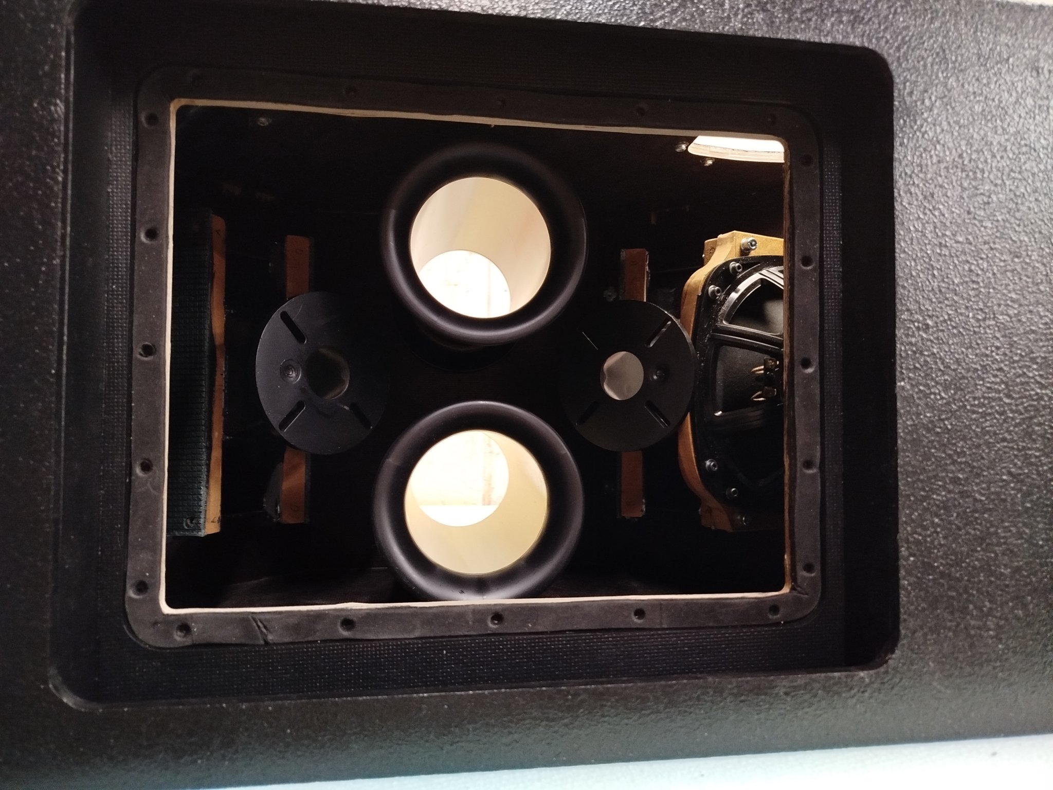

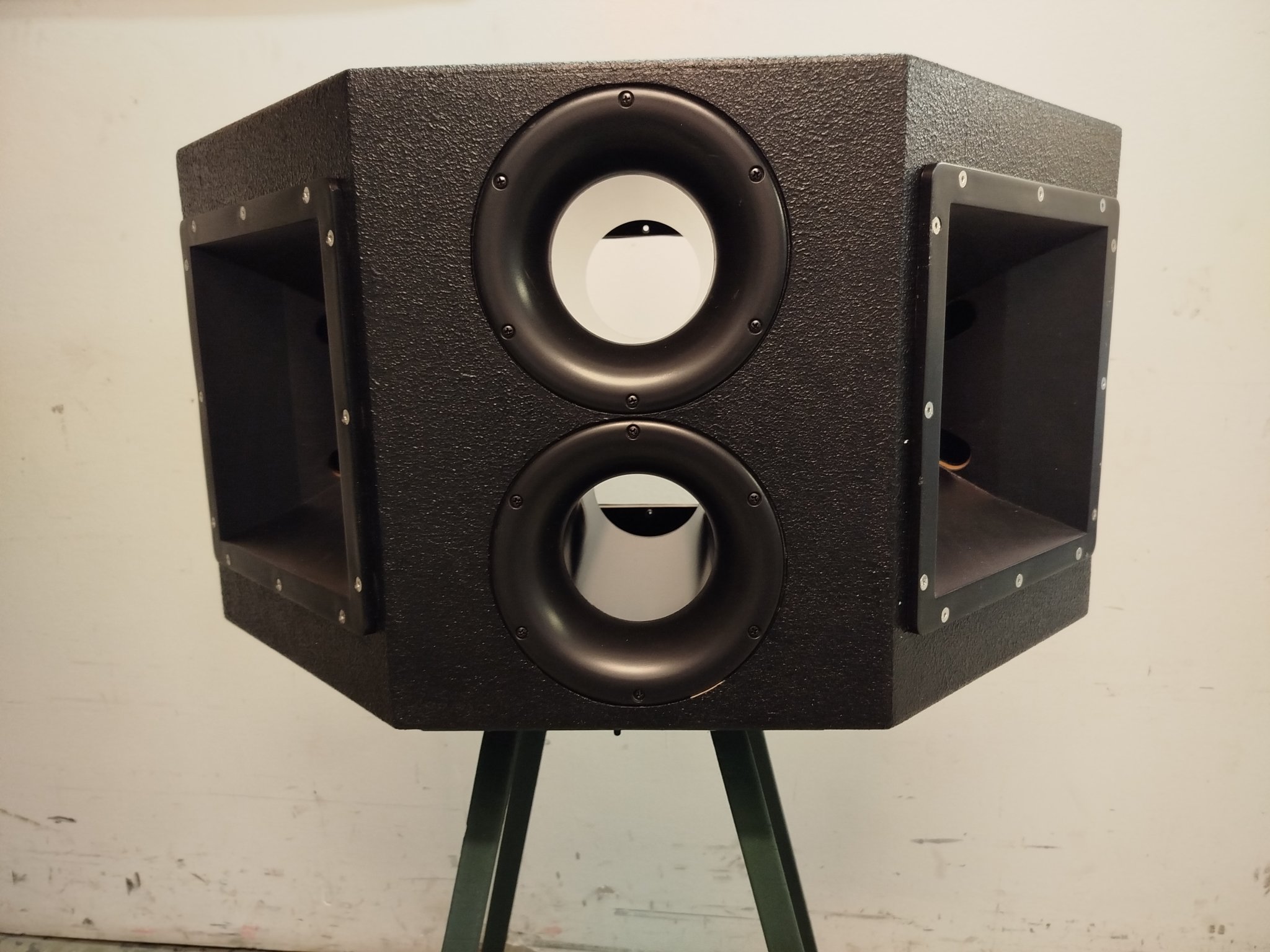

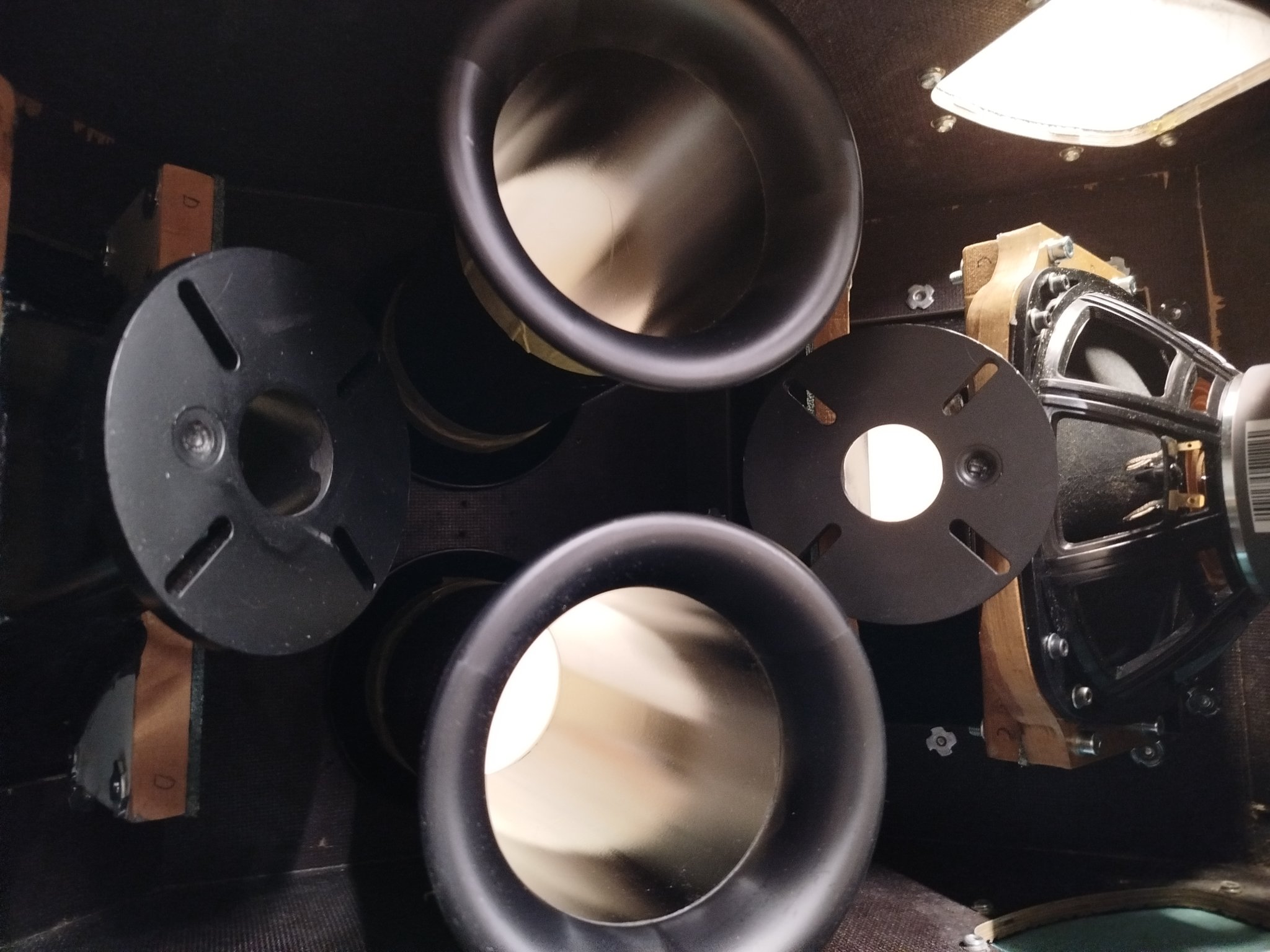

Regarding bass reflex ports in horn mouth:
- Yes, I am aware of such port placement, but discarded this option for two reasons:
a) First and most important is to minimize influence of additional holes on horn surface.
Each hole on horn cause issues in acoustic response, so even though holes could be placed on edge
of the horn mouth where their influence is probably lest critical , it would still probably cause some issues that have to be sorted by DSP.
To maximize surface area (to reduce port chuffing) I would have to drill at least 4 large holes in each horn mouth, and I already have 4 large woofer injection ports.
b) Second reason is that with my design (two horns in one box, placed at 90 degree angle), there will be large empty space between two horn mouth, which can't be avoided => if I want to move horn closer to each other, then full range drivers will touch each other.
So to make some use of this large surface between two horn mouths (approx 300 x 350mm), I decided to install largest bass reflex ports that could fit, to minimize port chuffing.

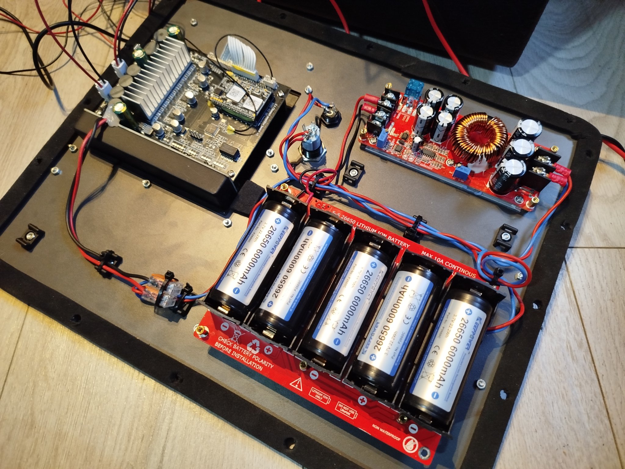

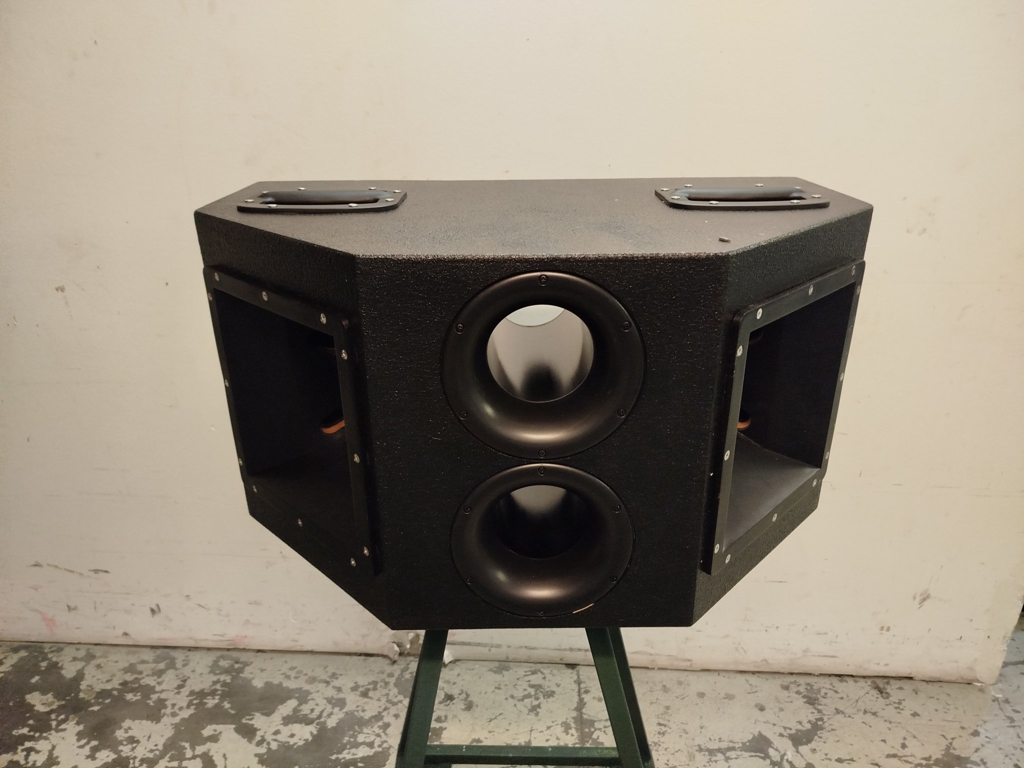

While waiting for missing parts, I decided to quickly assemble speaker with existing components, scavenged from my single MEH bluetooth prototype.
Therefore, I took following items:
  • "Arylic" Up2Stream 2.1 plate amp,
  • Single battery board (21V DC),
  • Two old fullrange, no-name drivers (5 W each).
  • Additional DC/DC converter board (to raise voltage to 24V DC - maximum for "Arylic" amp).
Such setup will not be able to produce maximum volume as with two 3255 amp boards , powered by 42 V DC total, but at least I can start with DSP adjustments, and I can at least enjoy in music finally 🙂

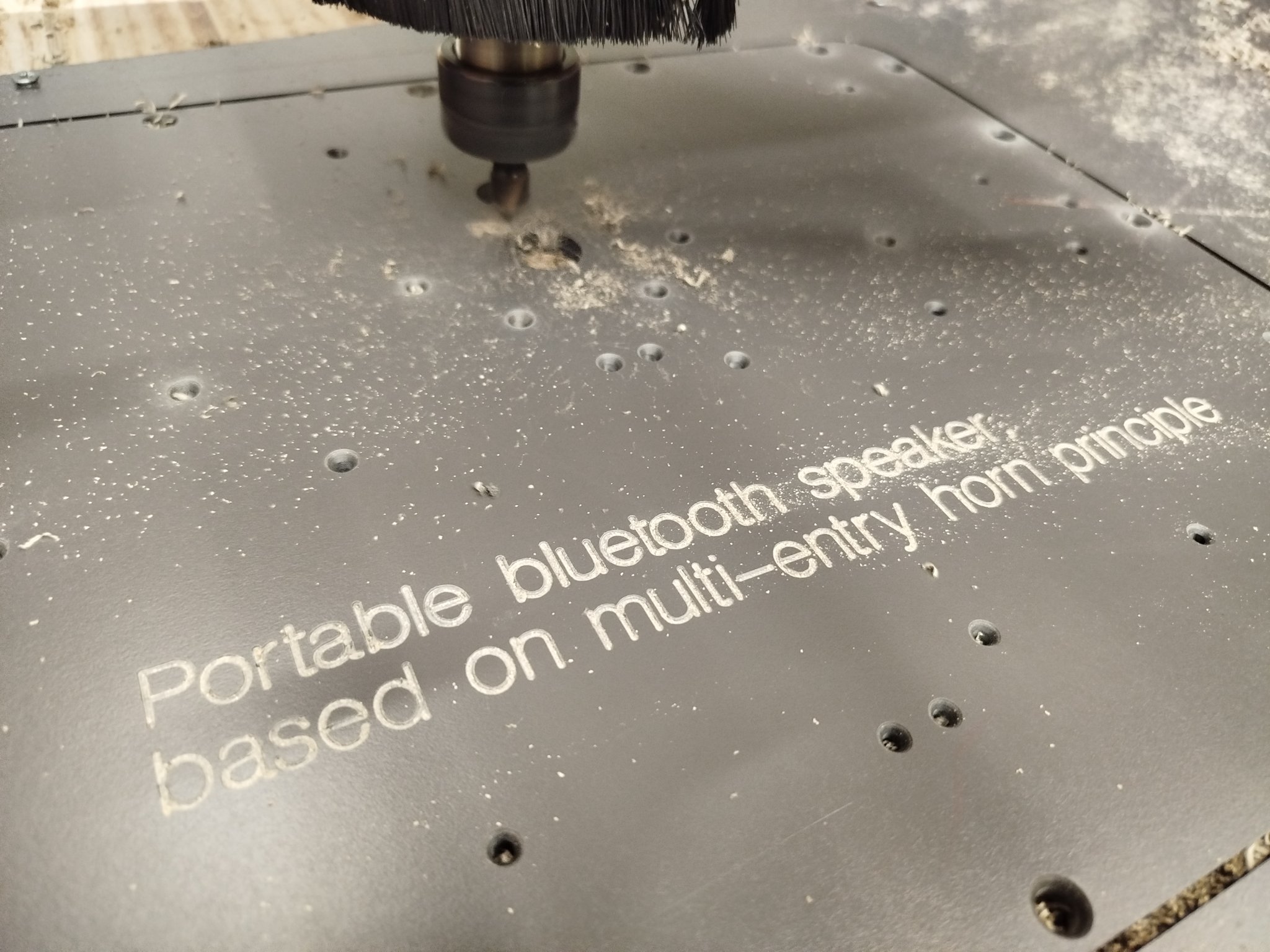

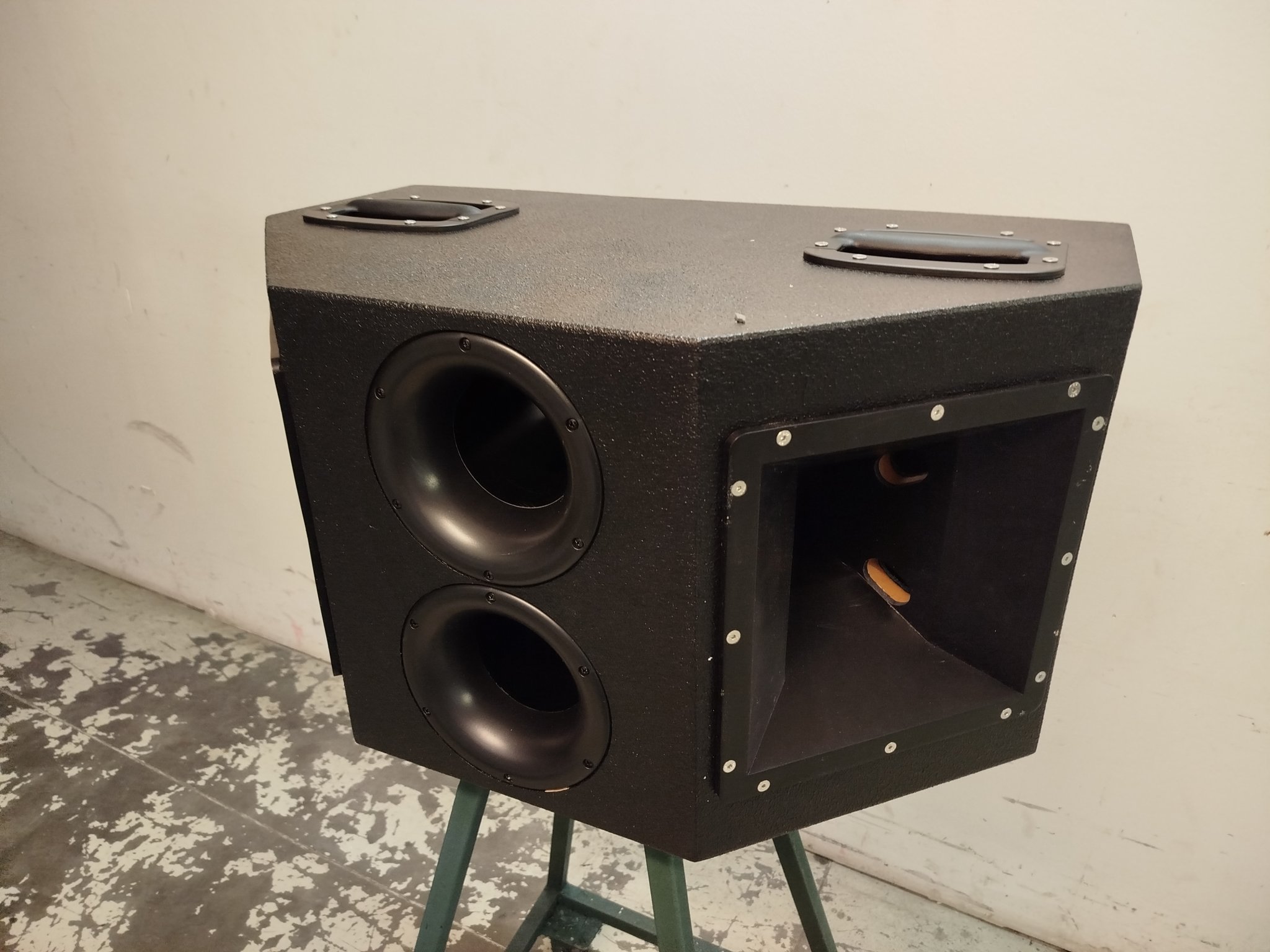

To mount all above electronics, I designed removable cover , and cut it on CNC from 6mm HPL laminate left overs - this material cuts nicely, and is very dense & strong, so it should resist vibrations:
As this is temporary panel, I've played with single line fonts for engraving just for fun:
Speaker wiring was connected and panel was tightened with allen bolts (lot of them, as you can see), and then speaker was powered on.
Couple of quick REW measurements later (in indoor conditions, not ideal) and couple of things were noted:
a) Small 5W fullranger simply can't keep with woofer output, which was of course expected => while it sounds quite clear and natural, when pushed to maximum power it just can't provide sufficient output in mids, and especially in higher freq range.
I am just affraid that I will burn fragile 5W coil with max power, even though I have crossover at 600Hz, but this cheap fullranger doesn't sound disstressed, at least now.
b) Woofers have plenty of output, and with shorter bass reflex tubes (130mm) , speaker has slightly raised low frequency response.
I can't believe that I am saying that, but I have too much bass in the moment => I believe that with SB Acoustics 2.5" fullranger, mid/high range will raise and it will get to desired level.
c) On maximum power , the box is quite inert, even though I was affraid that 9mm ply will not be sufficeintly strong, so it is not producing any funny noises.
d) Bass reflex ports are definitely not an overkill => the amount of air volume is quite high, and it will be even higher with new amps, so I am satisfied with my choice.
How do they sound ?
Extremely clean - even with this tiny, cheap 2" fullrange speaker, which I removed from old PC speaker, everything sounds very, very clear.
The typical MEH sound, is here, but because of two horns mounted on angle, the coverage is definitely wider, but I have to do measurements outdoor to see real benefits & drawbacks.
There is more than enough bass, and it goes sufficiently deep for the purpose - I've tested only indoor for now, and they can easily go to 50Hz with short bass reflex ports, and without any extra bass compensation in DSP.

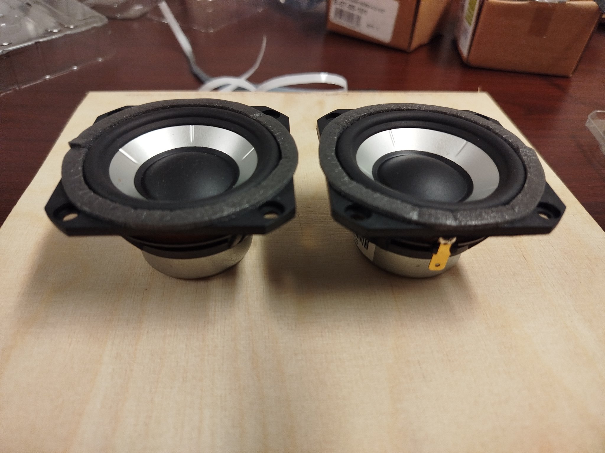

So let's go with some pics of "SB Acoustics" fullranger installation & some other mods.
Here is box full of goodies , SB Acoustics fullrange drivers, new TPA 3255 boards with DSP, cable sets, additional battery board, etc.:

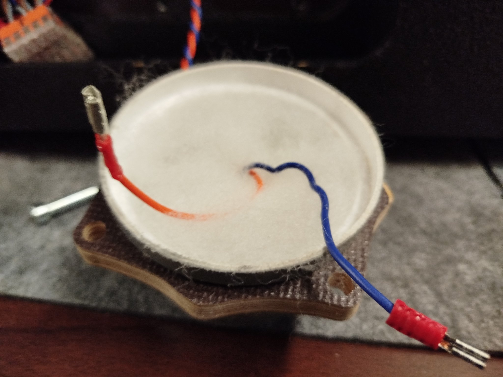

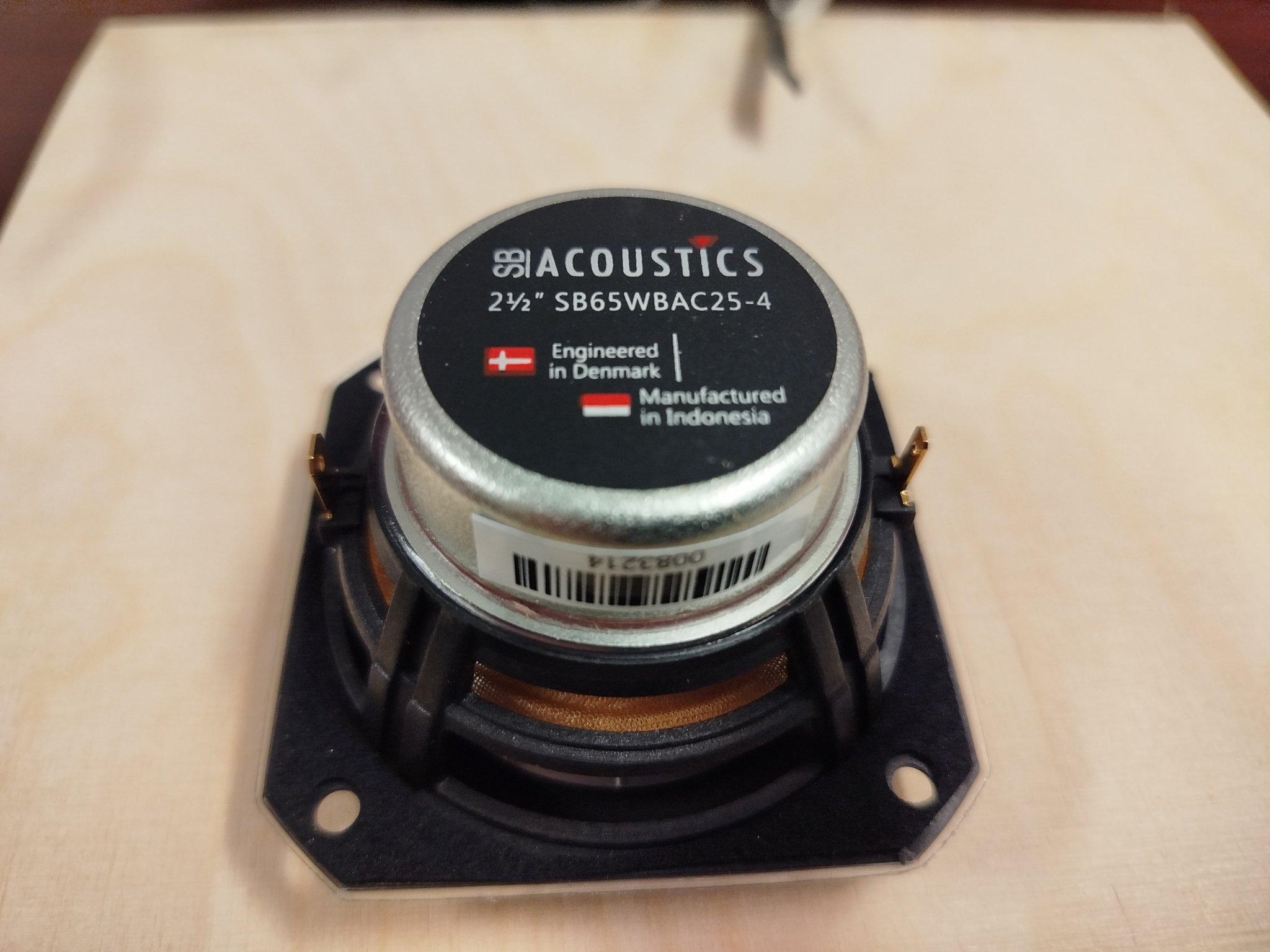

This driver looks quite well built:
I've added sealing tape around both drivers:

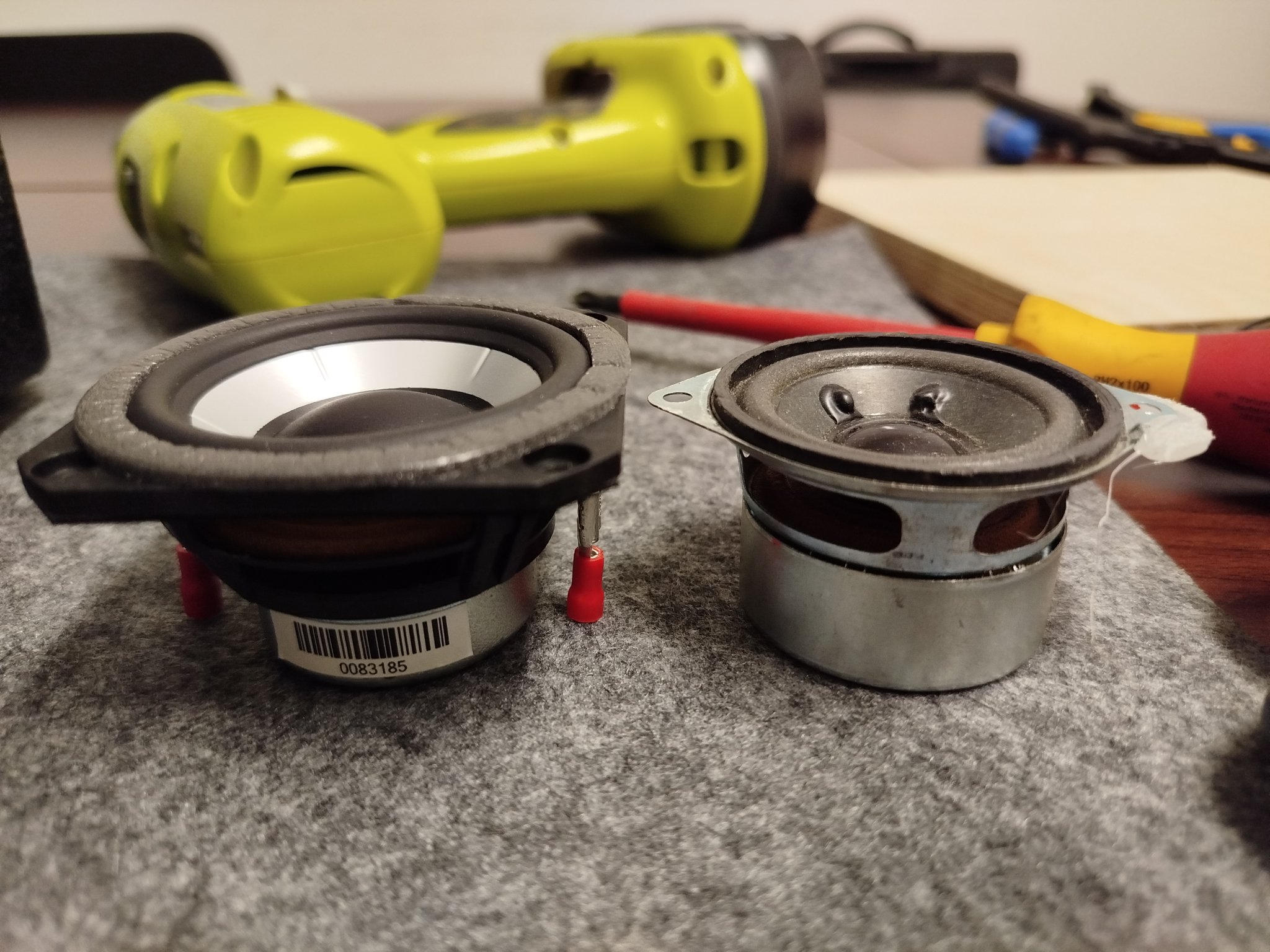

Here is comparison between "SB Acoustics" 2.5" driver and my no-name, 6W driver that I temporarily used:
Driver attached to plywood flange adapter:

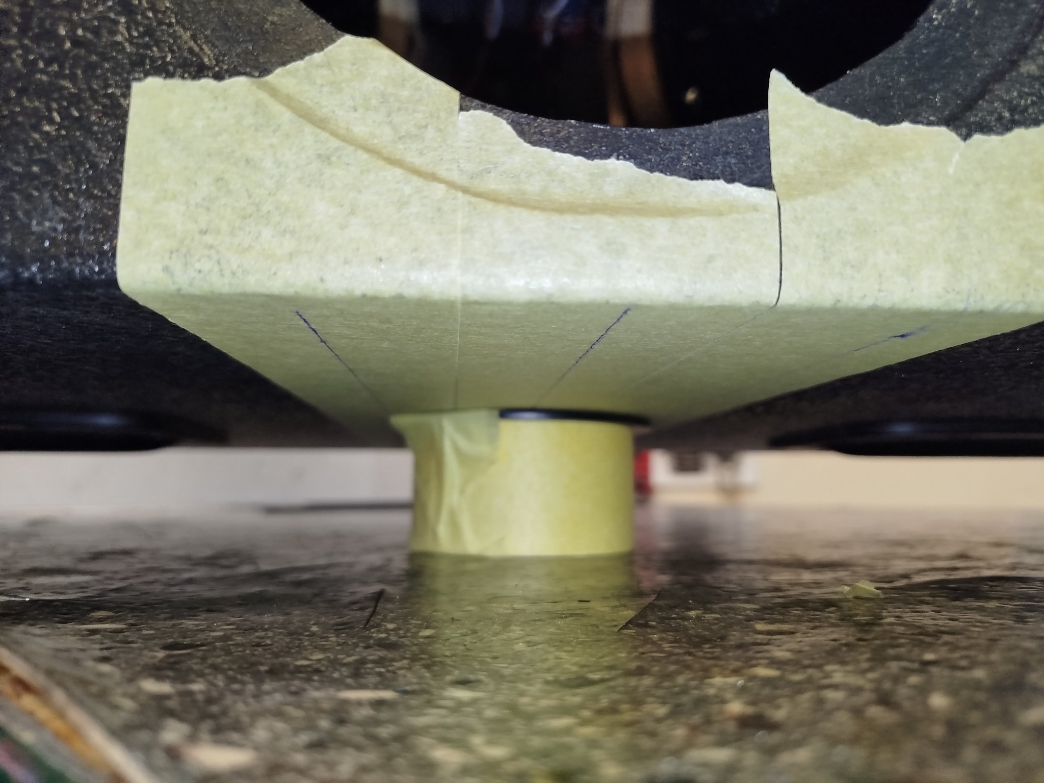

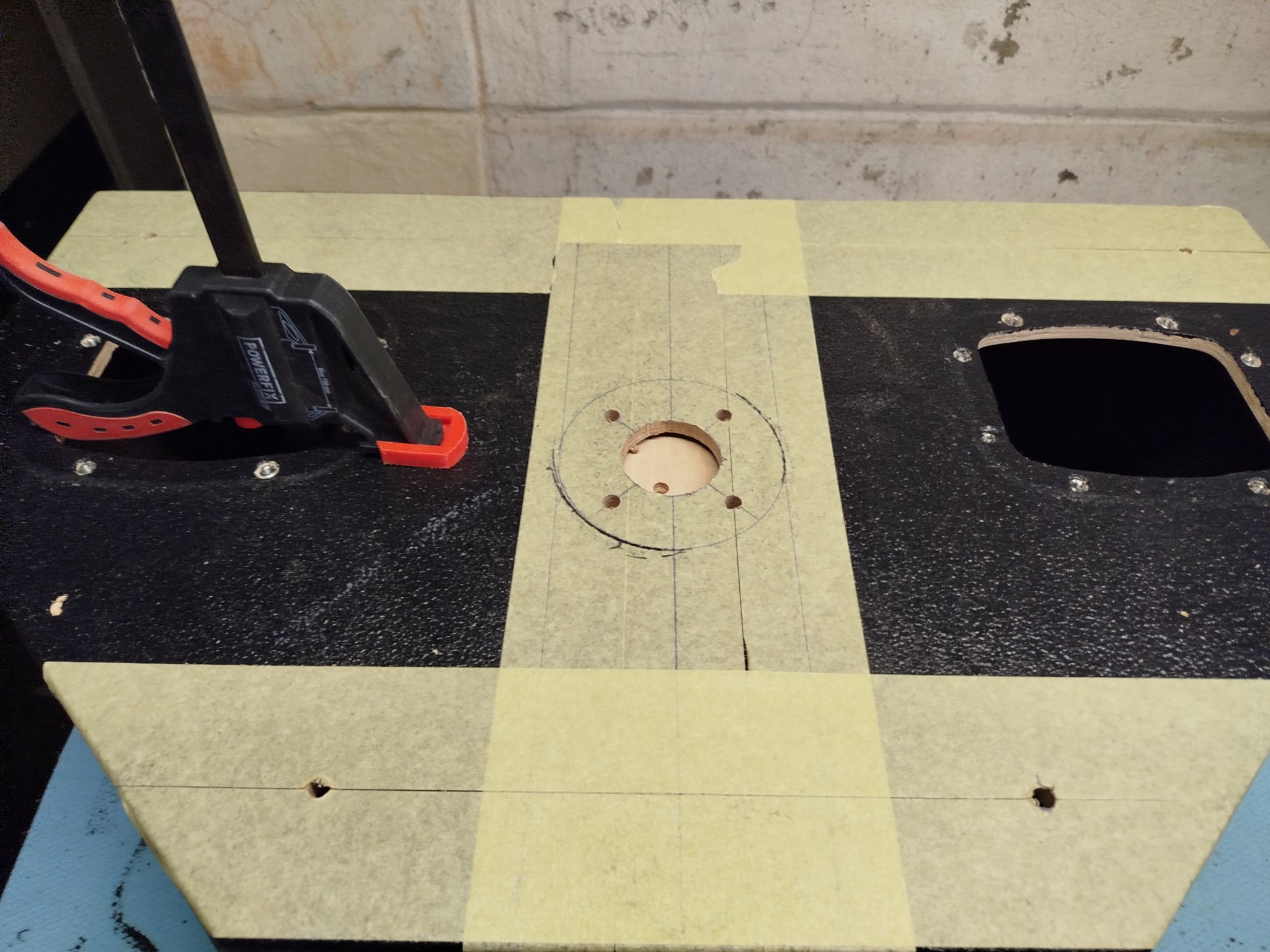

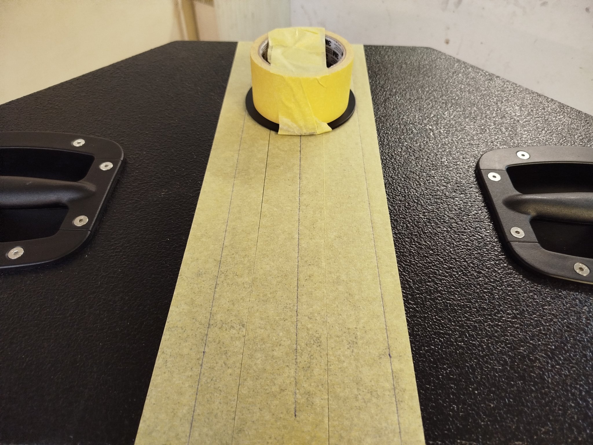

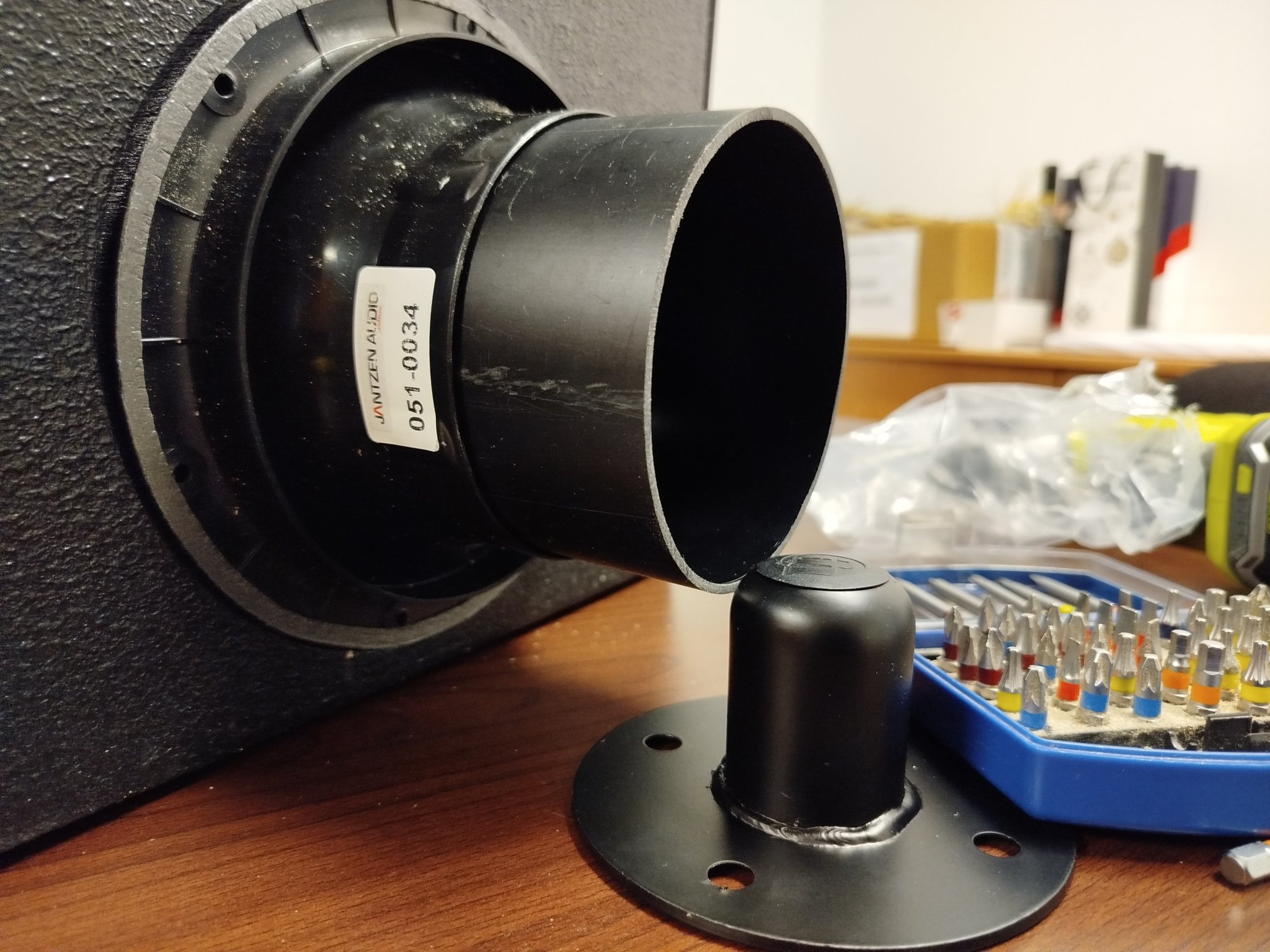

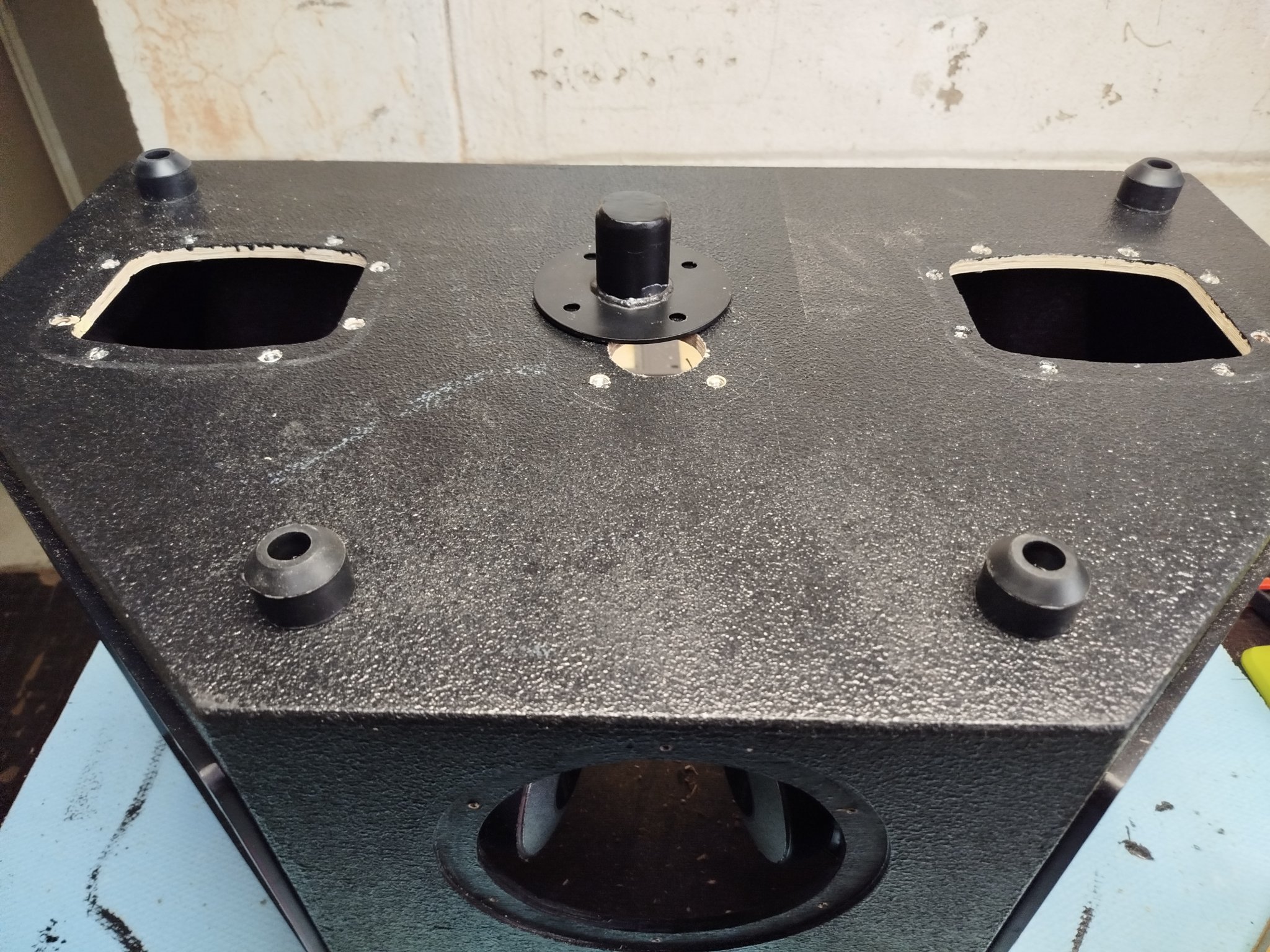

One of the last feature that I wanted to add on my box is standard PA loudspeaker stand adapter (35mm diameter).
To add this, I knew from my 3D model that it will be a tight fit due lower bass reflex pipe (100mm dia) => so, I decided to use short 35mm adapter, but it also require additional shortening as you can see from pic below (grinder & TIG welder, my favorite tools).
As this 35mm flange adapter has to be mounted ideally at Center of Gravity point (CG), I used following method:
a) I've attached everything inside speaker (all drivers, amp boards, battery board, panels, etc.) ,to get to final weight,
b) Then I taped lower bottom area of the speaker with masking tape => specifically around center line as I know that flange will be placed somewhere along this line,
c) After that, I placed 35mm flange adapter on solid surface, with support, so it stays steady,
d) Then I placed carefully speaker on the flange adapter and I slide it along the line until I found most stable position, where the speaker balance was optimum.
e) This position was then marked on masking tape, so I know where to drill the holes for mounting flange adapter

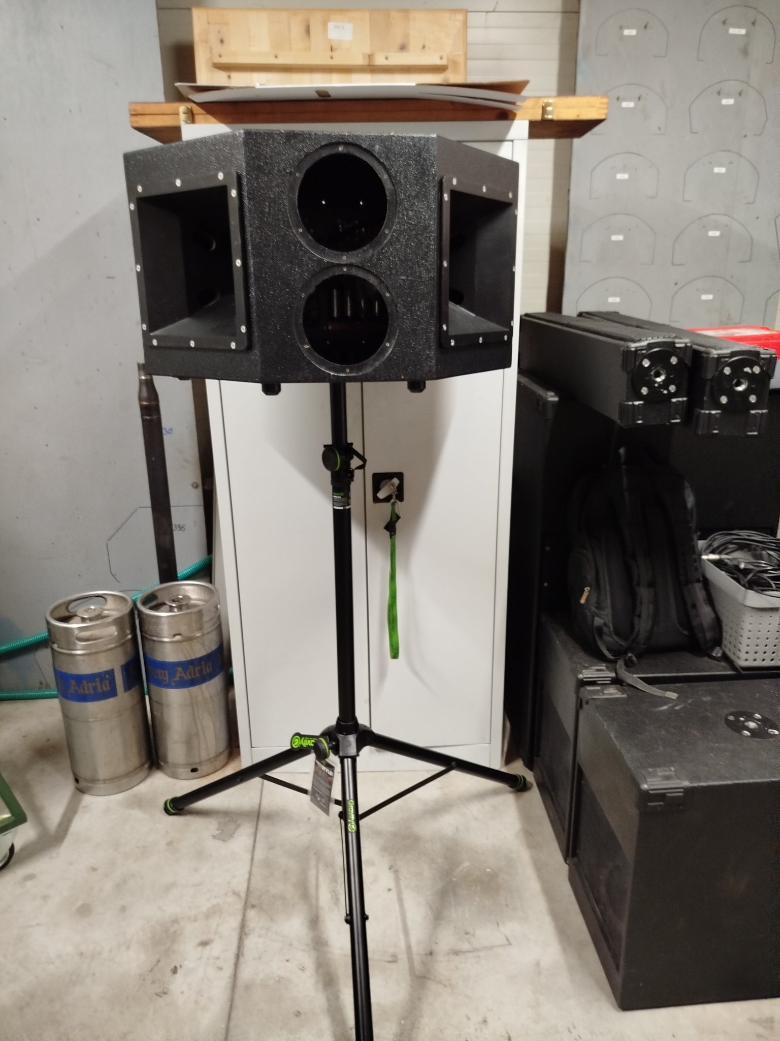

After I attached the flange, I tried to install speaker on my new adjustable speaker stand ("Gravity" SP 5211 ACB ) =>it seems that
the lowest available height is sufficient for most of situations, as it brings center axis of horn throats at 145 cm:
