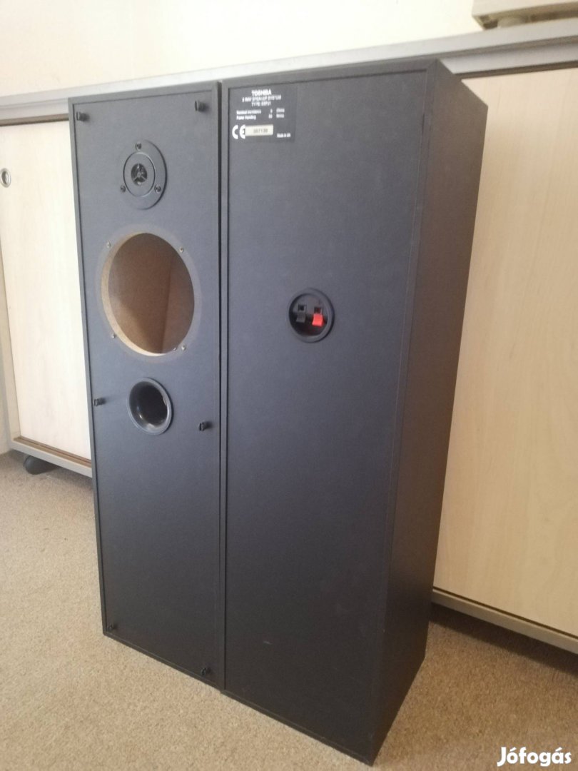

Here's a pair of Toshiba floor-standing cabinets (22) litres. It has been suggested that the volume be reduced by 8 litres for efficiency. The speakers sound okay but could do with a little more oomph. How about I add a couple of small subs to the system for bass reinforcement?
Akshally . . . I don't need to build new cabs because I know where there's 8 litres of real estate going spare. But if I'm going to do that I don't need the bass extension on the woofers. I can seal them in 6 litres leaving 14 for the sub driver.
Which all leads to the question that can't be answered using generally available formulae. Why seal the woofer? Why can't the woofer and the sub share the same air-space?
Because putting in a more powerful woofer with more xmax will translate to: you're forcefully pushing the membrane of the weaker midrange driver...

Somebody kindly sent me an article (which I cannot find) on different drivers sharing the same airspace. Long story short: Years ago I had a mobile disco with 2 x 12" Fane speakers. When a Fane driver blew I replaced it with a cheap alternative. The cabinet sounded so much better that I installed another in the other cabinet. The cheap driver had a much lower resonant frequency than the original driver.
The article intimated that the relationship drivers was extremely complicated but not necessarily negative.
In your conventional thinking (x-over @ 250Hz) the woofer has occasion to behave as pseudo passive radiator to the sub. But in a more literal interpretation of the woofer / sub-woofer relationship it becomes more interesting. Woofer 55Hz, Sub 30Hz
No musical note is a sine wave.
For example: a low note struck on a bass guitar. Both the sub-woofer and woofer are interested, moving forward. Under load, the woofer is unable to act as a passive radiator, it behaves as cabinet wall. Subsequently, the excess air pressure is sent to the port.
It's way more complicated than that but, hey, the basics.
Now let’s throw another kink into your venture.
Althou they will be fighting it, that box is going to perform like an ML-TL and not a reflex. A reflex modeler will not do a good job of simming them.
Given that, if you are intending them to be BR< putting some volume at the bottom to decrease the internal height would be a good thing.

It seems your thinking is limited by the flexibility of your simulation software. Let's not use the Peerless as a mid-tweeter and we use it as the bass-mid for which it was designed.
As suggest by the elusive article: take the TS parameters of the Peerless woofer.
Resonant frequencyfS42
Hz Electrical Q QES 0.50
Mechanical Q QMS 3.2
Total Q factor QTS 0.4
Suspension equivalent air volumeVAS24.2litres
And the TS parameters of the sub driver:
Resonant frequencyfS25Hz Electrical Q QES 0.22
Mechanical Q QMS 1.55
Total Q factor QTS 0.20
Suspension equivalent air volumeVAS68.6litres
Add the relevant factors together and divide by 2. Now tell your modelling software your cabinet contains two drivers of the new specification.

WinIsd software for modelling speaker CONSTRUCTION projects. It is not a tuning tool.
I have a perfectly serviceable 22 litre cabinet. Only a moron would build a new cabinet because the modelling software does not allow the user to manually change the length of the vent.
If I am in possession of two bass drivers of differing specs I am not going change the designation of one driver because the software cannot facilitate that particular scenario.
I have a copy of WinIsd. I wouldn't be asking the question if it had the answers.

You seem to be cutting off your nose to spite your face here...
Put your driver specs into winISD.
Tell winISD you have a 22 Litre box
Go to the vents tab and set the vent diameter to the one in your box.
Look at the vent length.
If you want to model a longer vent, go to box tab and lower the tuning frequency a bit at a time until the vent length is the length you want to model.
If you want to model a shorter vent raise the tuning frequency in the box tab until the vent length matches what you want it to measure.
A bit of a faff, but you'll get there within a couple of minutes, even a moron could do it
