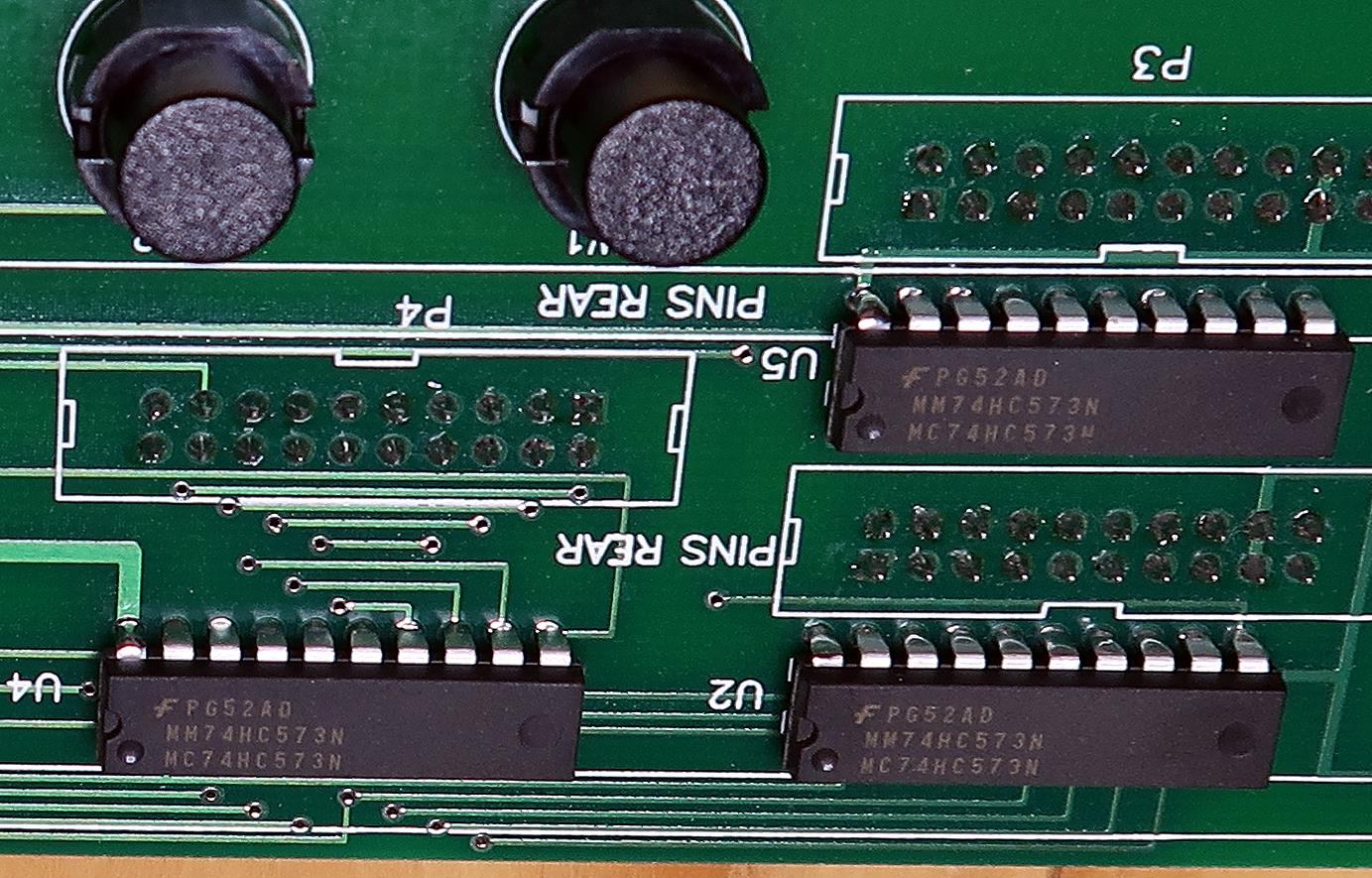

After a few quick tests, it way worse than just 'a popping'.
The first minute or two there is considerable static, popping, crackling.
After that, there is always a constant noise. Not loud, but its enough to notice with a small few watt test amp.
Turning the volume up or down results in soft but noticeable clicks.
Interestingly, tapping the top any of the relays (with my finger) elicits a sharp crack. Tapping anything else (boards etc) has no effect.
* I don't believe I'm tapping them hard enough to mechanically move the contacts*
At 'zero' volume, it is of course silent.
It is only the right channel affected.
Volume level and input selection make no difference.
Swapping the ugs and attenuation boards, the fault stays on the right channel.
I have not probed further until i understand how this beastie works. I do Not want to make it worse 🙂
Initial conclusion.
The fault lies in the main board or the front panel board.
At this stage I would suspect an I.C. on the front panel.
Especially as there are 2 ribbon cables that run from next to the att boards to the front panel board.
I am treating the relay tap as a possibly misleading issue caused by ham fists 🙂
Without further knowledge or info, I would throw my money on removing the front board, investigating the I.C's, and swapping out any switching ones.
Now to email PL....

Yup, the original Fairchild latches are nla.
U2, 4, 5. Fairchild MM74HC573N
I've just ordered some replacement latches.
Best match that is available seems to be this Toshiba TC74HC573APF

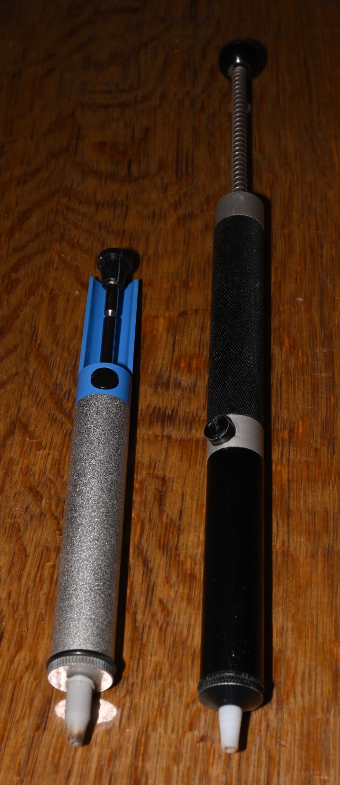

I use a solder sucker which is a pain but a reliable way of getting the job done. One of the spring-loaded syringe-looking doohickies. The trick for me is to make sure there is a glob of solder to suck out. If you only have a tiny bit, it is hard to clear the hole. Better off adding more flux and solder.
Also, give it some good heat so it doesn't cool off too much from the time you move your solder gun to the time you suck the solder out.
I also use a solder sucker. I have one which has a soft tip which is made of silicone. It can make an almost airtight connection to the hole. Then it can create some "vacuum". But it has to be done fast after heating (not every time I succeed first time). It seems that 99.9% of solder suckers are with hard PTFE tip today. Difficult to find with silicone tip.
Probably prof. de-solder tools which can heat and suck at the same time exists.

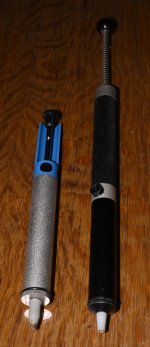

I have those two type at picture. Left one has the soft silicone tip. Right one has hard PTFE. It is very powerful and almost a bit "violent". A good thing is that the handle you push-in to load it comes back after load so you don't get "knocked out". I remember older types where it stayed in and you could get a hard knock 🙂
I have thought about getting some silicone horse and cut a piece for at spare tip to put on but then I don't get the "toe-in" at the tip but it might work.
If you find a link to the soft-tip types I would like to know 🙂
