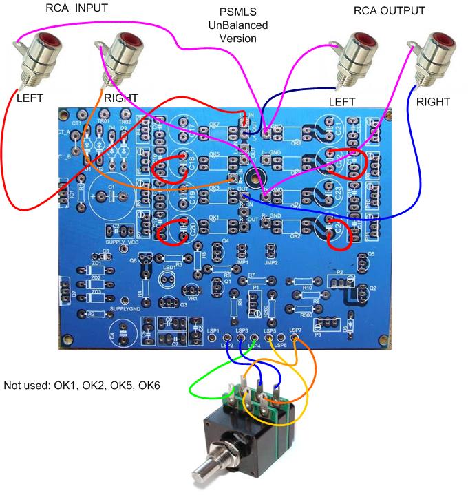

PSMLS PCB01 UnBalanced (RCA) Wiring
Today is a sunny day, so here comes some more pictures.
First one is how to connect/wire PCB01 for UnBalanced use.

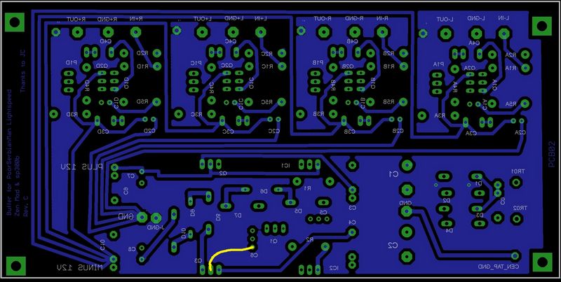

PCB02 Buffer PCB needs correction!
UUUPS....Mistake been found on PCB02. 🙁
Thanks to acidbrain for informing.
C6 & Q3 (Collector) needs to be connected.
Yellow line shows where short solder piece of insulated wire needs to be connected.
Sorry for this.:shy:
