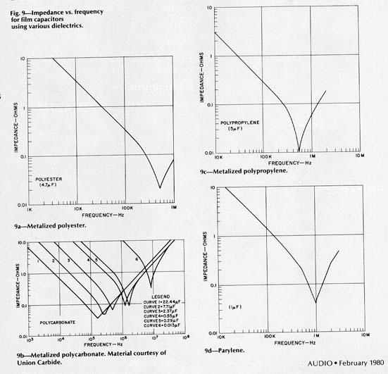

Also, a 5pf capacitor paralleled across the main ~55ufd poly caps to the full range driver is also heard.
Adjusting a resistor by 1 part in 4.1 million (a pot across a fixed resistor combination in
the crossover).
Going essentially all polypropylene capacitors opens up a whole new world in reproduction.
Caveat: My entire system from DAC through speaker crossover is polypropylene decoupling except the
amplifier B+ supply to the output tubes (bypassed with poly), and the cathode bypass capacitors.
If possible, I recommend going as much poly capacitors in the power supplies as possible.

Polypropylene capacitors have a DA of ~ 0,02%. ESR and Inductance are mainly determined by the winding/termination techniques. The decoupling capacitor in an audio stage is directly in the signal path.
Attached below are graphs showing the resonance of typical electrolytic capacitors and poly type capacitors. Notice the electrolytic capacitors tend to curve much more than the poly types which tend to be more straight lined, much higher Q. After bottoming out, internal inductance becomes dominant. Electrolytic capacitors cause much more masking than poly type capacitors. That is why the exceptional transparency I posted earlier.
