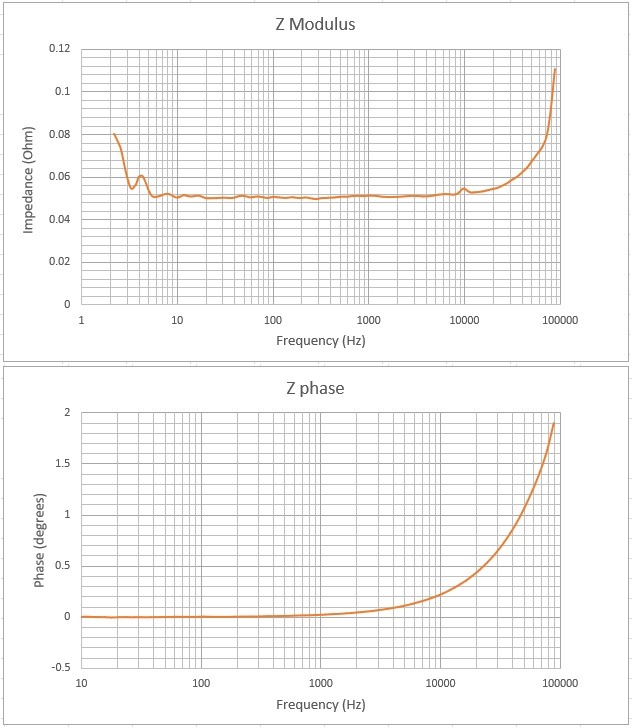

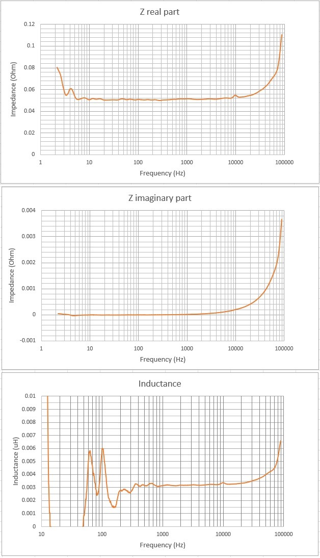

I am amazed that there is still so much voodoo & pseudoscience regarding speaker cable.
I still say > Buy the heaviest gauge OFC (now with good dielectric) you can afford.
If you feel the need to introduce C , L or R , you can add it with cheap components.
It also amazes me just how many people are apparently confused regarding AF vs RF.
The "Skin Effect" of heavy gauge OFC would amount to .1 dB at worst in the audio band.
( obviously I'm not talking about 50 meter cables )
Not to detract from Jan's point, but skin effect causes a frequency-dependent resistance in cables, which can be avoided by using multi-stranded cables, each strand being sufficiently fine.Heavy gauge mains cable used as a speaker cable is the most neutral and uncritical 'speaker cable' you can get.
Jan
So I wouldn't use heavy gauge cable for audio frequencies.

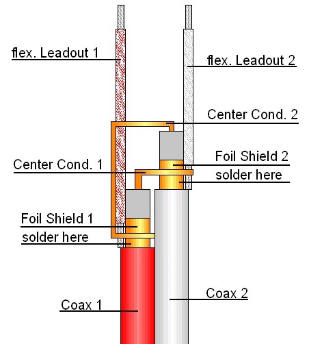

With much respect to Jan, I find coaxial speaker cables sound better in RF-polluted environments such as city centres. I like these: https://shop.sommercable.com/en/Cab...utsprecherkabel-SC-Magellan-SPK-440-0201.html
for pretty well everything above 160 Hz (my crossover point of choice).

Are you aware of the frequency where this becomes into play?Not to detract from Jan's point, but skin effect causes a frequency-dependent resistance in cables, which can be avoided by using multi-stranded cables, each strand being sufficiently fine.
Skin effect is a non-issue in speaker cables. It does exist (of course) but invisible for audio.
To @DSP_Geek's point, yes speaker cables can and do pick up RF pollution.
A good amplifier has provisions to avoid ingress into the amp and the feedback circuit.
As was mentioned before, get a competently designed amp instead of trying to fix it with speaker cables with no guarantee that it actually helps.

If you have a couple of hours to burn, you can build this speaker cable.
Two cross-linked coaxial cables
https://www.tnt-audio.com/clinica/ubyte2e.html
Good quality 75 Ohm satellite dish cable (*). Solid copper center, thick copper braid+copper foil. Foam or hollow dielectric.
Very low inductance, almost no capacitance.
Attached measurements are for 2.5m of this dual-cable loop.
Immune from antenna (RX/TX) effect.
George
(*) In my area I can get CAVEL Sat 752 cable for close to 1Euro/m

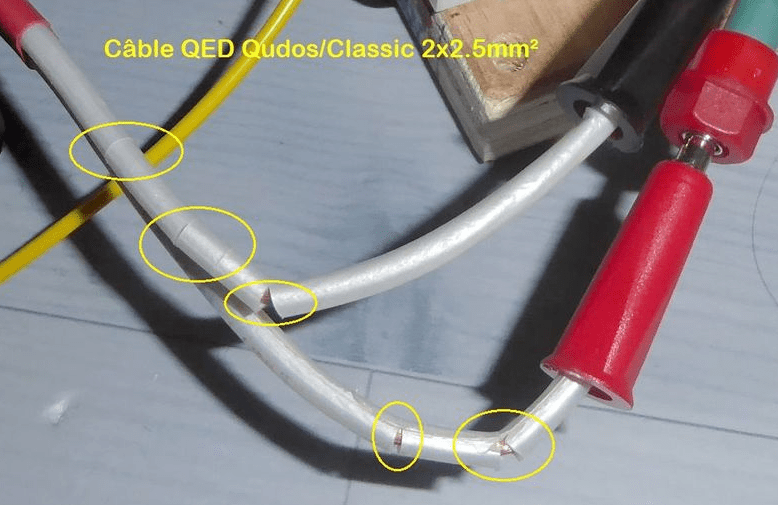

Here are the loudspeaker cables that I use - pretty cheap and quite standard...
From the cheapest to the costiest :
They all share the same parameter : 2.5mm2 section, and all are fine for me. For the rest, I must confess that I'm not very obsessed. That said, the QED have a problem of stiffness, making cracks in the sheath - that's why I discard this model now.
My possible preference would be the Van Den Hull Clearwater and the Real Cable BM250T, just because of the spacing of the conductors, which reduces inductance and capacitance of the cable, nonetheless already very small, by the way, even with the other cable models above.
T
