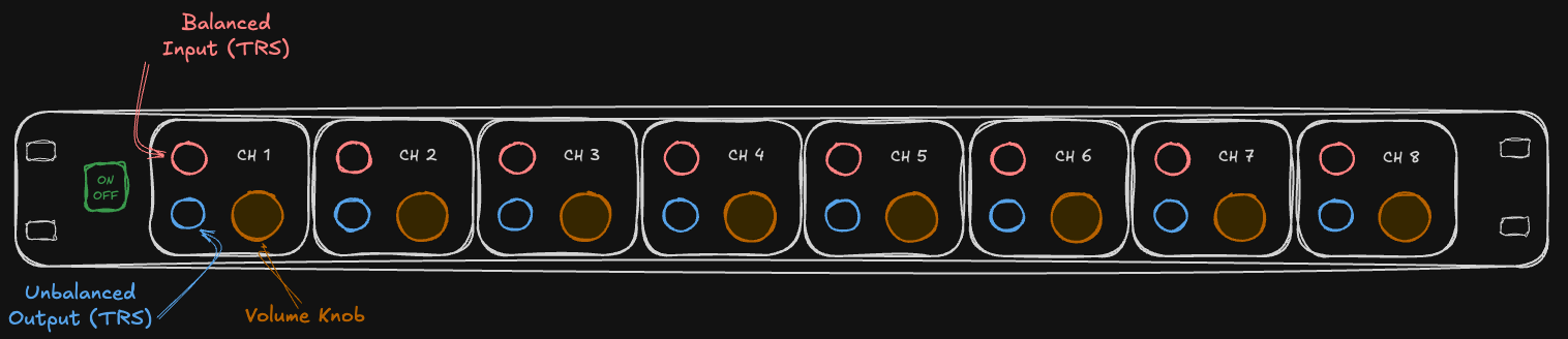

Poor man's Behringer HA8000 (8 headphones amps in parallel)
I have put a prototype together here, but before I turn it on, I have some questions:

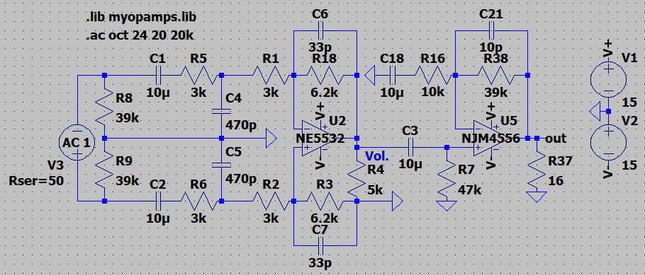

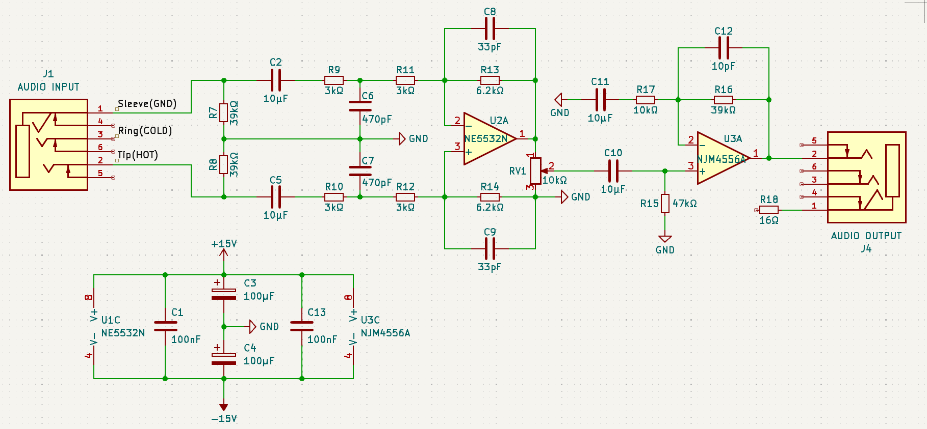

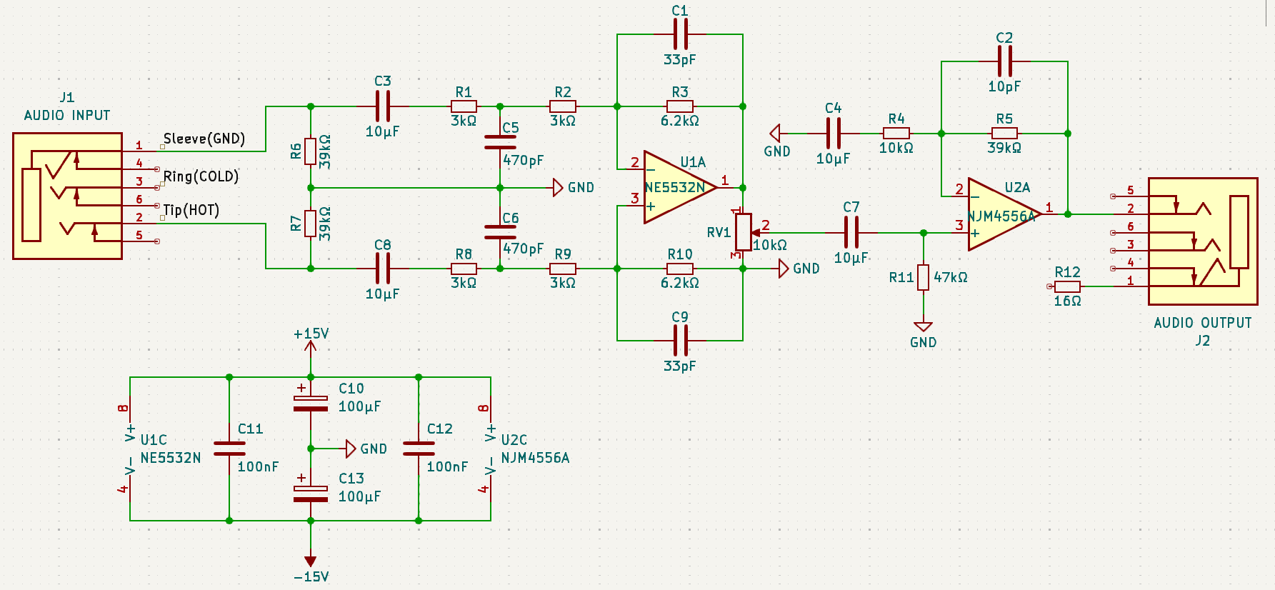

So, I changed my approach and made a prototype using direct connections. I tried to reproduce the following schematic as close as I could:
Here is the result:
The red wire is +15v, the blue is -15v, and the black is ground. The input is on the left, and the output is on the right.
First the good news: it works. I put the audio source at the minimum volume (the FM radio, for now) and it managed to amplify that sound.
The bad news now:
  1. With the input unplugged, it makes a really loud noise, which is odd since everything is grounded.
  2. The amplification is too low, I turn the potentiomer until its end and it is still very low.
  3. The potentiometer direction is inverted.
  4. When there is no sound coming from the source, but with the plug there, I can hear a "humm", it is annoying but not very loud.
Can you please check the schematic again? Many thanks.
Noise may be high because the circuit is bare.
The noise may disappear if it is housed in a metal case.
Is there a suitable metal case (to be connected to the GND of the circuit)?
If not, simply placing aluminium foil used in the kitchen underneath may help.
Potentiometers also tend to pick up noise. Try connecting the metal shaft part to GND.
The gain can be increased by lowering the value of R4. However, noise may also increase, so first try the above to see if noise is reduced.

Does this work? It says it uses 4580 opamps.
https://a.aliexpress.com/_m0KrtjV
If you really want to DIY it, OPA1688 or OPA1656 can drive headphones quite nicely.

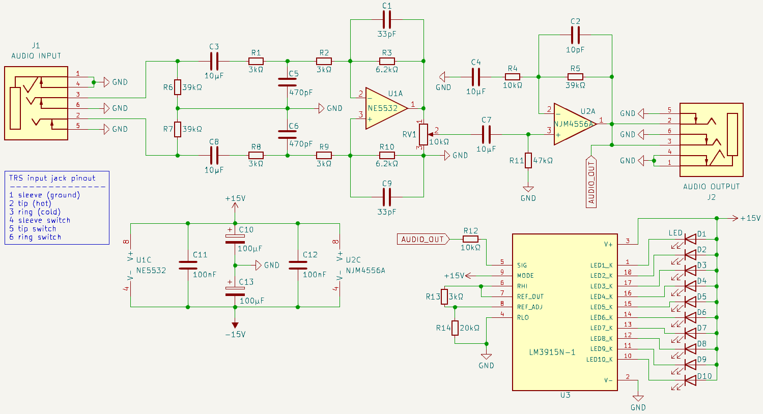

I am now focusing on the initial stage first, which uses the NE5532, as follows:
After reading this article https://sound-au.com/articles/balanced-io.htm#s3 I have some questions:
  1. I have a headset that I use like a probe to check the sound path, I notice that the sound is much quieter after passing through all those resistors, I suppose they are acting as filters, right?
  2. In Elliot Sound's article, the non-inverting signal (HOT, coming from pin 2 of J1) is connected to the opamp pin 3 and grounded. Why is there this extra feedback loop in my schematic? Is that because of the potentiometer?
  3. I made a small prototype using a breadboard (with no potentiometer, so the non-inverting signal is grounded, with no loop) and the sound coming from the opamp seems to have a similar volume as the the original input, but there is more noise. Why is that?

1 - The gain of this stage is ~1, it's just a balanced to single-ended converter, so you should get roughly the same level in your headphones whether you connect them directly to whatever source you're using or at the output of the circuit. No surprise that the signal is lower if you probe anywhere else in the circuit.
2 - There is no extra feedback loop: both the pot and R10 are connected to ground, there's no signal flowing from output to input at this point.
3 - See 1 above: this is what you would expect, same level at input and output. The gain is provided by the next stage. As for the extra noise, it may be coming from the power supply. You can try powering the circuit with a couple of 9V batteries and see if the noise disappears, then you know it's the PSU.
