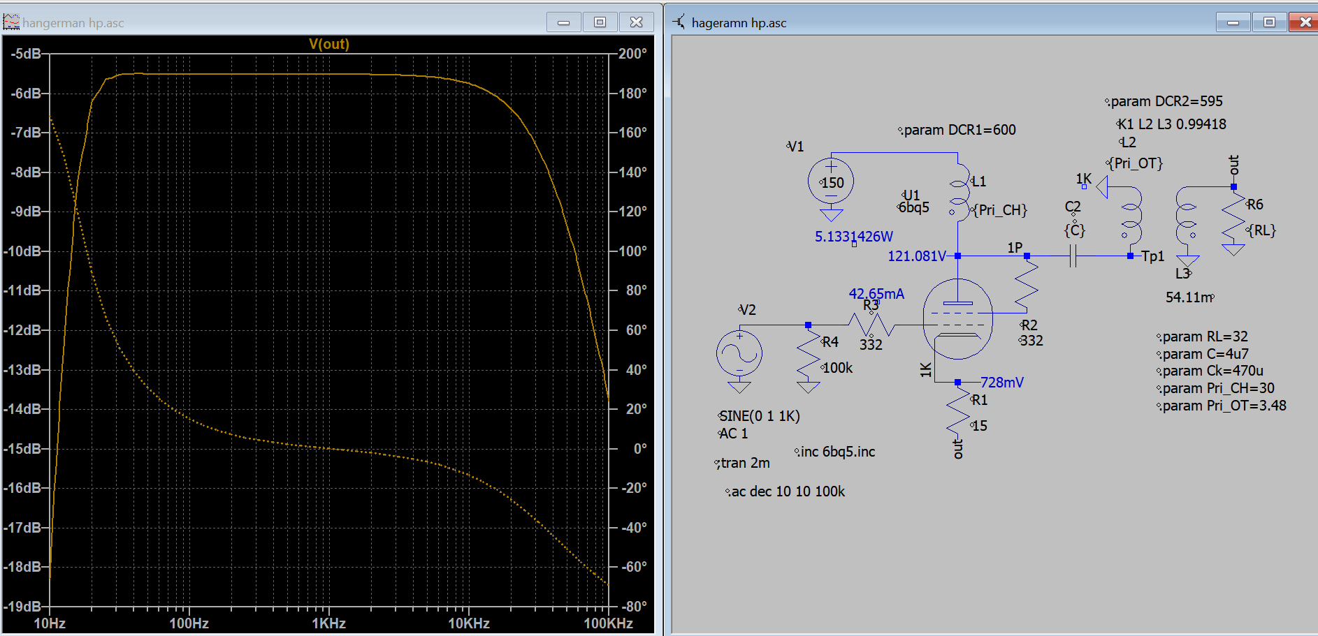

At a too light load, the tube is unable to produce low frequency signals and produces poor quality high frequency signals.
Global Negative Feedback makes saturated laminations go further into saturation.
Not a good solution.
Solution: get a better output transformer and a better choke, that are designed for an rp of 1700 Ohms. With equal inductances of the choke and the output transformer, they should work separately with rp of 3400 Ohms, so in parallel they will work with 1700 Ohms.
A simple way to look at the effect of not enough inductance:
A triode has dominant 2nd harmonic distortion (good or bad, depends on the beholder).
But that percentage (%) of 2nd harmonic is a constant versus a fixed signal power, if the load line impedance is constant versus frequency.
Load lines are commonly understood with resistive load lines. They are less often understood with inductive load lines.
The inductance of the choke and output transformer are in parallel.
For the fundamental of a bass note, the inductance has a lower impedance that the tube rp has to drive.
For the 2nd harmonic of that same bass note, the inductance has higher impedance that the tube rp has to drive.
That is like a lower impedance load line for the fundamental,
versus
a higher impedance load line for the 2nd harmonic.
So, the percent (%) of 2nd harmonic distortion is larger than it would be with a single (constant impedance) load line.
Yes, perhaps hard to understand, but true.

Low inductance doesn't necessary mean saturation ... the inductance is in parallel with the Ra , so at all frequencies it's effects shouldn't influence the value . If it's not high enough at low frequency the tube will work on a lower Ra , so the power will be lower .
More negative feedback is a solution if it will not sound like a cheap transistor amplifier 😀
Depanatoru,
You are correct. Saturation does not occur just because the inductance is too low.
But . . . the low inductive reactance at a fundamental bass frequency may provide too low of a load impedance to the driving tube.
And . . . the higher inductive reactance at the 2nd and 3rd harmonics of that bass frequency will cause increased output of the 2nd and 3rd harmonics, versus the original ratio of the fundamental to harmonics of the bass instrument.
That translates to higher harmonic distortion; put a bass frequency sine wave in, measure with a low inductance value, measure with a high inductive value, and see the results change of the harmonic distortion.

For the sake of experiment, try any smaller - for example 15-25VA - 230V: 18-24V toroid transformer as parafeed OPT.
You make some very good points here. Thank you. At this stage I'm not looking for an end-game amplifier (that is on the cards for some point in the future, probably based on the 45 tube). I have a lot of headphones, ranging from 25 ohm Denons to 300 ohm Sennheisers and a bunch in between. There are also numerous solid-state amplifiers, commercial and DIY as well as two tube amps (audio is such a slippery slope 😱!). The aim of this project was just a fun holiday build for its own sake that would be reasonably competent, not state of the art. What attracted me to the Hagerman circuit was the output transformer with high- and low-impedance options. I'm loathe to abandon it completely, and a new transformer is a simple approach to getting it to work.Matching a particular headphone impedance, and particular headphone sensitivity, requires both the proper selection of the output tube, and the proper output transformer.
Start with the exact requirements of the exact headphones, or else the performance will be hit and miss, especially if it is on a budget.
My current thought is a 10k:100 unit (with a centre tap, which equates to 6.4k with 32 ohm 'phones).
Ooh that's a great idea 😀! I think I have a suitable one somewhereFor the sake of experiment, try any smaller - for example 15-25VA - 230V: 18-24V toroid transformer as parafeed OPT.

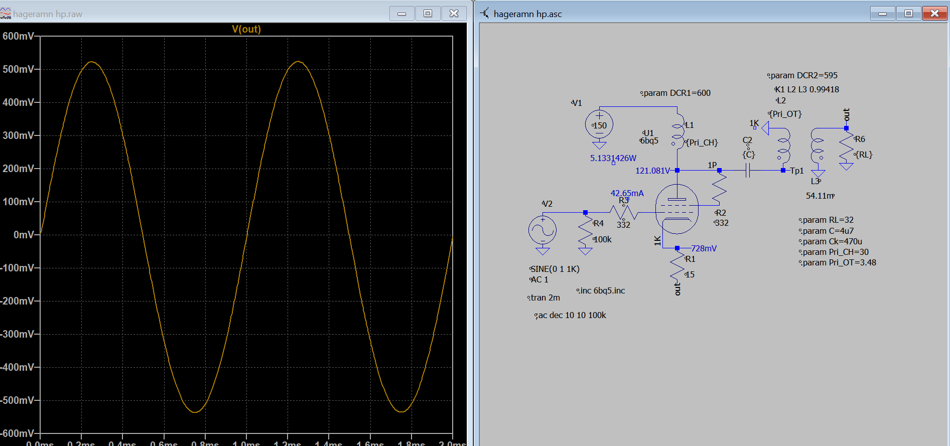

Things get stranger.
I haven't had a chance to measure the inductance yet (necessary gear is with a friend), but what I have done is checked the frequency response with different loads.
A 300 ohm dummy load showed no change in the spectrum from 32 ohm. I then tried 600 ohms. Still no change. Lastly, out of curiosity, I stuck an 8k resistor in. No change!
Does this mean the problem lies elsewhere? 😕
The signal transformer is still low ohmage by definition of its primary winding. This couldn't be changed by simple change of load impedances. It has low turns windings and will not convert to a high impedance transformer.
But I don't get the idea how this can work sufficiently anyway. Maybe try to contact Hagermann, this wouldn't be a multi million dollar company.

If the inductance is too low you can't do anything to correct the bandwidth 😀 , otherwise they would done it a long time ago , manipulating load is simple ... Only more negative feedback could made it more linear , or of course changing the circuit for a tube with a much lower Ra and so on .
As I said the inductance is in parallel with Ra , if it's small will shunt it more and more at low frequency , very simple ... No normal Ra for the tube = low power for those frequencies , like in your graph .
This is why any transformer will have a roll-off at low frequency , inductance can't be made infinite .
