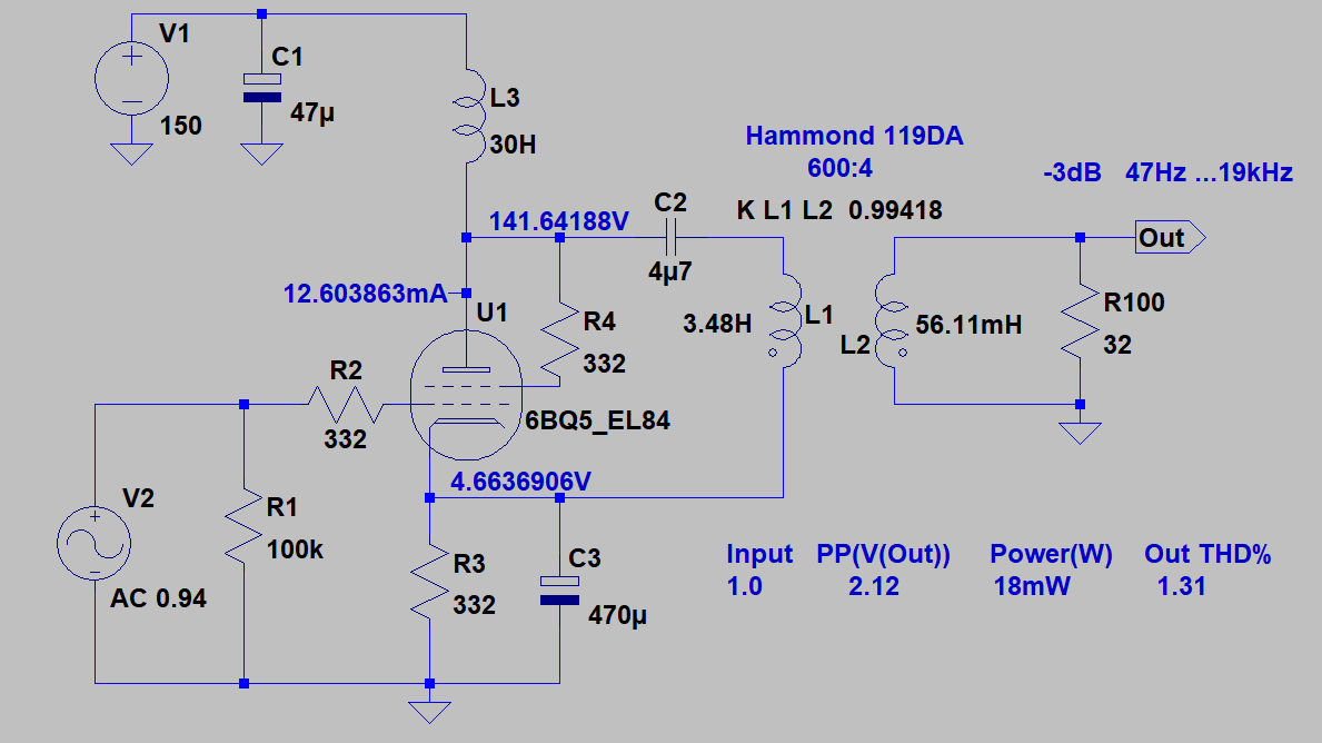

Here is the sims showing the shift of frequency response of the OT with different load and impedance compared with intended load and impedance. I hope this helps to explain the differences.

If the value for leakage inductance is correct in the simulation , about 20mH , then that transformer is very bad , not interleaved .
So you dont have low frequency and high frequency 😀 . This is hopeless , even by hand you could made a better transformer for audio .

K= SQRT( Lp/(Lp+Lsp) )?
Verified K:
{Leakage = (1-k^2)*L(pri)} ........................(B)
Lr=(1-0.99429)*3.48=0.020

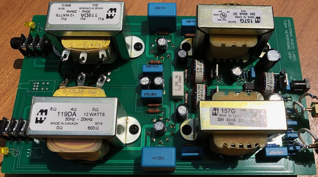

The coupling cap value for 30H and a 600 ohm OPT would be about 150uF.
The Hammond transformer that's chosen is a horrible choice. Get a little 5K-10K Edcor WSM line matcher instead. There will be a limit to how high the reflected impedance could possibly be with that Hammond OPT, and it won't ever be high enough.
Lsp = (1-k^2)*Lp
Lsp/Lp = 1-k^2
k^2 = 1-(Lsp/Lp)
k = SQRT( 1-(Lsp/Lp) )
or
k = SQRT( (Lp-Lsp)/Lp )
"BTW where does this term come from?
K= SQRT( Lp/(Lp+Lsp) )? "
Thank you for remind me. k = SQRT( (Lp-Lsp)/Lp ) is what I seen in LT tutorial before, can you verify?

Brilliant, thank you so much! I'll put the numbers together this week when I have a gap. This is really useful.In order to check the frequency response of an output transformer:
Hopefully, you will now find the true frequency response of your output transformer.

Yup. The moment I put the headphones on it was immediately apparent that all was not well. *Not* subtle.I think spec is clear enough and a headphone amp with no bass will quickly get a bad rap these days.

Since this is a spud amp, 10K:600 is probably a reasonable choice. A 1uF cap between your 30H choke and this transformer would probably be OK.
I still feel there is something being missed. It is possible to regap the 157G for higher inductance, but the 119DA is the weakest point. Puzzling.
157G has 30H/40mA , you can't do much since will saturate the core . The DC is passing through .
But the output transformer doesn't need air gap so you could dramatically increase the inductance , maybe from 3,5H to comparable value as the choke . Or with a good transformer you could have really high inductance .
I see. Perhaps the 119DA got an exotic core upgrade or something like that. Deducing from the spec, transformer primary should be > 4k.
So the OPT primary measures at a puny 800mH, open circuit. Waaay too low 😱. Going to experiment with some feedback while I wait for new transformers.

The solution was indeed a better output transformer - 5k with 150 and 30ohm secondaries worked out very well. Definitely not "hifi" but a fun little project 🙂.
