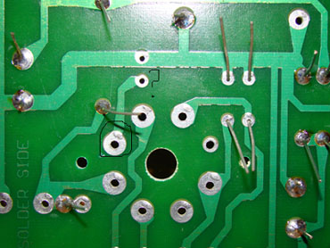

Brit01 said:On Bas's psu board:
What is pin 1's trace for?
If you look at post #587, Please locate Pin #1 for us. Then we can help answer your question.
Sorry, I don't get it....
Ron
Looks like the trace for pin 1 goes in close proximity to a ground trace - then there looks to be an provision for a jumper. I presume that this would be for using a rectifier that needed a ground for pin 1 ???
The 6X5 rectifier that I think most are using does not use anything for pin 1 so no worries.
On Bas's psu board: What is pin 1's trace for?
Some brands of 6X5 rectifiers have an internal shield, connected to pin 1, for grounding. Close the jumper if using valve with shield.
http://www.mif.pg.gda.pl/homepages/frank/short/064/6/6X5G.gif
