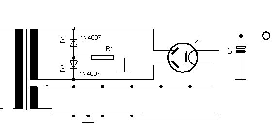

want to built PS for my preamp 12ax7: ~280vdc
i have 240vac transformer with no center tap
now i have only SS.
can i build this scheme? what is the advantage?
thanks
switching noise? that's it? maybe i don't understand:
A rectifier turns off and on. This creates noise which is mostly filtered out by your power supply caps. So that is probably not what you are hearing
now i have noise, 10mv
The noise is likely a grounding issue.
if the PS power on 1 hour, the B+ is more quiet with the 6z4 for example?
It does not persé make your amp quieter for your ears. It quite hard to explain.
