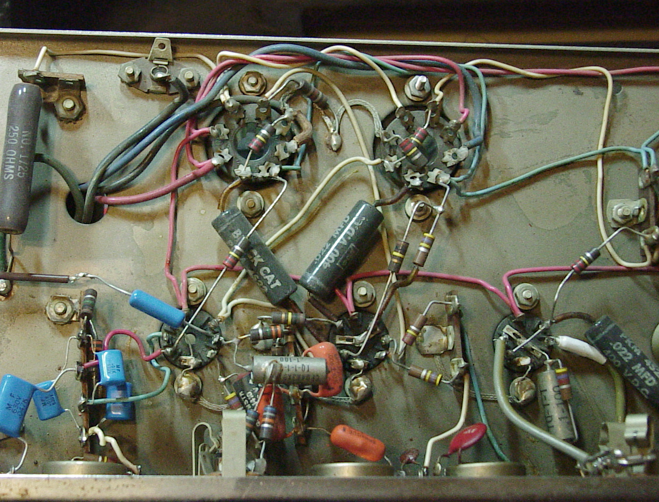

Here's an example:
see grounds taken where available, meaning straight soldering to chassis without much concern, shielded wire also soldered at random.

Juan, that is a great photo. I love the two 68k resistors at the bottom, soldered to the casing of that cap. And hidden behind that cap is a resistor, you can just see the end if it sticking out above the cap. Love point to point? Try changing that resistor.

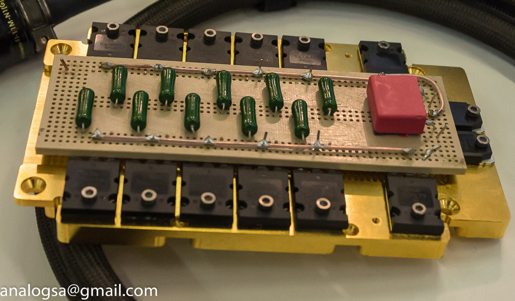

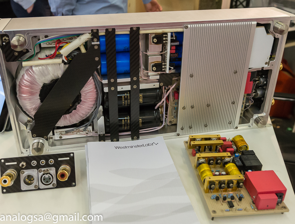

Crazy? Not at all. Let me introduce you to the products of Westminsterlab. Solid state, point to point soldered on perf board, although wire is just plain copper in plastic tubes.
Gold plated copper heat spreader under the outputs, carbon fibre supports under the trafo and caps. Prices vary between 32k and 66k gbp but you already knew that ptp comes at a price 🙂
