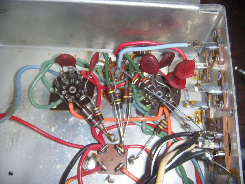

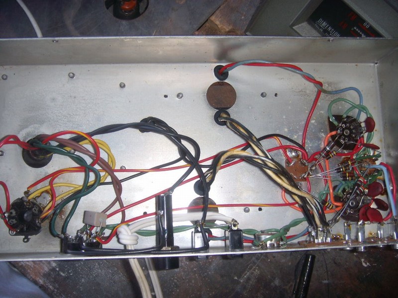

I picked up a console yesterday - nice little 'Chisholm' stereo SE EL84 power amp & PS with the usual remote tuner and phono preamp.
Though they did use the chassis as ground connection, the unit is surprisingly hum-free.
Have a look at the pics, and notice:
-spacious chassis
-power & AC at one end, signal and amp at the other

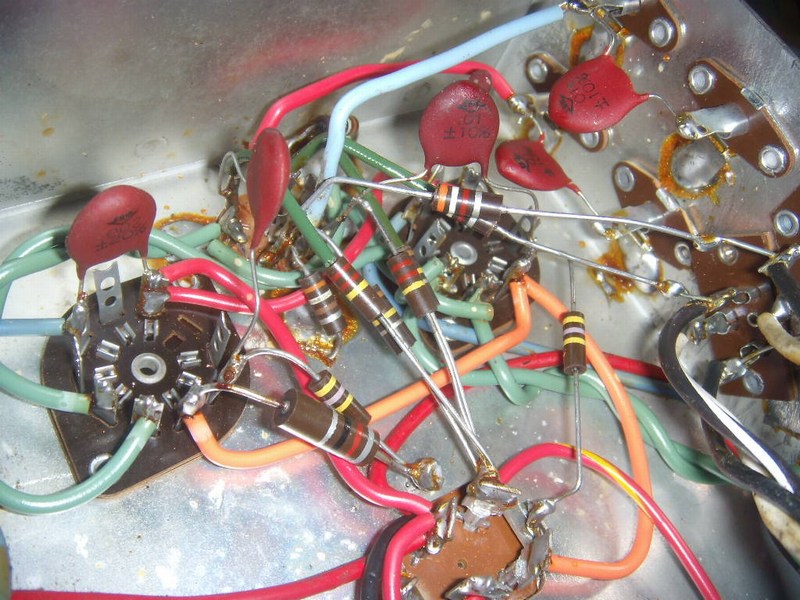

-no unsupported connections
-maximum use of the tube lug connection points
-inputs right at the preamp tube (7025/12AX&) - note the blue and red wires from inputs right to grids (no grid stoppers, but seems to work OK)
-lack of 'wire' used
-tight spacing on the 3 tubes so that resistor and cap leads can span the gap.
We can learn from those guys.....

If you want to do it "right" I suggest looking at MILSPEC point-to-point wiring. Take a look at some Tektronix oscilloscope modules for example. That stuff's tight! The contraptions you show don't offer much serviceability and as you build them you'll find that it gets harder and harder to get the soldering iron in there without burning things up.
The key is to plan the circuit out on paper first. Take a look at my 6LU8 Spud for example. I'll let you guess which channel was planned on paper first... 🙂
~Tom
Also the tubes in the first post seem a bit close together. Doesn't Building Valve Amplifiers suggest 1.5x tube diameter for spacing?
You may be correct. Remember that in a console the tubes are 'in open air' (like most modern diy stuff), not inside a case (e.g. AudioNote, Heathkit!)
The fact that this console has been in regular use for 50 years, still with the original tubes as far as I can tell, should say something to that issue.

Or not as the case may be. I cannot see much evidence of good wiring,
e.g. its good to run power supply leads in the corners of the chassis.
Good PtoP wiring layout is as important as PCB layouts, and one of its
advantages is it can be better, a lot better if the component layout
is determined by the wiring issues and not the other way round.
rgds, sreten.
I don't understand.
Except for the heater wiring, there is NO power supply wiring anywhere near the working circuit. Plate resistors come straight off the filter cap, it seems.
Which wires should be running in the corners of the chassis in this example?
I'm eager to learn- do you have an example of better wiring for a circuit like this (2-channel SE)? I need something to study.
Thx.
I dont understand this either, when laying out a PCB the importance of connections and connectivity determine how you place the components, not the other way round!
Build it as though it is RF, with short direct connections, as the valves don't know they are only supposed to amplify audio. Alternatively, copy a published layout exactly. Don't use long wires like a guitar amp, or tidy wires like military stuff.
