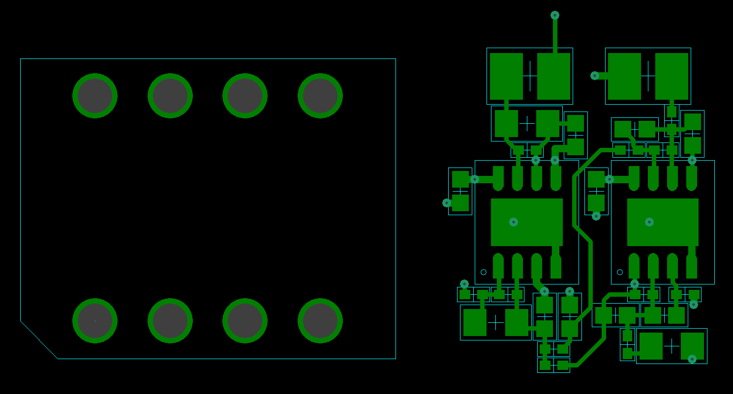

They are still being done today, though instead of a ceramic inteposer standard PCB materials are used (though usually a higer Tg grade), BGA's etc.
QPI-21LZ
One example with bottom terminations, others use gold plated semicircle s on the outer edges.
We did a coule of modules back in the days, the biggest problem was the difference in thermal expansion between FR4 and the ceramic, not so bad when they had through hole legs on a 0.1mm pitch, but became problematic as SMD apeared and sizes reduced.
They looked cool though especially if you had them hermeticaly sealed and gold flashed legs...
