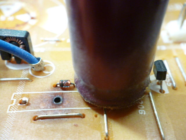

Here is the proof I'm so against PCB's.....this section of a power supply board, failed. The wirewound resistor despite being heat scorched still has the correct resistance; the fault occurred in the copper track which ran under it. After years of expansion/contraction from the heat, the track finally fractured.

looks pretty under rated to me, it also looks like the resistor was placed on the underside of the pcb and the heat has risen up to scorch the board from underneath.
Conceivably the designer has decided that cost was a serious factor and used a lower value OR that having the resistor mounted to the chassis or ontop of the pcb was too much of a hassle.
So even if he did rate the component properly he would have still screwed up on the fact that the resistor was on the underside of a pcb board, very strange behaviour indeed.

Well he said the resistor still had the correct resistance surprisingly after that much scorching you would think it would of drifted somewhat but the factors of age and time plus that heat expanding/contracting just weakened the trace etc

No. If it's a wire-wound, then the resistance may change only a very little despite the part reaching very high temperatures. The simple fact is that it got hot enough to burn the board and to apparently melt the solder joints (judging by their appearance) and that's down to the component rating and its placement.
Of course, it could be that it only got that hot due to a fault condition elsewhere, but that could also potentially have been anticipated and dealt with in the design. Again, nothing to do with PCB vs point-to-point construction.

That resistor while it might be in spec was under rated for the application (or something is wrong with the circuit) No one in their right mind would choose a resistor of low enough wattage that actually distorts from the heat. If they had chosen a higher wattage resistor, they wouldn't have damaged the PCB. I'm surprised the resistor isn't destroyed because it sure looks like it is.
In short, it is either a malfunction in the circuit, or a error on the designer's part. The pcb is fine,

....In the earlier post ..all the carping about that rather discoloured wirewound on the PCB; Here is the reason:-
The place on top side is occupied. A large electrolytic has encroached the footprint area of the resistor; the CAD library incorrect. Anyone should see the electrolytic would have quite a shortened life if the wirewound was "cosying" up to it.
Mistakes like this happen alot of the time even in the best of equipments and where series modifications are done without pad updates.

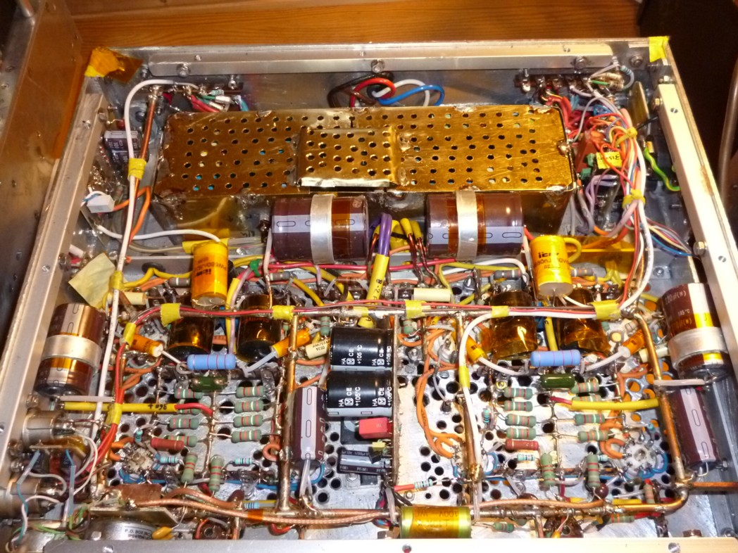

Three decades back....I taught radio & TV electronic servicing in evening classes twice weekly at the local tech. In that era, amateur radio HAM rig work was still popular using PTP and even with most guitar amps.
The two pics show for themselves the construction principles.

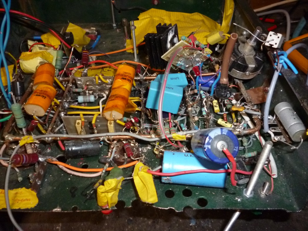

Still many amp constructors go for the short and dirty of prototyping PTP "birds nest" in a wooden box.
Compare with a pic of a decent PTP, the owner of this amp has taken care and trouble over the locations of parts etc. Centre PCB is heater supply. It is infinitely more reliable than the "birds nest".
Like doing it proper; then show oneself what one is capable of. Like a car; most want to see under the bonnet.

So the design was bad, not the PCB, if you can't see that a something like this going bad before you do the work on the PCB you likely shouldn't be doing them. Also I can guess that that PCB and likely design was made to be as low cost as possible just due to the 'simulated' double sided board wire jumpers, ie, save money anywhere including the designer.
