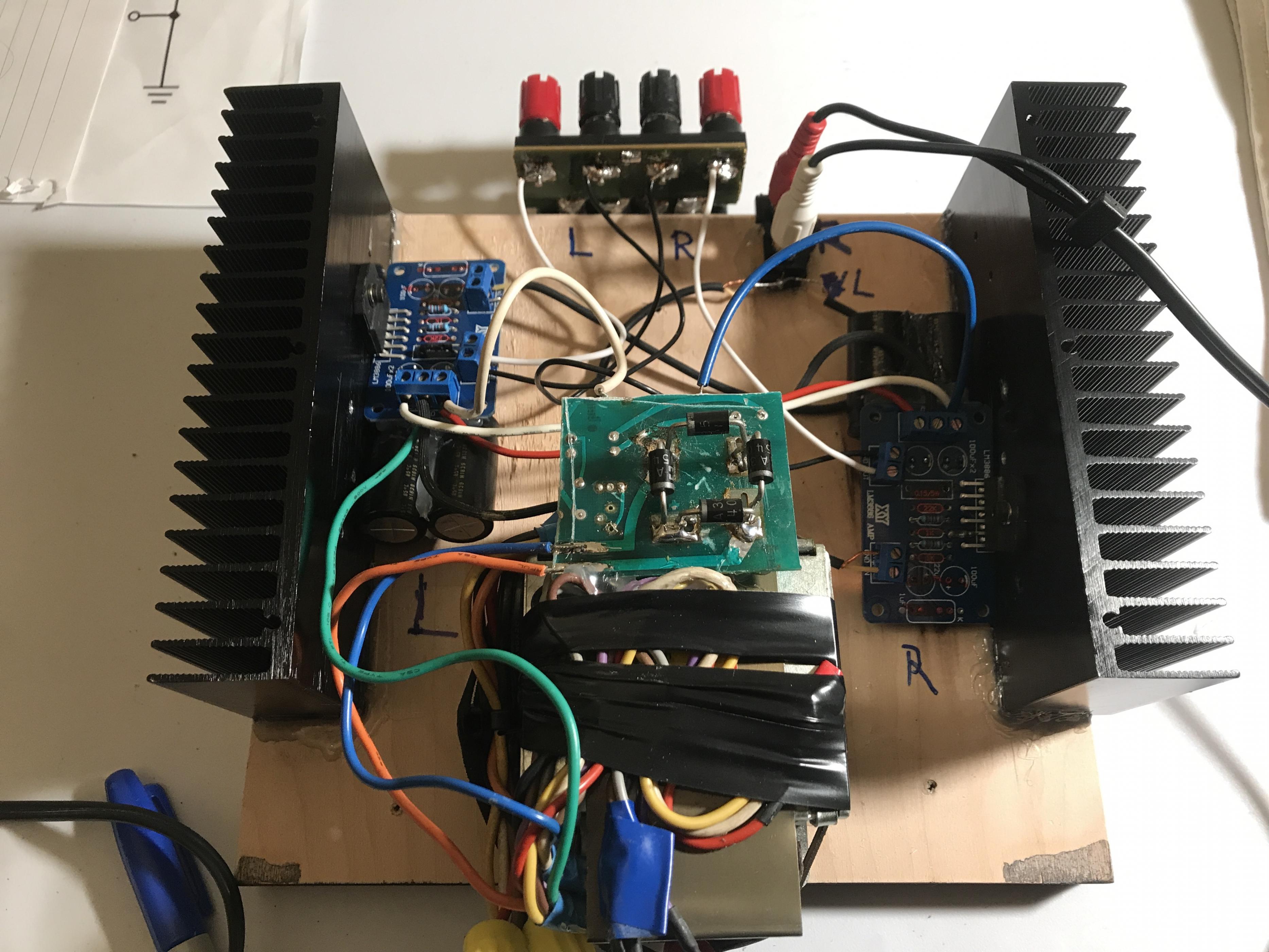

Well it is ot so far. The amp was built some 5 years ago when the whole GC chip amps boom exploded. It is supplied with Yuasa batteries and there is the charger behind them. The black power switch does not supply power (the circuit is soldered directly to batteries) but it switches the charger to batteries on anf off both negative and positive rail so when I'm listening only the batteries are connected to circuit. In the mean time I change all the wires to Cardas chassis wires, here with Vampire Cast copper ones. By today this GC is unused and the batteries are dead after extensive use for the past years. I'm more into class A amps by today. It is extremely important to keep the loop: negative cap/chip/positive cap as short as possible hence my pictures in this post. This makes the chip way stable and not reactive to capacitive loads.

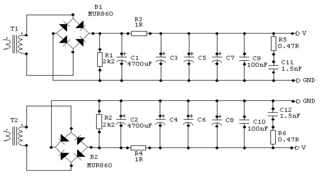

Impossible.Hi all,
I build this same amp and am wandering, some people do not use filtering caps at all
You DO NEED filter/storage caps in the supply under penalty of heavy unbearable 100/120Hz hum which makes amp UNUSABLE.
you CAN do that, why not?, but you MUST have main capacitors in parallel with LM3886 somewhere.and go directly from bridge to the lm3886.
Please show a picture of what you built, you MUST have filter caps in the supply rails.I did the same and although I does sound great, I want to know if someone did this and later added the PS filters and resistors to see if sound was better?
It does no matter where they are physically, all parallel connected points are at the same voltage by definition.
Sluggish?Does it become sluggish due to more circuitry?
Not sure what resistors you mention, but filter caps are indispensable.Is it asolute neccesity in having the filter caps and resistors?

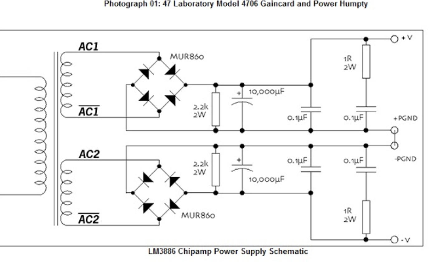

Attached is the schematic with two possible PS.
also project pic.
