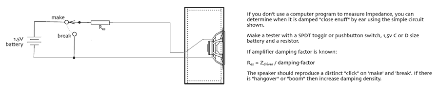

Some of us use the click test to decide how much lining or stuffing is 'just enough'. Normally for damping vents, but works just as well on sealed or if using proper measurement gear, then an impulse response can dial it in to technical perfection.
Use enough, but no more than necessary.

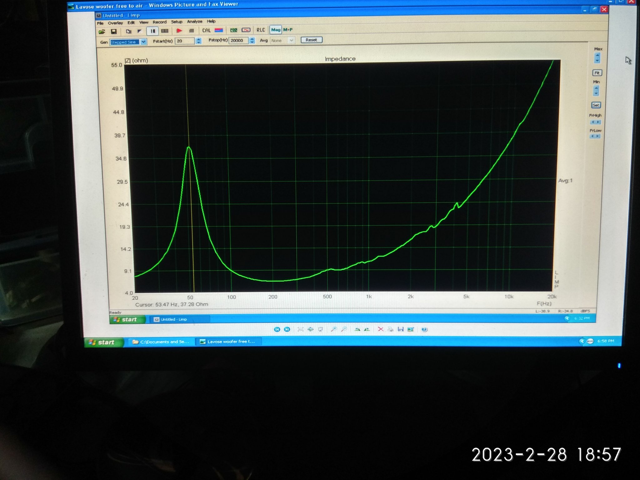

I haven't took a definite answer when i had measured mine Asathor.
I have used ARTA for impedance measurement.
What is better stuffing,yellow or green?
Second picture is a free to air woofer measurement
