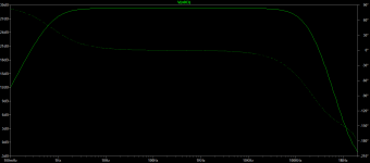

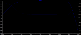

Hi Mark, looking at the following frequency and phase response of an unknown amplifier, is it likely to be stable or unstable ?
Under normal operating conditions, yes currently that looks like 0.000003volts DC
Ok, .... let me rephrase my earlier question. Is the ground reference of the non-inverting inputs of the operational amplifiers (the ones that execute the summing point of the feedback loop) sufficient to guarantee zero DC offset on the output of this amplifier?

There are updates to keep the phase margin at a safe point

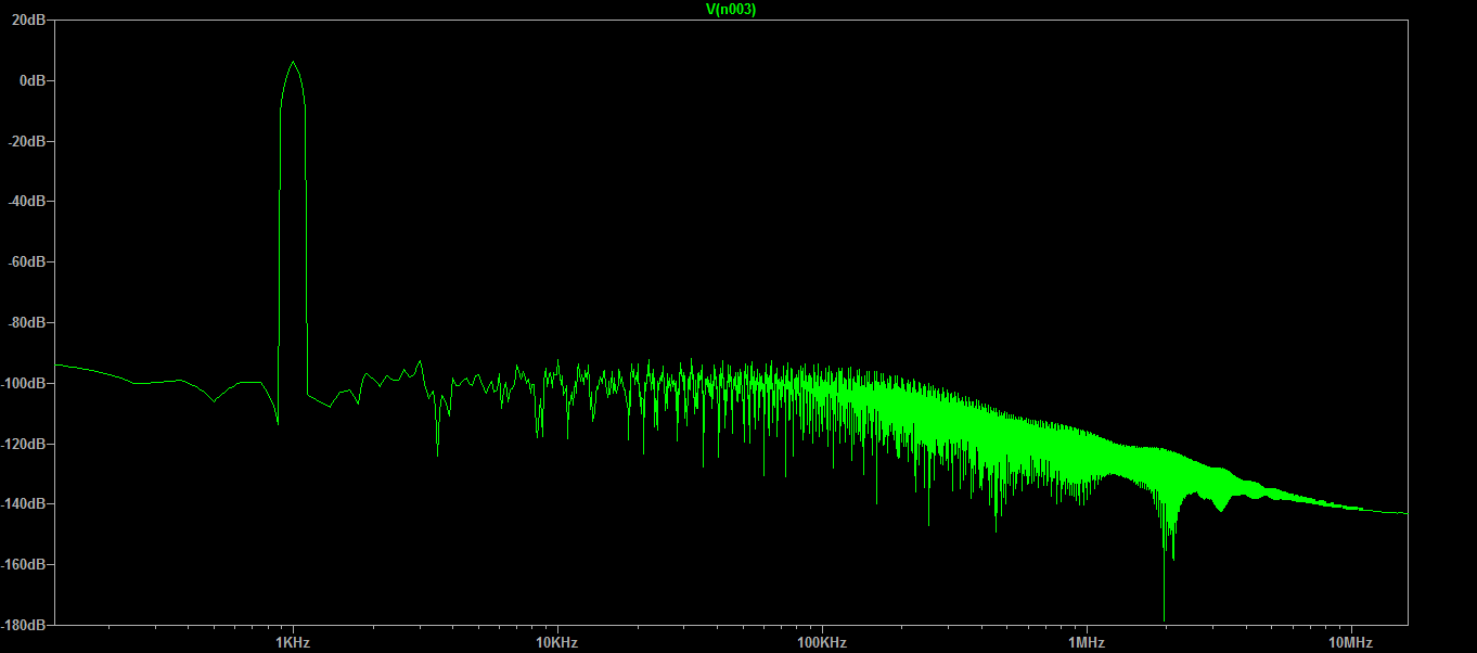

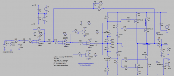

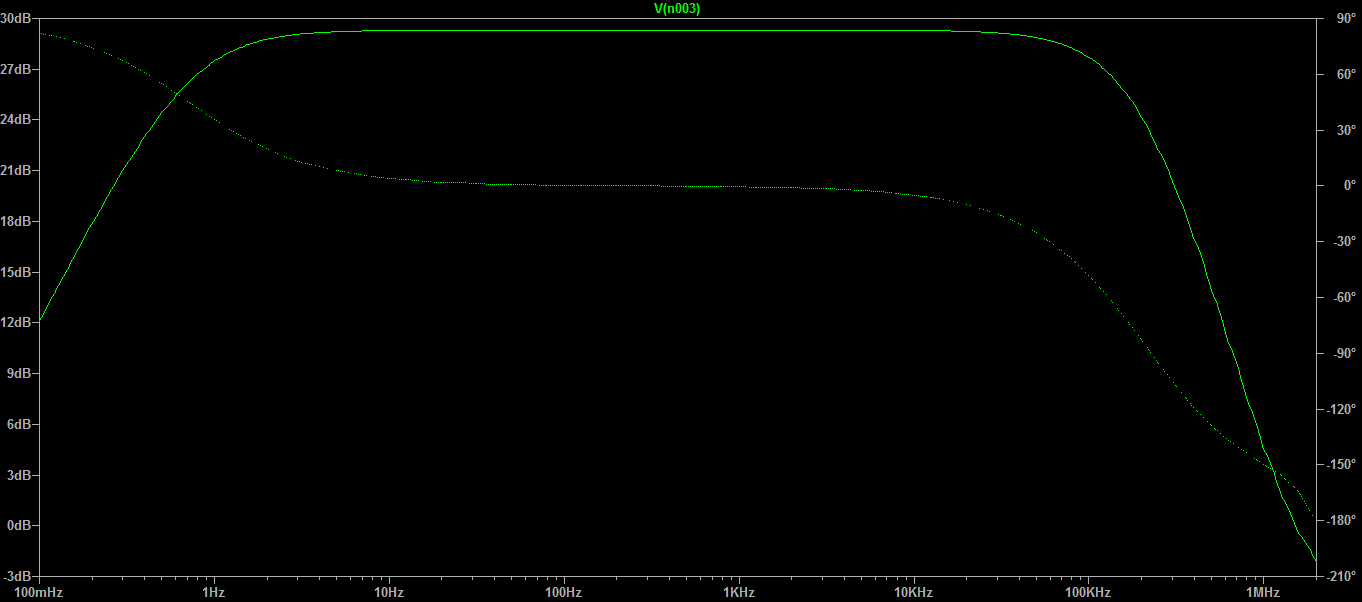

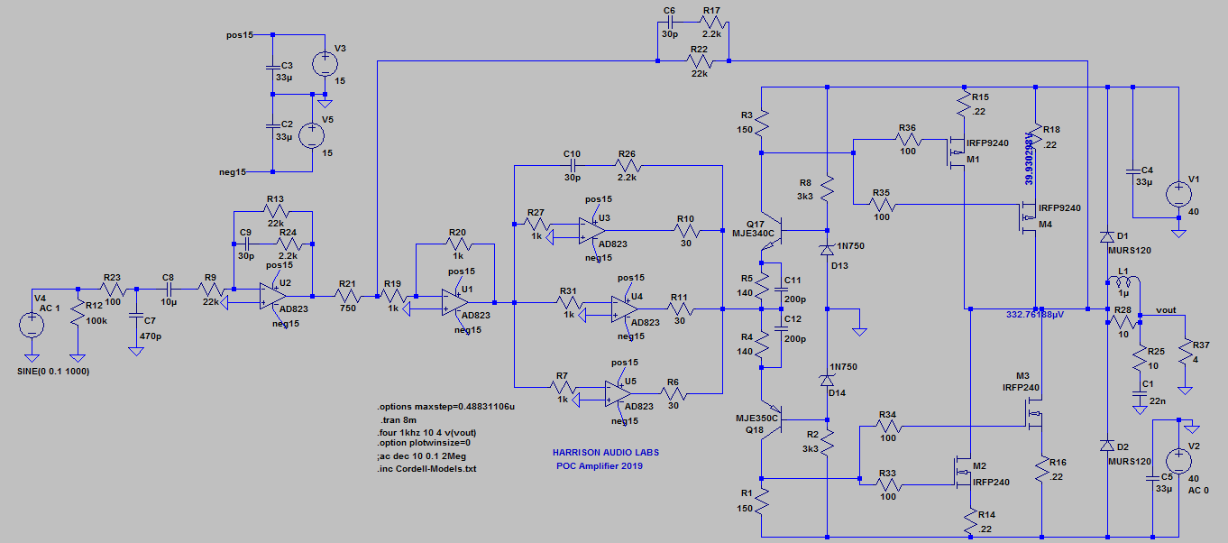

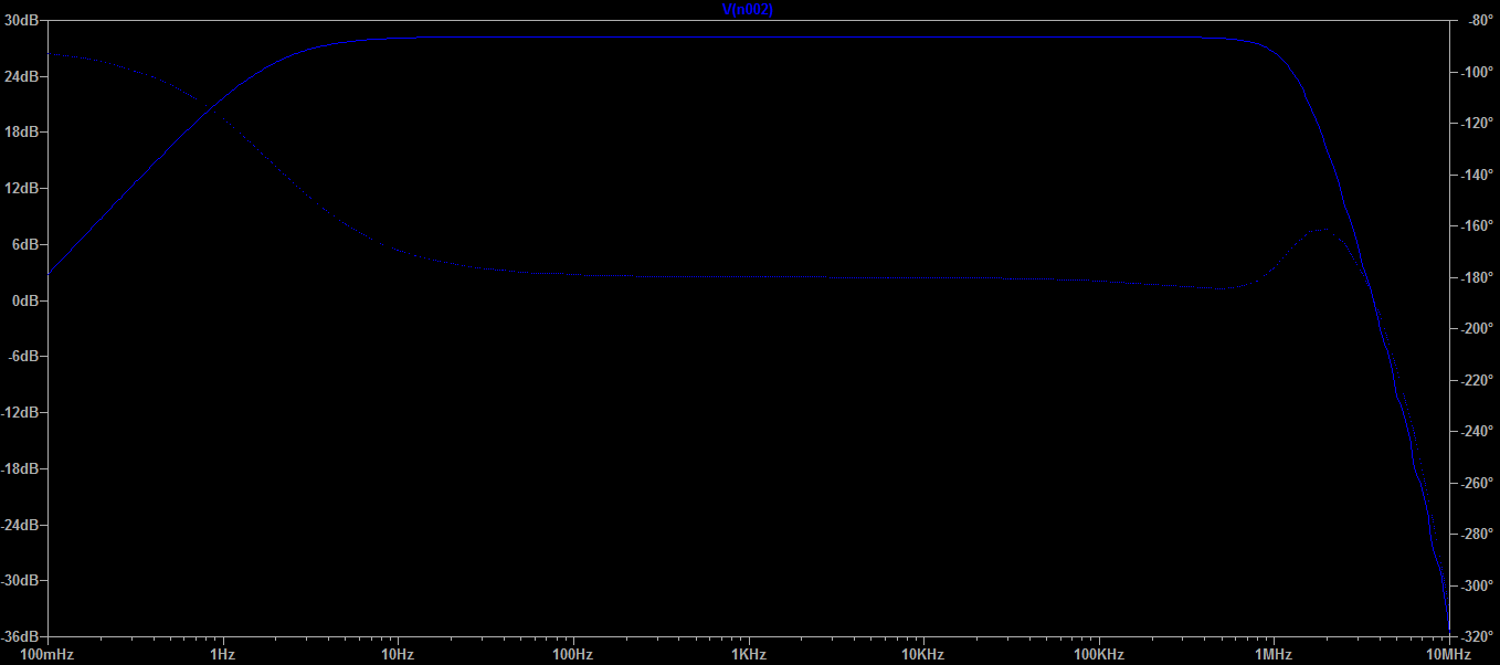

Thanks Bogdan and Mark, I set laziness aside for an hour or two, hope your happy now, even threw in a popular opamp😉
