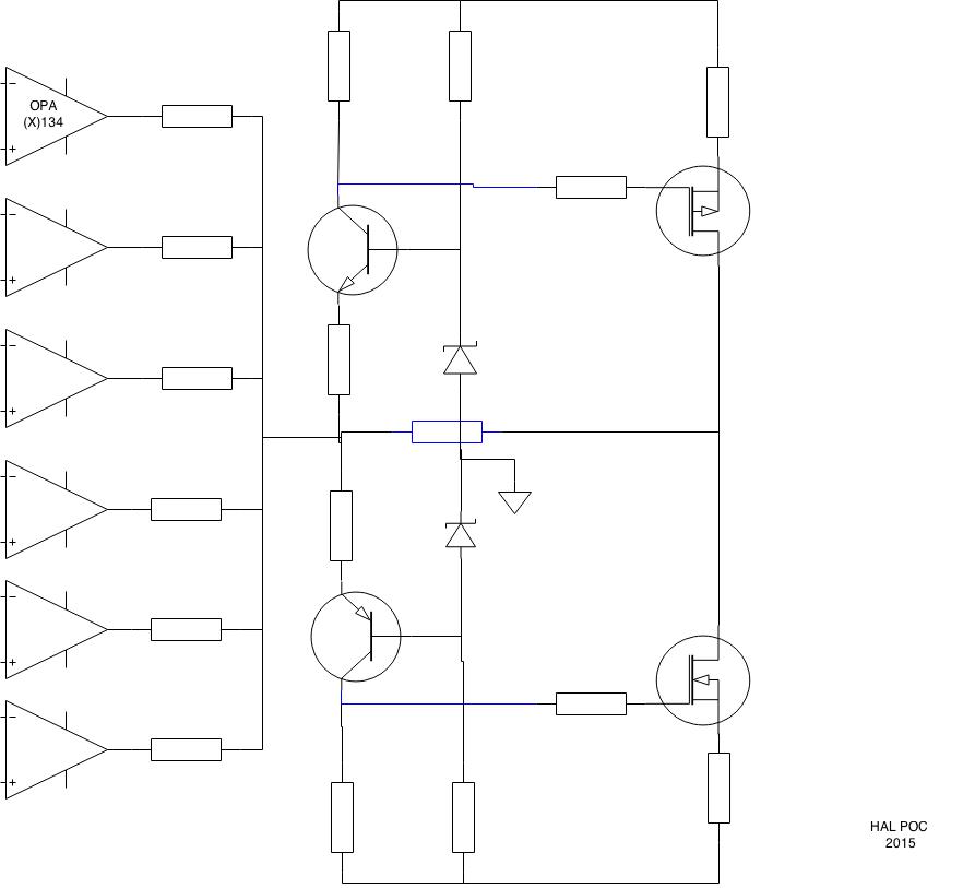

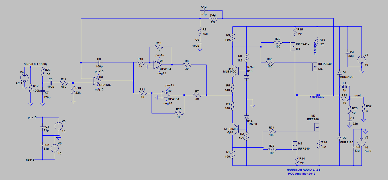

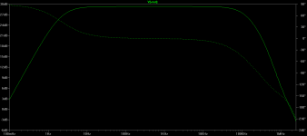

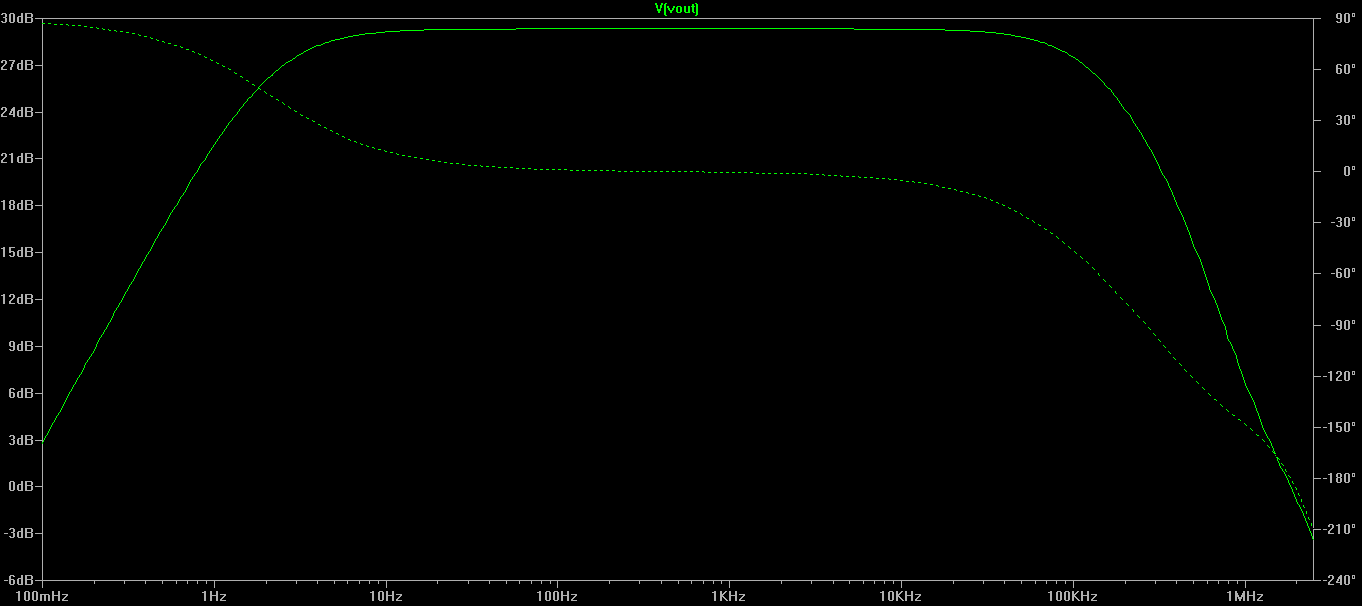

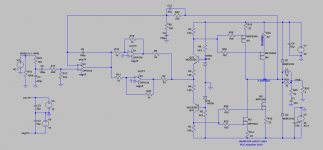

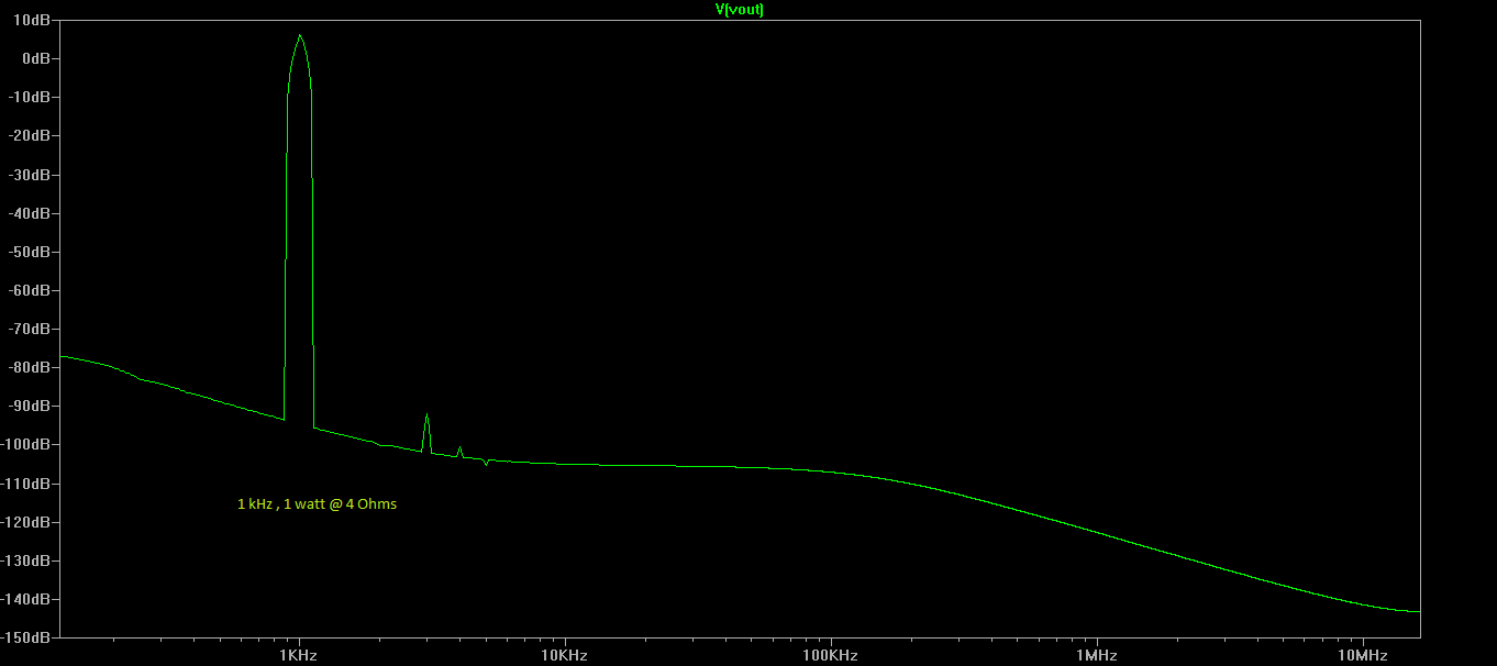

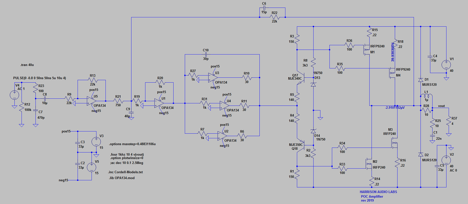

here she is, however were way off the purist ball park, and why not?
Diodes D13 .. D14. What do they do?
They provide bias as well as some noise for our fancy "LTP" and mosfets, the setup is such that we can do 10 - 18 amps with 10v GS at opamp clipping

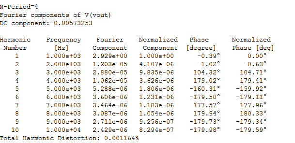

Under normal operating conditions, yes currently that looks like 0.000003volts DC
Ok, .... let me rephrase my earlier question. Is the ground reference of the non-inverting inputs of the operational amplifiers (the ones that execute the summing point of the feedback loop) sufficient to guarantee zero DC offset on the output of this amplifier?

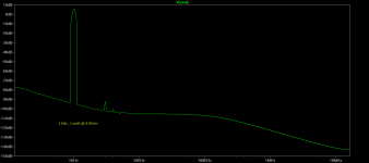

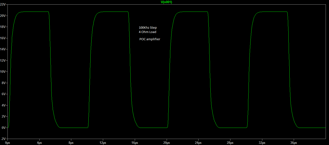

There are updates to keep the phase margin at a safe point
