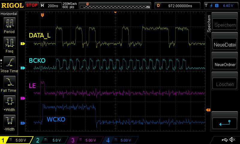

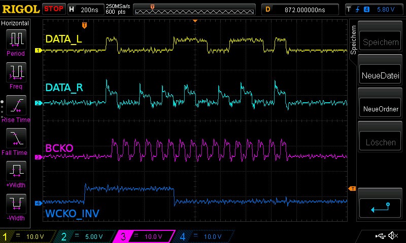

I tried hard but didn't get past the crackling noise. With probes at the TDA1541 the timing looks decent, see attached screen shot. BTW I had XTI@PMD100 = 256fs and BCKI@PMD100 = 64fs. With XTI@PMD100 = 384fs I still get BCKO = 256fs at the scope (I hoped for 192fs). Running the PMD100 in 4x oversampling mode (the latter requires program mode, but I am fine with that) would still result in BCKO being 256fs. So that would only help with additional glue logic which reduces the speed of the transmission between PMD100 and TDA1541: any hints about that...?
I used inverted WCKO as LE in this screen shot, but also tried various circuits with flip flops. How did you create LE?

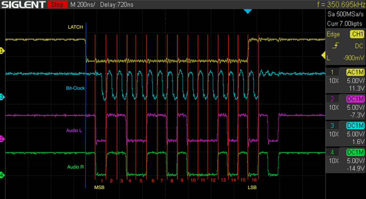

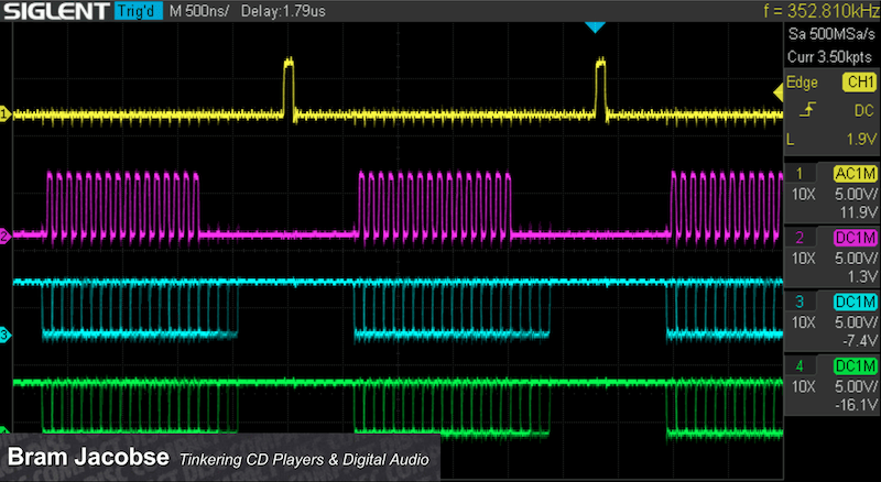

Latch just before the new word is clock in the DAC, Its the Deglitch Control clock from the DF1700
Audio_L&R Data format = complementary offset binary
The DF1700 puts out Data word of 20 bits long , only the first 16 are used ( clock in the DAC )
And I inverted bit clock,
I will try to delay the latch 1 clock cycle . later this week.
BTW the Display and spdif boards are not mine..🙂
Yes, I also used COB from the PMD100. I will try to get another TDA1541, maybe mine is damaged. Inverting the deglitch clock from the DF1700 should work as well: you would have the rising edge of latch after a stopped clock period, this could even sound better. I delayed my DATA lines in order to place them over the falling edge of BCK with flip flops as shown here. Same method can be used to delay LE: that would even provide a reclocked LE...
Left justified (not i2s), MSB first, MCLK = 256x, BCK = 64x
The PMD100 always outputs BCK= 256x regardless of the settings for input and output as far as I can tell. If your DF1700 configuration works it means that PMD100 should also work, right...?
