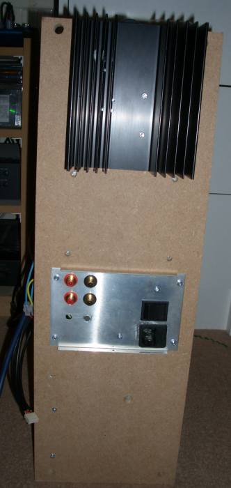

Heres a pic of the exposed side of the amp.

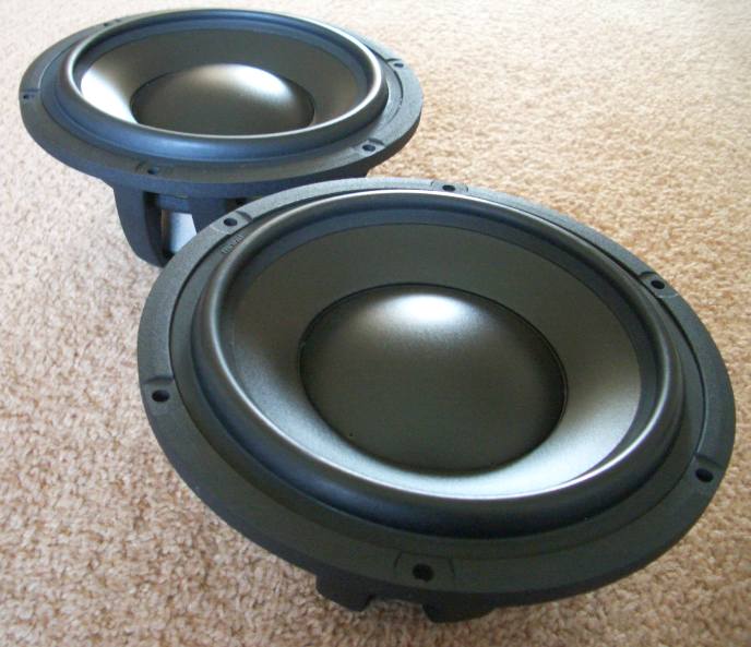

Hmm, well drivers arrived today. I'm not quite sure what to think yet, my initial impressions were that the mechanical handling was laughably poor but a few things are starting to show otherwise.
First test was run in free air as usual, doing this I had a bottoming out type noise at even VERY low levels but it soon became evident you must have these drivers away from the floor, ie not resting on the magnet; something to do with the vent mabye? Can't imagine why at these power levels (literally 1-2W out of the supposed 180W handling). Lifting them up improves it somewhat but you mabye get 1mm total Xmax before you get a sort of rattling sound, I did think it was faulty but both units are exactly the same. You are supposed to get 4.5mm linear each way, 9mm total. I next tried a good old cardboard box enlosure but its own rattinlg is uncontrollable so the only way I'm going to get any idea of what these can do it to fit them in the proper enclosure.
Perhaps they need an enclosure to keep them happy but I've seen many speakers run at high Xmax free air completely silently. Perhaps they need running in but this seems a bit of an extreme case? Or mabye they are just totally unsuitable and I've wasted a lot of money

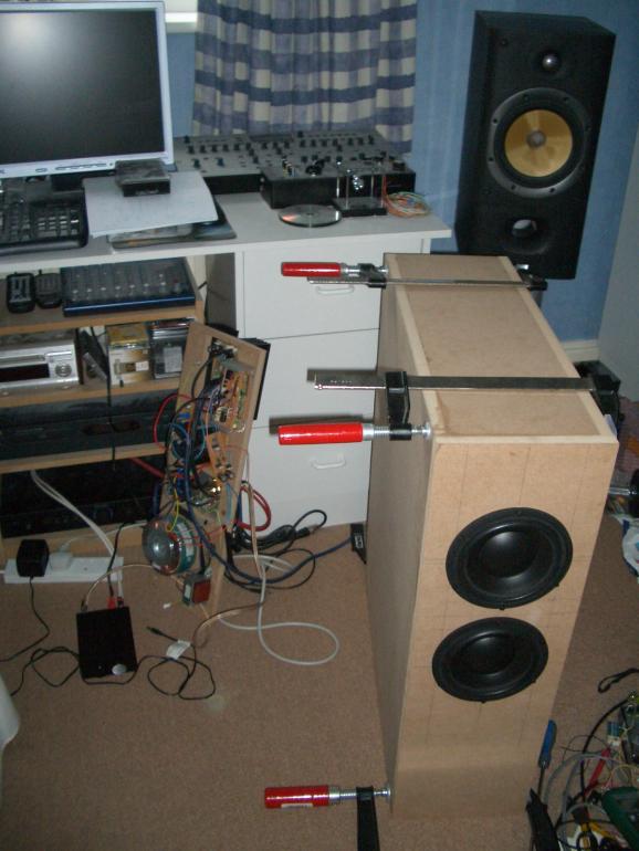

Oh yes, some pics too:

Oh dear 🙁
Its all together now, the side is merely clamped on though. I've applied some damping (lambswool) to the front part of the line mainly.
As an enclosure design I feel it works well, it can hit some seriously deep notes that I've never noticed on my DM602's, but my driver choice is evidently a poor one. In the case they handle as they did in free air away from the floor, obviously it's louder in the case but overall it achieves a poor output, the drivers start making unhealthy sounds before my normal (very moderate) listening level and "cranking it" just isn't a possiblilty.
You can just about see the drivers moving as they start to go wrong, certainly no where near +/-4.25mm Xmax 😕
I had heard about other/older Morel drivers having poor mechanical handling (here and elsewhere) but thought the new ones would be better and put a lot of that down to other peoples idea of "moderate". I actually don't know if mine are right or if I somehow got a faulty pair; they didn't come in manufacturers boxes and the dustcap on each has a small amount of marking (though that is possibly a consequence of the DPC process?). If anyone else has them I would be very pleased if you could describe thier performance!

I have never come across problems with Morel drivers, but I have never used that model. Where did you buy from?
They were from Wilmslow so I imagine its all as it should be. From what I've heard they are a quality company though a little overpriced (those drivers were better price than anywhere else mind with postage factored in).
It just seems bizarre to have 180W electrical power handling when the mechanical system can't handle more than 10W or so at low frequency (and low frequency response was a highlight of this model).

Hi, Dr. Em. Your project is an intriguing one.
Have you taken great care to ensure that the line is properly sealed? If any air leaks exist, then the line no longer behaves like a line, and instead acts like a very leaky sealed box, or an improperly tuned reflex box. You could apply caulk to the insides of the box, and remove some of the stuffing (if you're using any).

At the moment I guess it isn't. One side is held on with clamps alone so leaks are bound to exist (especially with only 4 clamps). It sounds good but the problem is poor driver excursion creating distortion at lower levels than I would want. The driver noise actually comes from the back opening in the line so must be emitted from the rear of the drivers only. Will a fully sealed line help this at all by loading the driver differently?
The side is clamped on while I adjust the stuffing. At the moment it is some lambswool behind the drivers and a tiny bit further down too, i'm likely to try more. Any ideas for good glue to hold the stuffing onto MDF by the way?

Actually, what I've found useful is placing a bead of silicone caulk along the outer edge of all the panels that form the line, as well as the outer panels, in order to create a seal between the side panel (which you say is just screwed on) and all the panels that form the line, so that when you put the side panel on, it self-seals. If you do this, be sure to take the drivers out, and let the caulk cure completely (usually 24Hr) before putting the drivers back in. The silicone caulk gives off gases while it cures, and these gases can cause the rubber surrounds to deteriorate. Also, caulk along all the joints in your box to ensure that everything is sealed and there aren't any air leaks. A transmission line actually generates quite a bit of pressure along its length that is enough to force air through tiny gaps.
As a side question, have you tried running the woofers at all without the side panel attached? I know there won't be any bass loading, and you won't hear any bass, but it's a way to rule out box vibrations as the source of the vibrating sound. Just start with the amp gain turned all the way down, and then turn it up slowly until you see the woofers having greater and greater cone displacements. If you hear clacking or vibrating, then just back down the amp gain. This is just to check that the drivers are reaching their own mechanical specifications. I'd expect those drivers to have a suspension-limited Xmax, since they've got such small surrounds. It could be that what you're hearing is actually vibrations from the enclosure itself.

Thanks for your replies 🙂
I reckon the box will be suitably sealed when the side is fixed. Like all other joints in the construction it will be fixed with a continuous bead of glue on every edge. I remember using bathroom silicone sealer on a sub some years ago, it still isn't dry 😱
I will try the drivers without the side panel attached, perhaps a strobe will help see whats going on. I'm pretty sure its them at fault though but wonder just how far they get pushed with impulse type sounds without me really "seeing" it. The surrounds are quite small but are oddly shaped in that they stick forward quite a way, if the driver was limited by them alone I would be perfectly satisfied with them. I can't imagine what else is limiting them mind, it looks like a well built and fairly long throw motor system.

I have 3 possible locations for my sub in my room. It'd either be forward facing on the left or right side of my desk or could be located facing the left wall (into a corner) placed lengthwise across the back of mk room. Only thing with that is the sound seems to dissapear when you get to the side/behind the drivers so forward facing is likely to work best.
I also realised that there are 4 mounting holes (for the amp) at the back of my sub. I need to place bolts through these to seal them too. I do kind of wish I'd used a seperate amp unit, mounting it to the sub is a bit untidy really. One of many things learnt through this project anyhow 🙂
Pic of unfinished sub. Once stuffing is adjusted box will be sealed and amplifier mounted before veneering and waxing to hopefully give respectable finish 🙂

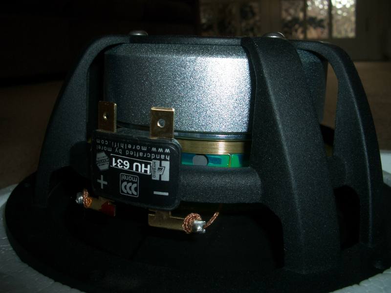

Playing with the drivers again since the box is being veneered now (side glued on at last after adjusting stuffing).
The rattling/distortion is definately somehow related to the pole piece vent. I was running it full range and experimenting, covering that vent immediately increases the rattling sound vastly. Obviously the noise is less evident when run full range as its masked by the higher ranges but as soon as you cover that vent you can hear it clearly over overything. The excursion looks clean in both the motor and suspension so this noise would seem to be generated somehow else. I was running with a small 14W amplifier too (yes, it runs out of mechanical handling even with that low power) so it's nothing like the voice coil overheating and somehow distorting. Any ideas, its got me stumped
. If I removed the wadding in the back of the vent will it let too much dust in? I can't help feeling it is what is causing it as it must act as a partial blockage 😕

Check your tuning, the HU631 has an Fs of 44hz, I read somewhere in your post you were going for a tuning of 22hz, if so that is way below what this driver is capable of. I would be looking at a subwoofer driver with much lower fs, eg.
