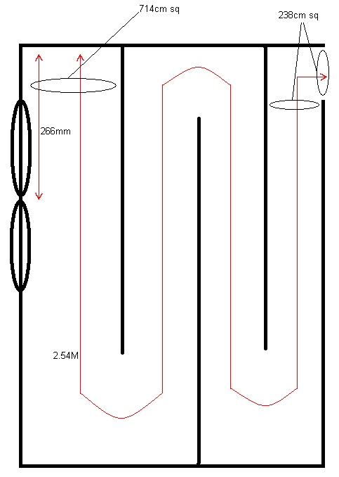

I've very roughly drawn what I think is what Scottmoose specified, I expect i'm way off the mark though
. The response down to mid 20's is good enough I reckon, my speakers (602's) are down 3db at 49Hz, so its a fair bit extra extension 🙂
I always thought MDF was the better material. Clearly that isn't the case, is plywood as easy to use (it doesn't split apart easily?). I don't see there being too much resonance in either material with a folded line however.

Dr.Em: What you have drawn looks good. You might want to position the drivers away from the start of your line, as in reverse the placement of your dividers.

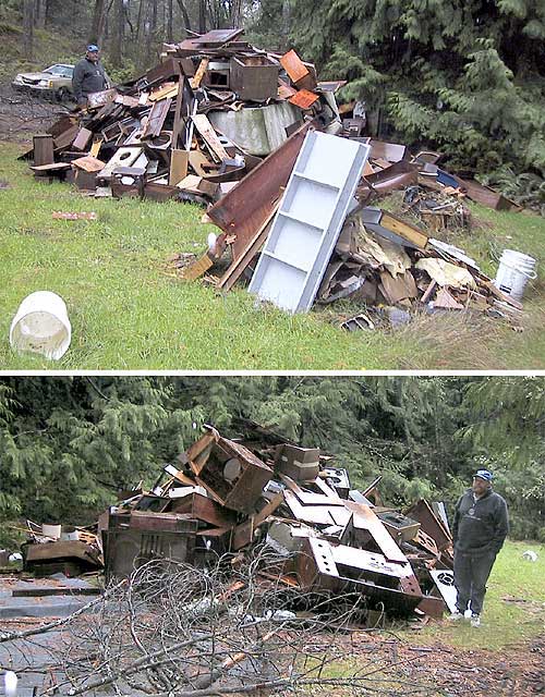

I have taken a break from burning all of my inferior quality speakers to write this. Another thing about MDF is that it doesn't burn well.
MJL21193 said:Another thing about MDF is that it doesn't burn well.
Actually if you get the fire hot enuff it burns just fine -- even when it has been in the rain for months...
we burn a pile something like this 2x a year... mostly speaker boxes
dave
dave
I vouch for this 🙂

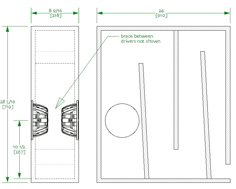

Thanks for that design Planet10. I'm still probably going to do the PMC type driver arrangement (I don't doubt the push push arrangement is better but i'm too set on the original designs appearance 😱) , but I noticed something on your design which I had thought about. That is the slanting of the panels. This reduces standing waves? I will definately try to do that, however I don't have a way to cut the wood ends so that they fit flush with the other boards (that probably made no sense so I attached an image).

Also, in the design Scottmoose layed out is the TL length critical to the drivers? Could I extend it to achieve further extension or will it not function properly then?

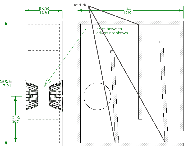

Dr.EM: Those angled baffles can have a straight cut on the end, with the gap (which will be small) filled with a sealant such as silicone. For a five degree angle, the gap would be less than 1 mm.

MJL21193 said:you also have a sideline in waste management🙂
My sense of not throwing stuff in the trash is sometimes a burden... steel gets picked up by a fellow down the road... he fills his dead cars with it before sendng them to the crusher (and gets an extra 420 or so a ton). Plastics go to a local place that makes plastic "timber" aluminum & copper i save for myself -- the price has gone up enuff that it actually generates some spending money. I'm patiently waiting for the PCB recycler (can't have all that gold & copper go to wast not to mention having the real toxic stuff get into the environemt. The burden comes in separating an item into its recyclable bits.

Dr.EM said:but I noticed something on your design which I had thought about. That is the slanting of the panels. This reduces standing waves?
The slanting of the panels is what give you the 3:1 taper in the design. This improves the low pass function of the TL and allows it to be shorter (and therefore smaller) at the same time.
No you cannot willy nilly change the design without changing its performance.
Going to dual front loaded drivers may fit your asthetic better, but will noticably decrease the downward dynamic range of the speaker. But you have to live with it, so the set of compromises you chooe are your own.
