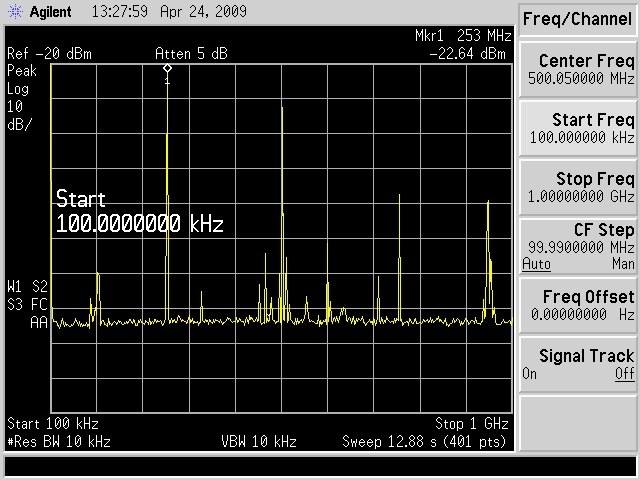

It is worse with active devices. You may send 10A current to BC547 and the model is still happy. It will only say "hot". It will not blow as a real part. The simulator would not warn you in case of parasitic 250MHz oscillations in a preamp, as seen below:

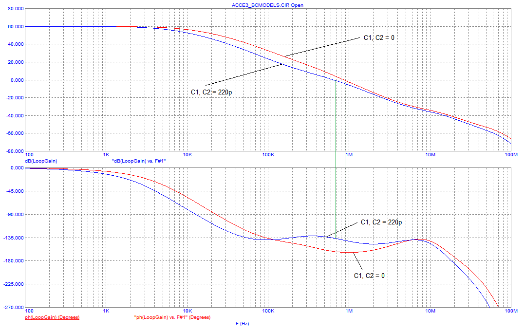

I am wondering about C1 and C2. I've seen this before, but haven't quite understood how this works. Assuming the PSU is low impedance, would it not be the same if they where connected to gnd then?

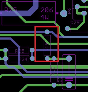

R18????
Originally there was no C22 and R18 was in series with R19. After tests of the prototype, C22 was added in parallel with R19 and R18 was shorted by wire jumper. The PCB was no more modified then.

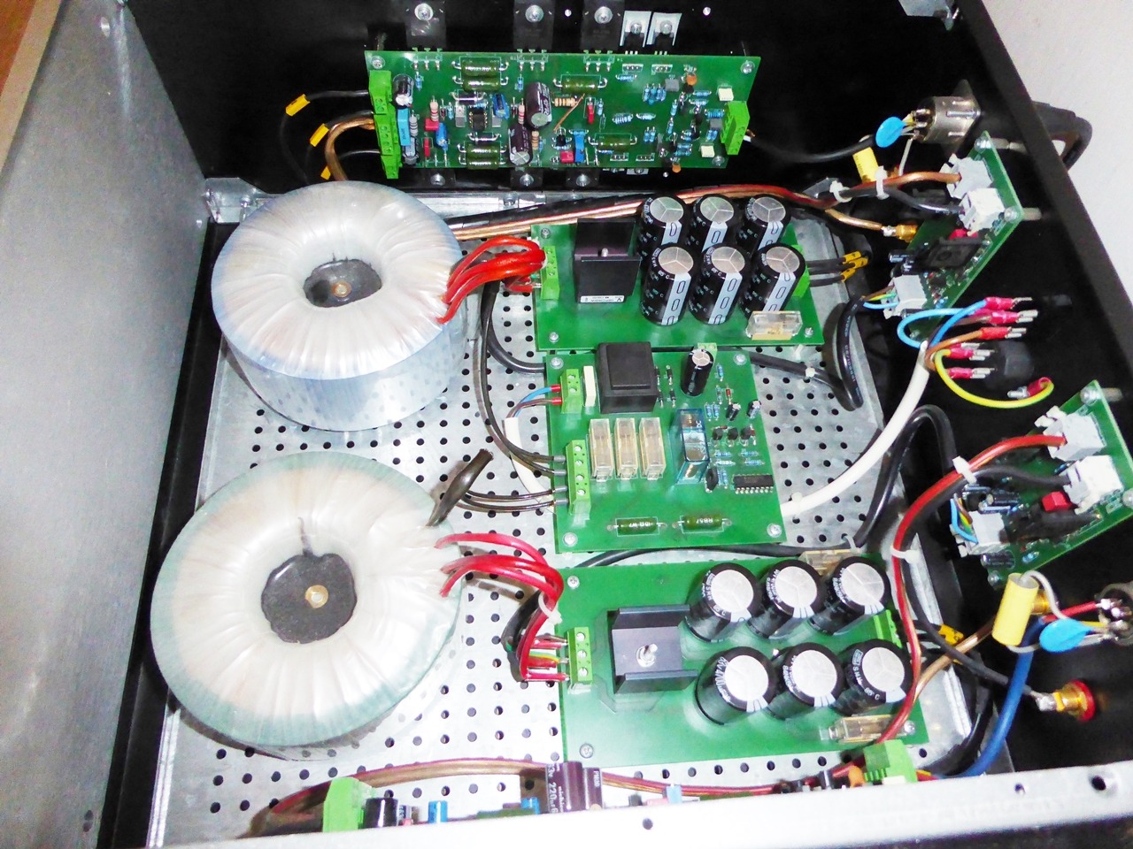

I have been using external modules.
It has proven to be a good decision, because my older high power amplifiers (2 x 200W/4R, 2x330R/4R) used 30A relays as protective devices, and these relays have been the only parts that deteriorated during about 10 years of frequent operation. In 2017-18, I have switched the protective devices to SSR MOSFET relays, as can be seen in the photo. Same size of the small protecting boards, so they could have been replaced without the necessary repair of the amplifier main board. The main PCB (as posted in #1) was designed in 2016 taking into account the probability failure of the protecting mechanical relay, so it does not have them included in the main board. Same approach was used with the PA4 2x330W/4R amplifier.

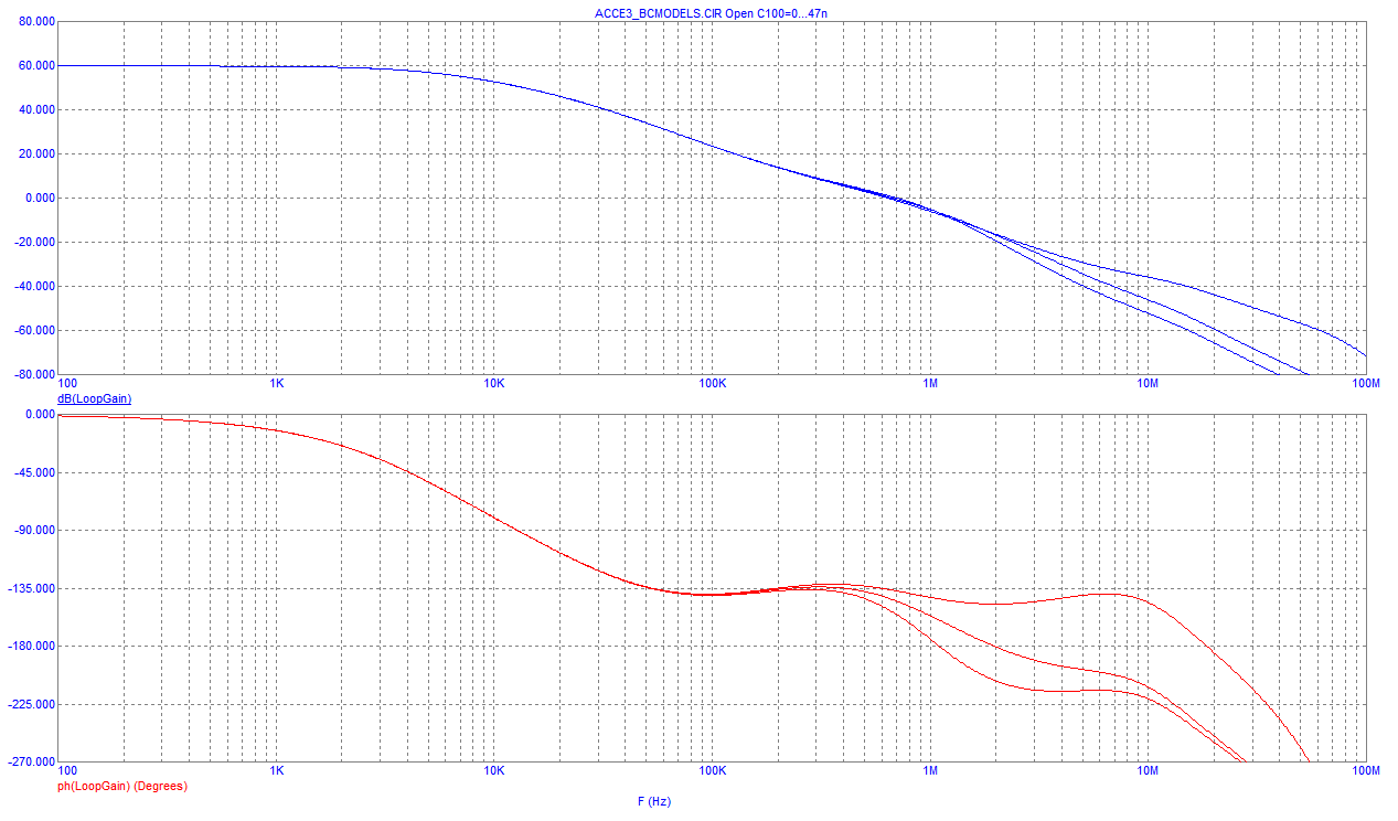

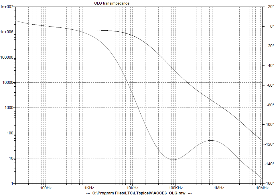

It is a CFA and thus compensation circuits are not automatically same as for VFA amplifiers. It is the transimpedance that is important and also value of the feedback resistor (R35//R24; 1k)) that creates a natural pole, please read documents at links in post #1.

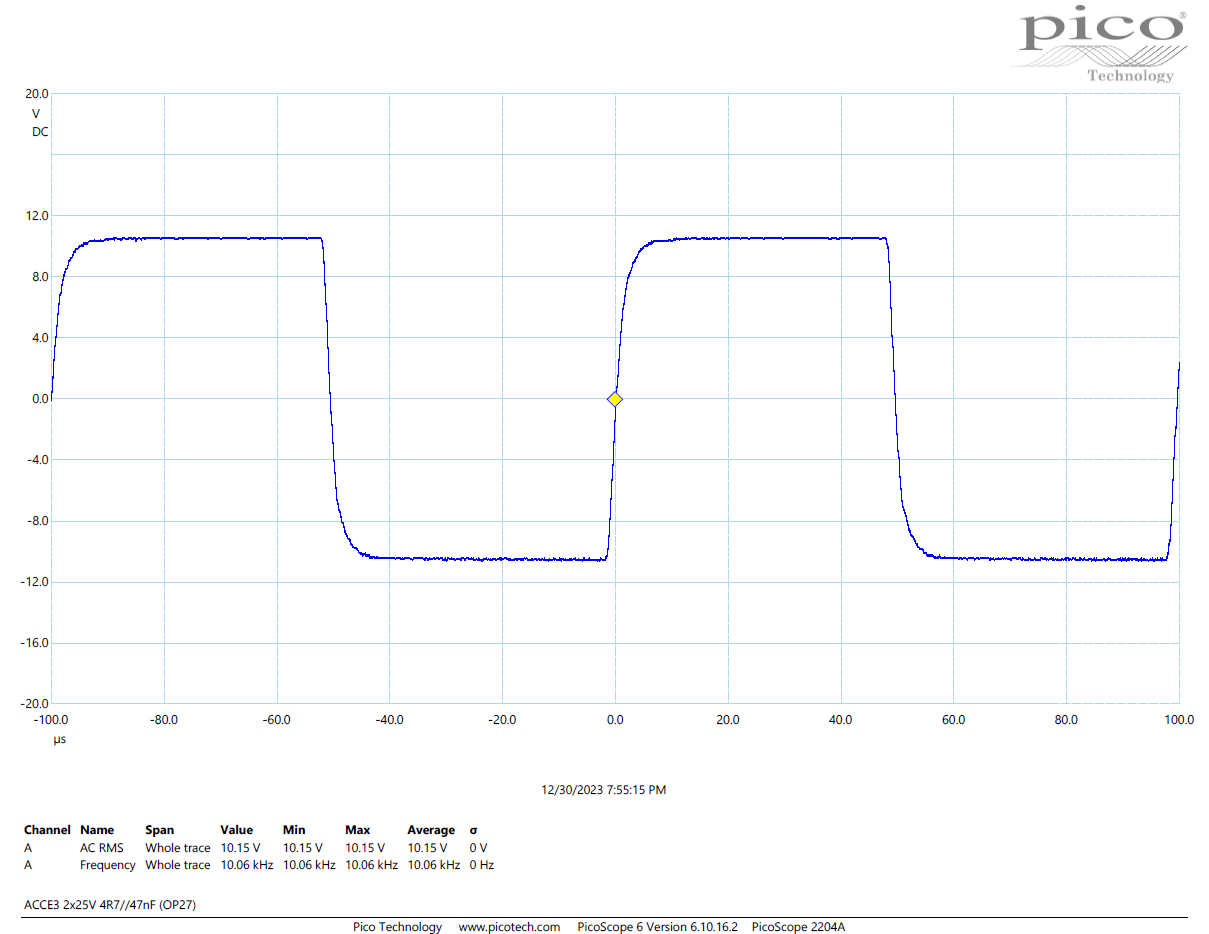

simulated transimpedance
simulated loopgain with capacitive load up to 47nF
These are simulations only, so only informative value. For high capacitive load, I suggested to use 1uH//6R8 behind the amp output terminals.
Please see effect of C1 and C2 on amplifier stability:
