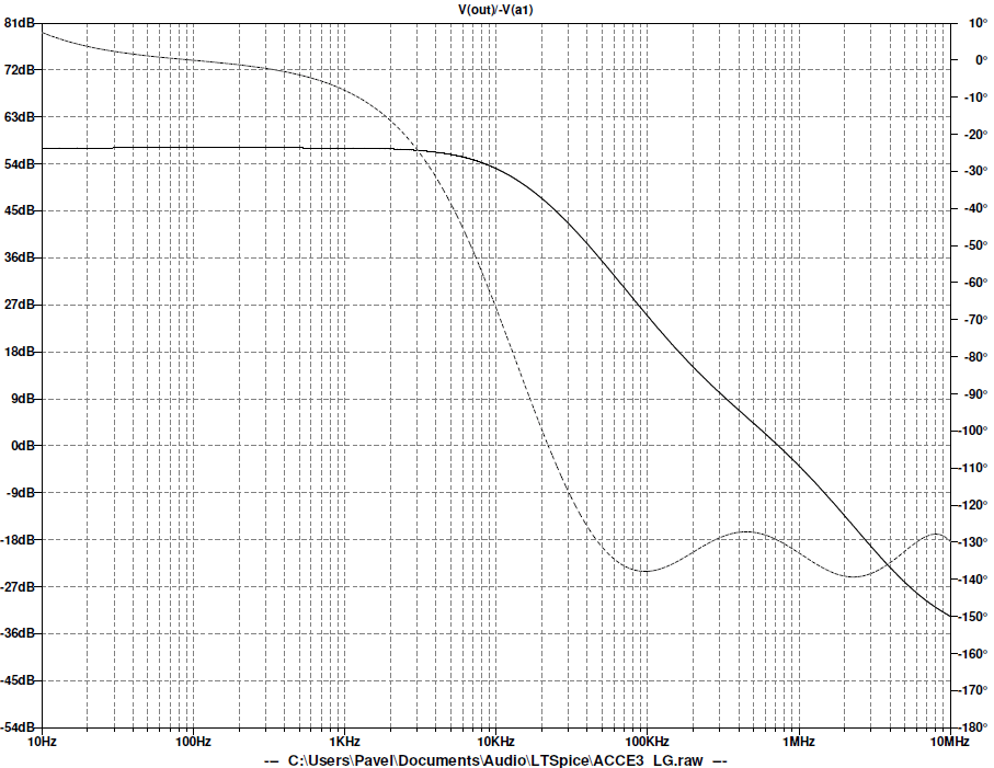

Regarding C1 and C2, as already explained by @EdGr , they shift OLG pole and modify slope of OLG response. It is a shunt compensation to VAS.
OLG with C1, C2 = 0pF
OLG with C1, C2 = 220pF
I am sorry I am not able to give any better or more clear explanation. The loopgain in post #38 covered it.

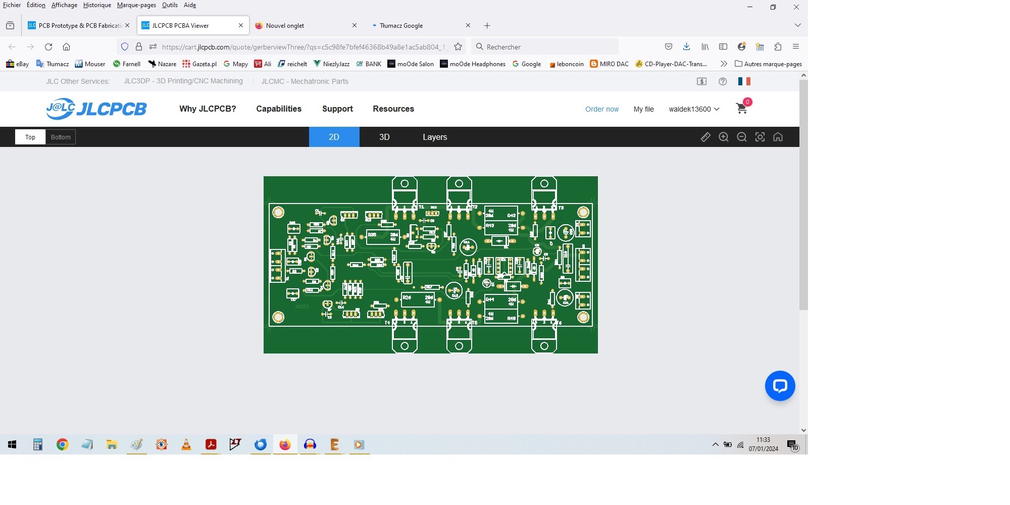

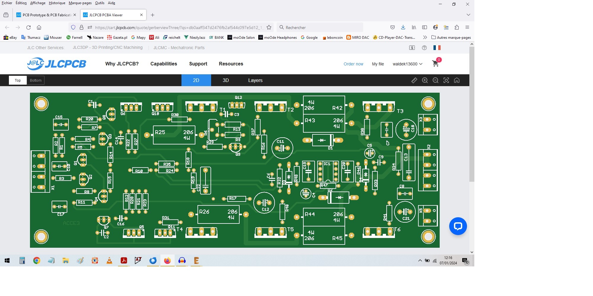

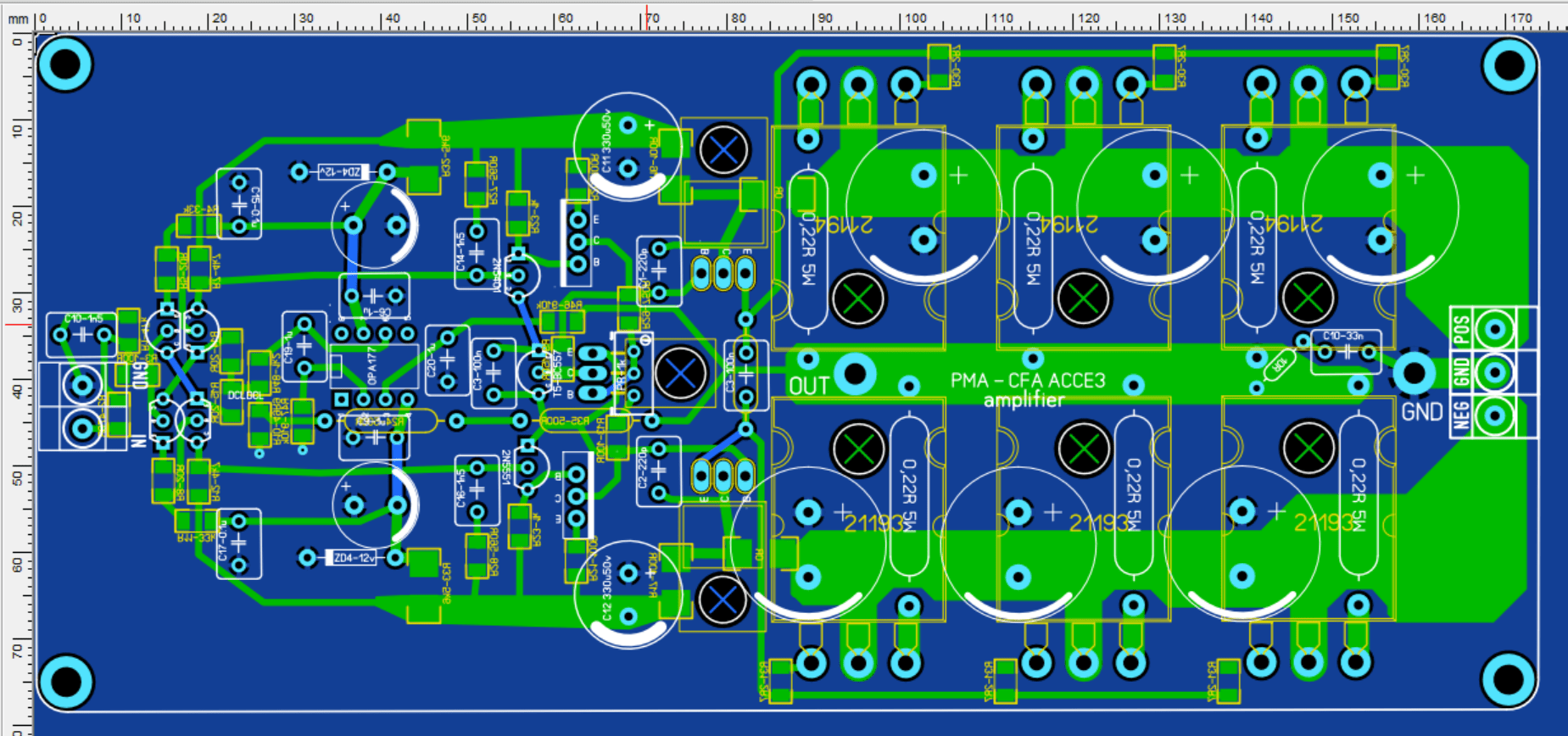

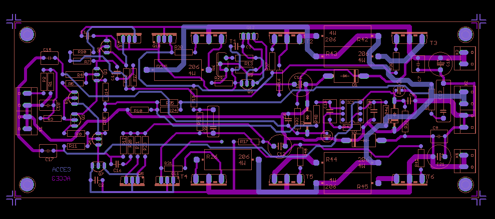

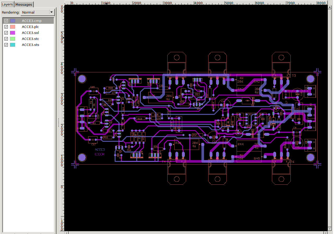

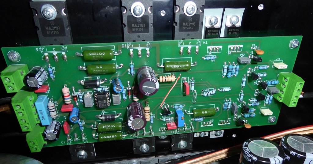

@Astaro thank you for the gerbers, great layout, however see the screen shot of render (underside), it looks like the mask is covering the solder pads. It does not look like the first image you posted?
Also R16 & R17 appear to be in the way of the driver transistors to lie flat if you get me...
It's in the archive not in gerber format, but *.Laythank you for the gerbers
Either this viewer misunderstood the format so badly, or you forgot about the layer with the solder pad when making gerberit looks like the mask is covering the solder pads
so the resistors are soldered on the board, and the board is connected through 6-8 mm brass posts to the radiator. That is, there is still a couple of mm distance between the transistor and the resistor.Also R16 & R17 appear to be in the way of the driver transistors to lie flat if you get me...
The transistors on this side should be on the radiator. The board is also parallel to the radiator on brass pillars

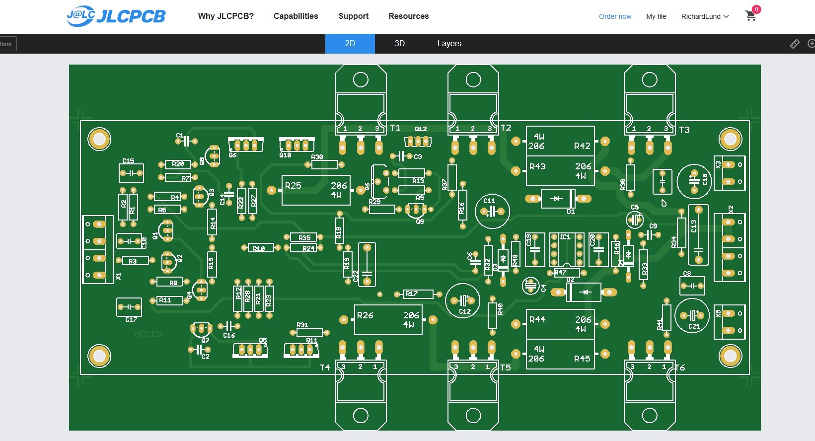

Astro, in post #53 you published your 'Gerbers' for us to use. So the board cannot be used as is?
Forgive my ignorance but which software do I ned to fix the connection issue? I just want a working PCB Gerber for JLPCB. Their gerber viewer works just fine.
Got it regarding component spacing and pillars 😉
