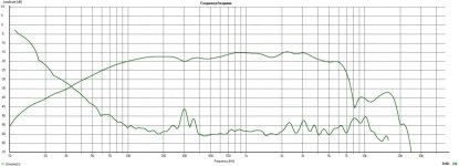

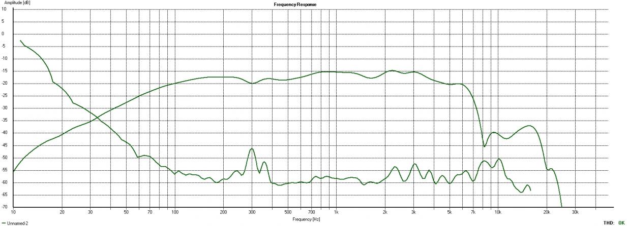

I added 2x, 1m/1W measurements of the same driver.
One from someone that used the "exemplary smooth and extended" behavior in they're marketing. Noticing the 300hz anomaly as a measurements artefact more or less.
And the same measured by someone testing drivers for his own use.
Until you overlay the graphs and mess with the scaling one would maybe not think it is the same driver even.
just a little example.
That driver is loved by many and not a bad 10", but again notice how scaling and smoothing can make you show what is beneficial for your application, for anyone that is not looking too closely.

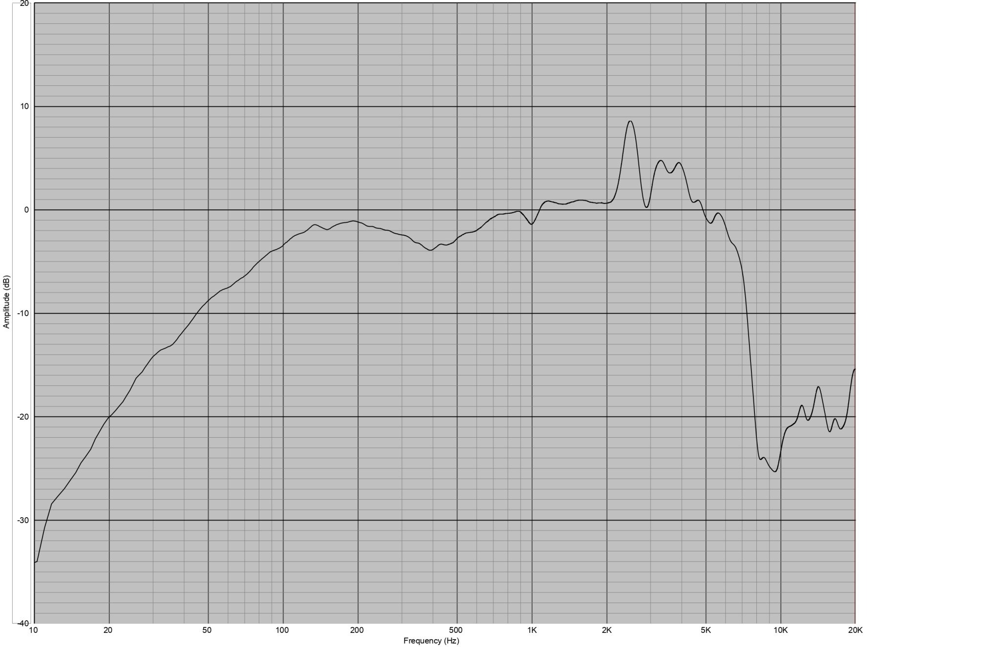

Taking some time today, I measured my drivers as a reality check. They don’t have the 1.8kHz ringing mode in GR-Research's video. Nor do any that I have ever measured. Nor do my tweeters have the tall peak at 3kHz or fall off at 12kHz.
The resonance GR shows in that video at 1.8kHz corresponds to the diameter of the midrange's magnetic gap when using the equation 13542/pi/diameter in inches. There is a foam insert behind the voice coil to dampen this cavity resonance and his customer's midrange requires a closer look to determine if something is amiss. Having done my due diligence, I measured many of these midranges and never found a peak in that region, nor found any third-party measurements that recreate what is in GR's video. GR-Reseach's measurements showing poor performance are not representative of normal behavior for those drivers.
Additionally, the speakers I bought don't have the 4kHz dip that Troels Gravesen focused on. In the Yamaha NS-1000M Owner’s Manual we find the speaker was recommended to be listened to at middle height. I investigated by measuring and it can be seen in the impulse response that the tweeter and mid are impulse coincident at that height. You're seeing it first here.
The relevance here is the acoustic slope between the mid and tweeter was an approximate 4th order Butterworth Squared/Linkwitz-Riley, which is often used in time aligned (but not linear phase) speakers; the forward offset of the midrange dome relative to the tweeter dome permits a time coincident impulse response around center baffle; and lastly, the first arrival rules, the impulse of the first driver we hear is perceived as the loudest.
Unsurprisingly, Yamaha was here first. The precise dip Troel's shows was also shown in the manual for the vertical off axis. I was able to cause the same dip shown in the Yamaha graphs and in Troels' graphs at 1 meter, having the calibrated mic at tweeter height. The conclusion is the 4kHz dip that Troels shows was in fact caused by his measuring height. As his crossover was designed using measurements taken at the tweeter level, it implies that his crossover compensated for a response and phase deviation that never existed when the speaker was used at recommended listener ear height. I also noticed his T&S parameters don't match his plotted bass alignment response.
I will leave you with some quick measurements taken in my room with lots of reflections. Does this "need" a crossover upgrade? Well, the stock NS-1000M power response was good enough in fact that Floyd Tool chose it as an example, though I cannot recall which book/page but there was also a photo of it. I know what Harold Callahan would say.
On axis in room at 2.5 meters:
Impulse response near center of baffle. Time-aligned tweeter-midrange. Woofer appears later at 1.55ms and is more visible in step response.
Contains room reflections at 2ms onward (mic was on a chair).
Midrange and tweeter:

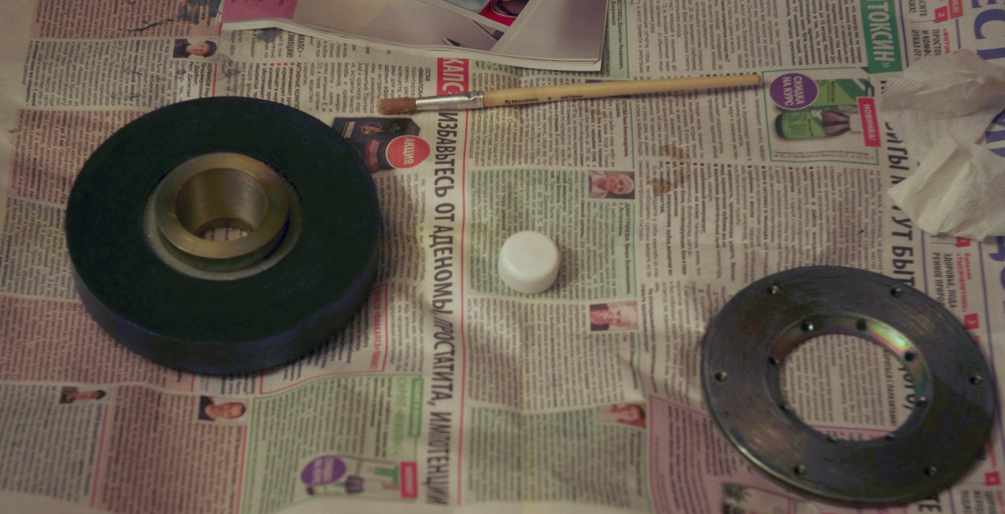

Finally found two mid driver is cracked not woofer problems. How can I fix this ?
It coil is already burn ?
Best regard
Vox.
I have not tried what you suggest but are other parts on the mid dome able to take that temperature for that time? Just another option (a room temp one) Could one use the thin smear of epoxy (as you suggested) over a carbon fibre tissue? Model shops sell it, and two or three layers could be built up with one thin coat of epoxy used to impregnate all of them at one time.
Maybe do a test first on an egg used as a mould (or some such thing) with some grease to act as a mould release agent.

Found problem is not only coil or beryllium. Magnet not stick with glue and coil is gap of .Everything was destroyed because the workers blamed it.
Now try to fix with epoxy glue .

The only part of a driver which is somewhat heat sensitive is polyrethane damper inside the motor, and it takes 150 deg C easily - just tested with a digitally controlled heat gun to be extra sure. Support surround when baking - put something under it or place entire moving system on a suitably sized teacup so that it sits on a surround, not on VC or dome - otherwise surround may sag. Or suspend it on a string using binder clip.Vox.
PS.
They are available second hand.
https://www.ebay.co.uk/sch/i.html?_...a+NS-1000M+beryllium+midrange+driver&_sacat=0
Never tried carbon fibre in this application, but I guess it could work. Make sure epoxy resin penetrates the crack. Heating the dome to ~50 C helps, as does additg some (1..5%) acetone. Add acetone to the resin itself before mixing with hardener. Use regular non-thinned mix for second layer.
If repairs are made from inside the dome, original appearance of the driver can be completely preserved. Yamaha glue dissolves easily with acetone or methyletylketone or ethylacetate. Xylene should work too.
Beryllium toxicity is wastly overhyped for some reason. Metal or its oxide (beryllium ceramic) are completely safe; it's thin airborne particulates that are REALLY harmful, or dust which makes skin contact. So don't weld, grind or laser cut etc. berillium without due precautions; other methods are no more dangerous than handling aluminium.
Typical problem. Clean magnet and top plate thoroughly, remove corrosion and old glue residuals, prepare aluminium or bronze shims to ensure magnetic gap is really concentric, glue with phenolic glue or epoxy. Epoxy is harder to fix if mistakes are made, so take special care.Magnet not stick with glue and coil is gap of
