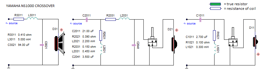

Your post is well intentioned, but the OP’s wallet will just end up $800 lighter if he follows any of the claims in that video, or any other "upgrades" for this speaker found online charging money. Clickbait videos like this only serve the purpose of advertising and I will go on record to call it the audiophile equivalent of a tourist trap.
From the start, GR-Research calls the inductors “steel core inductors”, and the differentiation here is they are soft iron, not steel. An engineer and speaker design knows the difference, but a hobbiest-turned-salesman does not. He also seems to struggle with any challenging drivers. I wouldn't place my faith in someone like that. I anticipated his attempt to cross the tweeters over lower, and sure enough he was aiming for 2 or 3kHz. The salient problem is the JA-0513 was susceptible to broken tinsel leads, even with it's 6kHz crossover point. The wire in the voice coils is like that in earphones. Lowering the crossover to 4kHz, as GR-Research has done, may contribute to a premature failure. When a commenter took him to task over the price (and pointed out DSP could be cheaper), GR responded with “DSP has a lot of bottlenecks.” He uses “poly bypass caps”, yet his kit doesn’t even include the essential backplate. Apparently "caps" are more important.
TL;DR - The whole video was an audiophile grift pushing an $800 crossover, but we don’t find that out until the end.

I hope the OP will forgive me for filling a page here, but being objective-minded I hope to show why upgrades are sometimes a bad idea.
The sincerely wish is that NS-1000M owners will give pause before buying an "upgrade" kit.
Taking some time today, I measured my drivers as a reality check. They don’t have the 1.8kHz ringing mode in GR-Research's video. Nor do any that I have ever measured. Nor do my tweeters have the tall peak at 3kHz or fall off at 12kHz.
The resonance GR shows in that video at 1.8kHz corresponds to the diameter of the midrange's magnetic gap when using the equation 13542/pi/diameter in inches. There is a foam insert behind the voice coil to dampen this cavity resonance and his customer's midrange requires a closer look to determine if something is amiss. Having done my due diligence, I measured many of these midranges and never found a peak in that region, nor found any third-party measurements that recreate what is in GR's video. GR-Reseach's measurements showing poor performance are not representative of normal behavior for those drivers.
Additionally, the speakers I bought don't have the 4kHz dip that Troels Gravesen focused on. In the Yamaha NS-1000M Owner’s Manual we find the speaker was recommended to be listened to at middle height. I investigated by measuring and it can be seen in the impulse response that the tweeter and mid are impulse coincident at that height. You're seeing it first here.
The relevance here is the acoustic slope between the mid and tweeter was an approximate 4th order Butterworth Squared/Linkwitz-Riley, which is often used in time aligned (but not linear phase) speakers; the forward offset of the midrange dome relative to the tweeter dome permits a time coincident impulse response around center baffle; and lastly, the first arrival rules, the impulse of the first driver we hear is perceived as the loudest.
Unsurprisingly, Yamaha was here first. The precise dip Troel's shows was also shown in the manual for the vertical off axis. I was able to cause the same dip shown in the Yamaha graphs and in Troels' graphs at 1 meter, having the calibrated mic at tweeter height. The conclusion is the 4kHz dip that Troels shows was in fact caused by his measuring height. As his crossover was designed using measurements taken at the tweeter level, it implies that his crossover compensated for a response and phase deviation that never existed when the speaker was used at recommended listener ear height. I also noticed his T&S parameters don't match his plotted bass alignment response.

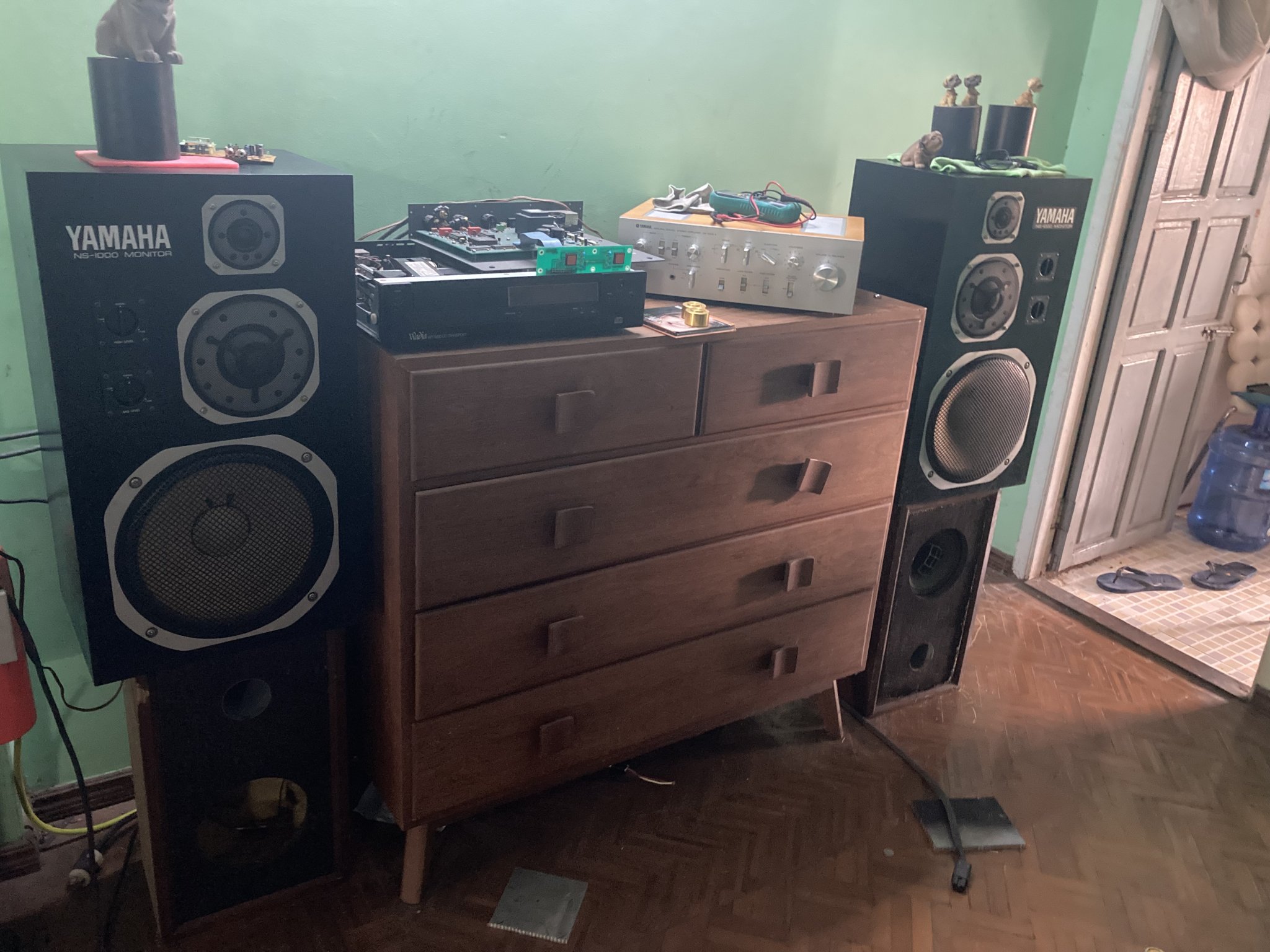

Finally found two mid driver is cracked not woofer problems. How can I fix this ?
It coil is already burn ?
Best regard
Surprisngly, such cracks - I assume they are small, as they don't show on photos, - once glued and sealed, have little to no consequences in midrange, where the driver is used. Phenolic glues (apply, let dry, cook at 120-140 deg. C for 1-2 hour) are most suitable for metallic diaphragms. Can be substituted with epoxy if pheolic is unabtainable. Use thin aluminium foil as backing, preferably anodised/oxidized, but regular cooking foil works too.

The only part of a driver which is somewhat heat sensitive is polyrethane damper inside the motor, and it takes 150 deg C easily - just tested with a digitally controlled heat gun to be extra sure. Support surround when baking - put something under it or place entire moving system on a suitably sized teacup so that it sits on a surround, not on VC or dome - otherwise surround may sag. Or suspend it on a string using binder clip.
Never tried carbon fibre in this application, but I guess it could work. Make sure epoxy resin penetrates the crack. Heating the dome to ~50 C helps, as does additg some (1..5%) acetone. Add acetone to the resin itself before mixing with hardener. Use regular non-thinned mix for second layer.
If repairs are made from inside the dome, original appearance of the driver can be completely preserved. Yamaha glue dissolves easily with acetone or methyletylketone or ethylacetate. Xylene should work too.
Beryllium toxicity is wastly overhyped for some reason. Metal or its oxide (beryllium ceramic) are completely safe; it's thin airborne particulates that are REALLY harmful, or dust which makes skin contact. So don't weld, grind or laser cut etc. berillium without due precautions; other methods are no more dangerous than handling aluminium.
Magnet not stick with glue and coil is gap of
Typical problem. Clean magnet and top plate thoroughly, remove corrosion and old glue residuals, prepare aluminium or bronze shims to ensure magnetic gap is really concentric, glue with phenolic glue or epoxy. Epoxy is harder to fix if mistakes are made, so take special care.
