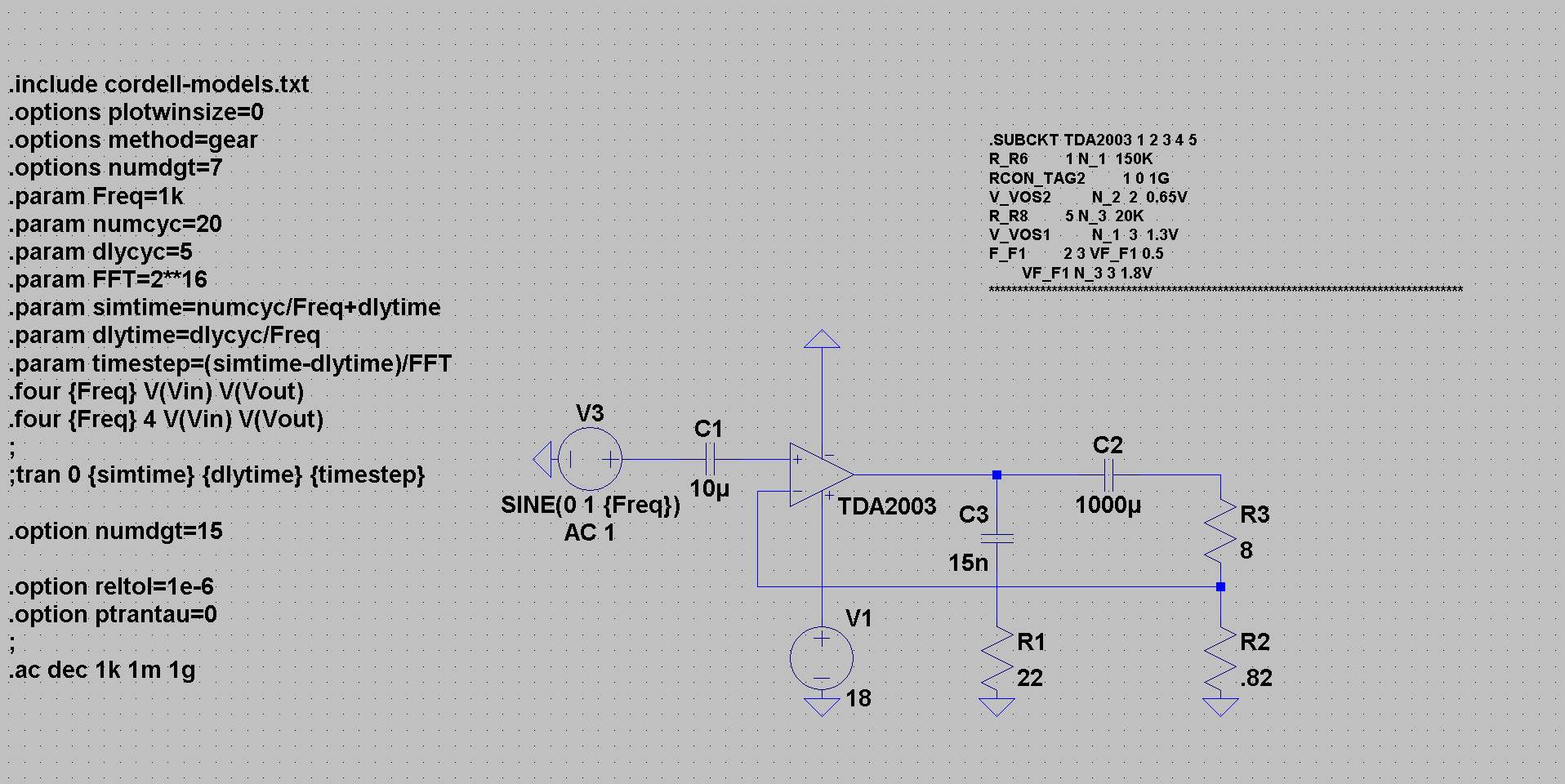

pls help tp simulate transcond TDA2003 amp
continued...
to opamp1 from ltspice I connected the name TDA2003, maybe the connection the model to circuit needs more operations?
thank you

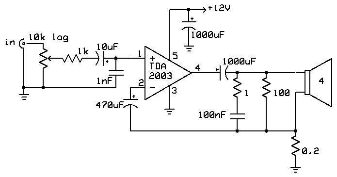

but the connection I drove is good, it is take after an output cap, and please remember, this is transconductance amp so its connections are different than application note.
bellow corrected spice directives...
  • tda2003 transconductance.asc
Administrator
Joined 2007
I think DUG is correct, you have a direct ground conection to the inverting input. It doesn't mater that the output is AC coupled, the input pin is still ground referenced.
(your .asc file wont run on a default LT installation. There are unknown models and subcircuits being called up that aren't included in your file)
please advise
