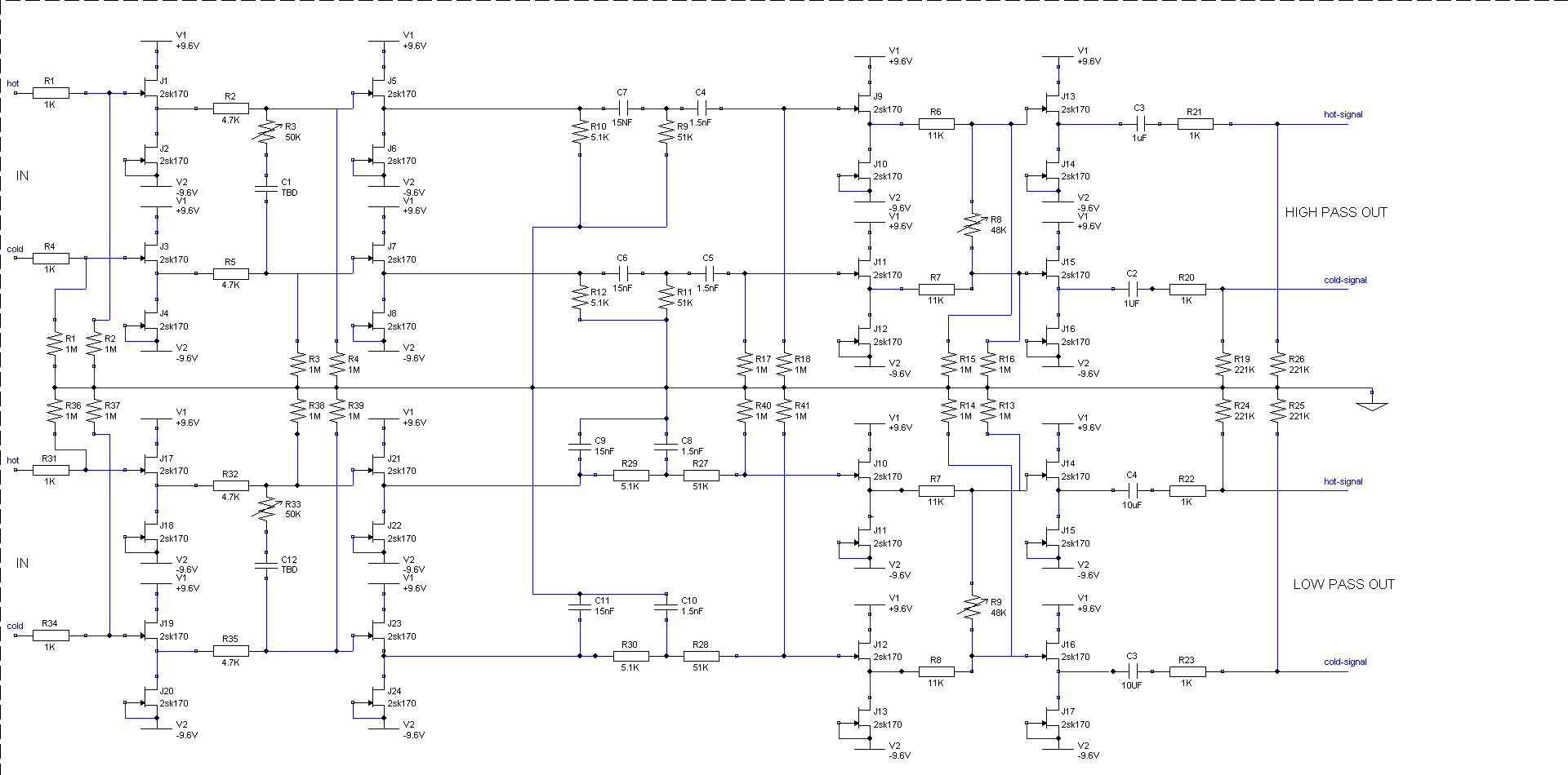

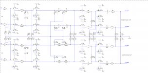

I use a PLLXO prototype for some time now and very happy with the results. To overcome the impedance issues i put everything between Nelson Pass B1 buffers:
High Pass
- Input --> B1 Buffer --> 1st order HP --> 2nd order HP (switchable) --> B1 Buffer --> volume control --> B1 Buffer --> out
Same for low pass. I wass just designing a PCB for the final version for pcbexpress. It also incorperates a shelving filter for Baffle Step Compensation. The circuit is almost like below. But i have the Hp and LP the wrong way around.
By the way, the circuit below is for one channel balanced. This could also be a stereo single ended crossover, but then pot need shunt to ground.
High Pass

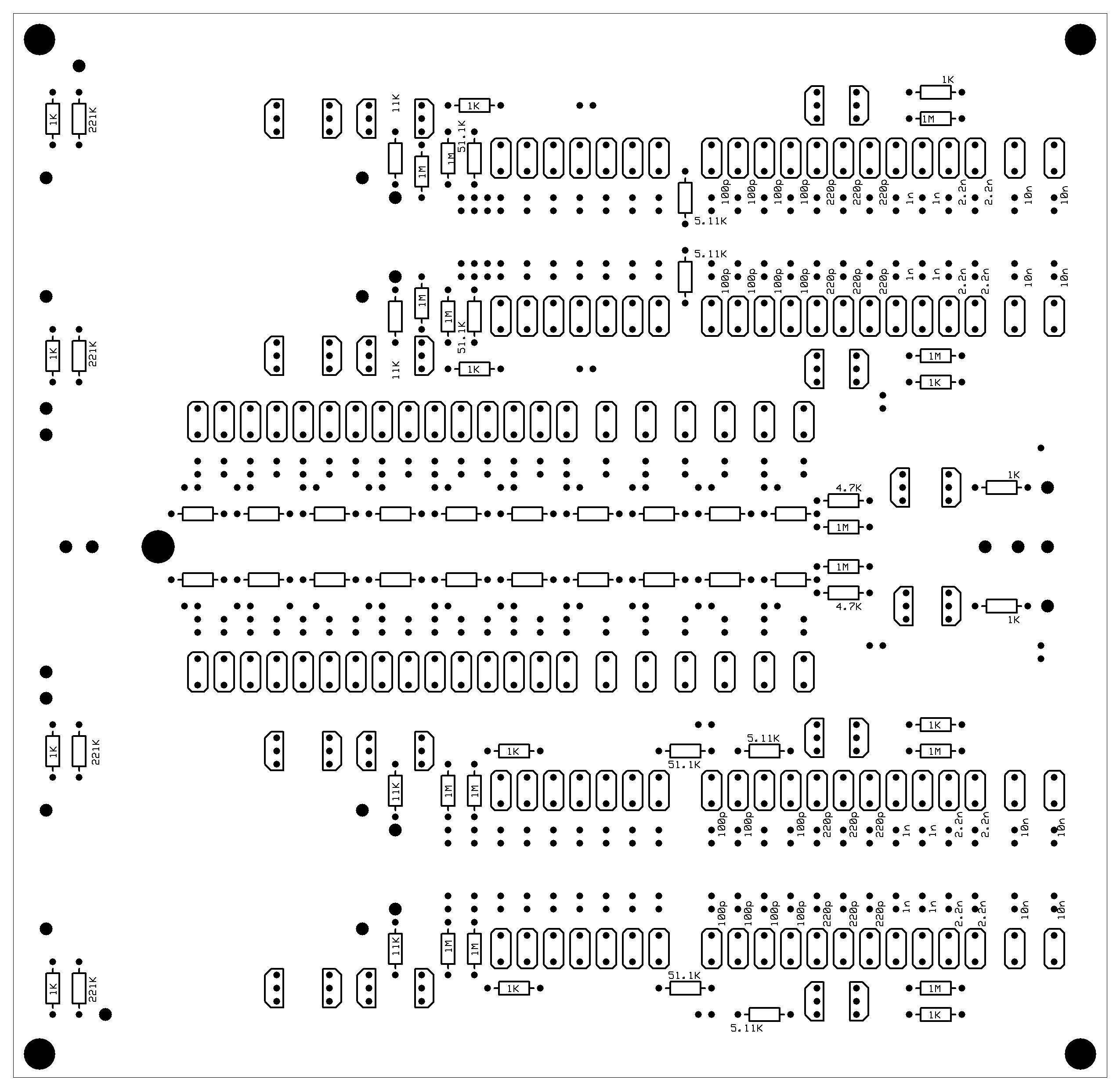

That is what i did, i used discrete buffers (Pass Labs B1 buffers) in the following configuration
Input --> B1 Buffer --> BSC --> Hp 1st order PLLXO --> HP 2nd order PLLXO--> B1 Buffer --> HP volume control --> B1 Buffer --> output
same for LP. I received my PCB for my setup today. I will post some pictures of these soon.
